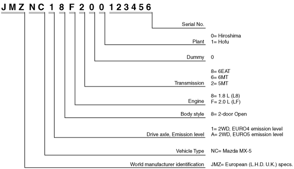

If your VIN is JMZNC1… it’s a Euro 4 emission level, if it’s JMZNCA… then it’s Euro 5.

My Vin is JMZNC1
2009 Mk 3.5
Engine number LF

Sorry, I can’t comment on the V5C information, I was going off the VIN chart from the workshop manual.
Well my car is defo a Mk 3.5 facelift 2009 and the VIN says it must be Euro 4 going by that chart…
