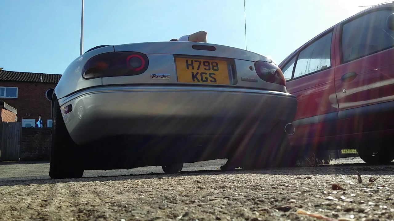

I fitted a cobalt system and 421 manifold to my 91 took me about an hour to swap both and thanks to eBay I paid less than 100 quid there’s a little video below to give you an idea of what it sounds like
Out of interest what does the Mongoose sound like and can I conclude then that there is a genuine performance benefit?
Did you fit this one yourself and if so how long did it take?

Sorry I copied the wrong link I think try this one http://s42.photobucket.com/user/gandolfstwin/media/Mobile%20Uploads/20160213_105540_zpsrjyws952.mp4.html
