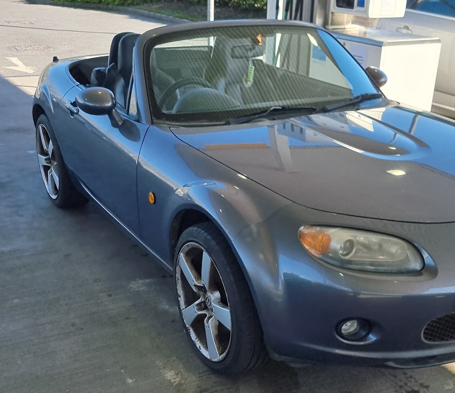

Im interested in other people’s experiences fitting 18" wheels to their NC.
I had RX8 wheels on my NC with 225/35 tyres. The tyres were only £55 each. It did feel like it was wearing steel toecap boots because the alloys are much heavier.
Switching back to the standard 17" wheels with good tyres, £90 each, the level of grip and cornering speeds are so much lower. I’m getting undsteer where there was none with the bigger wheels. It feels much less planted and more skittish.
Does this match other’s experience?
Any recommendations for light and cheap new or second hand 18" wheels?

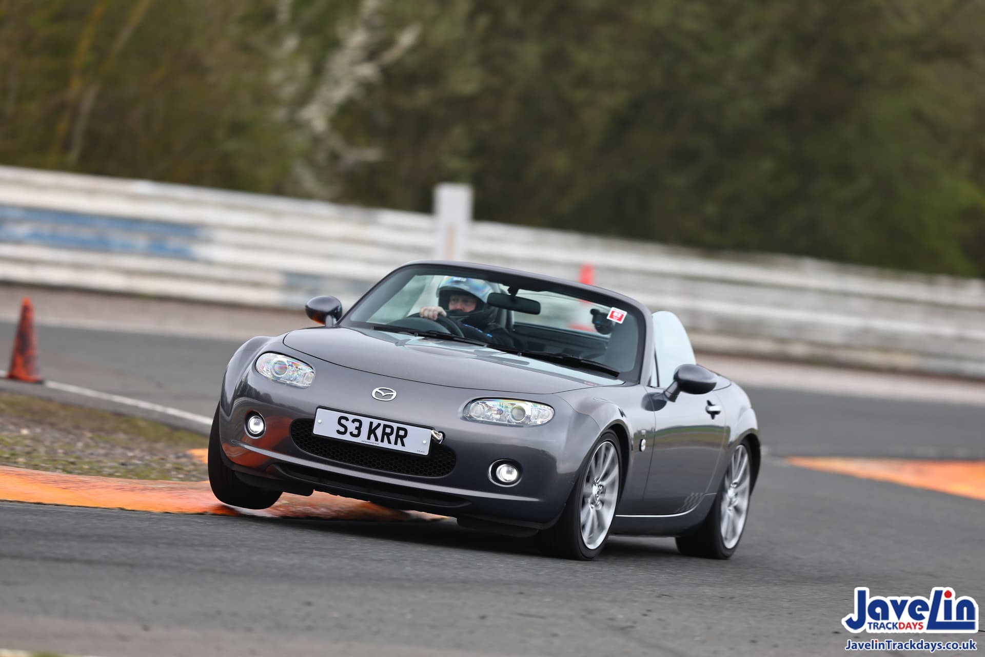

Not sure when you have been experiencing understeer , Road or track … but I would guess that like been mentioned tire choice and suspension setup and alignment to be the biggest factor that could be masked by bigger rubber . Never experienced under steer on my road MX-5 even on track and even on 3 wheels . The stock 17” sport wheels are 7.7kg and are hard to beat without spending lots of money and in the pic I am running 205s ….

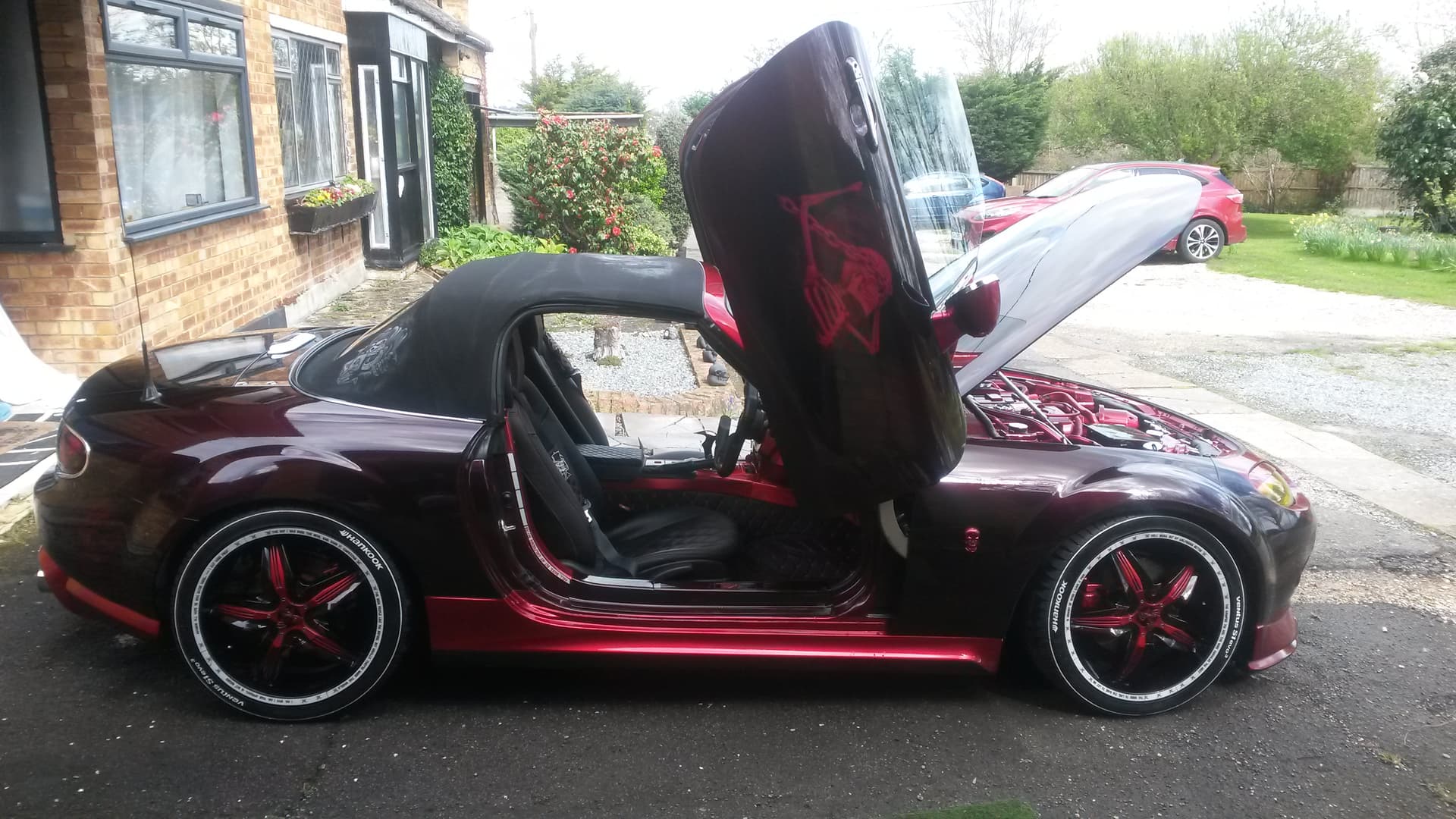

I’ve run on 18" wheels since 2013. Lowered suspension, road race set up, very hard driving and have been more than happy with the handling. I only did it for looks but not disappointed.
Those scissor doors look so good, where did you get the hinges
Flying Miata in the USA. that was 16 years ago
