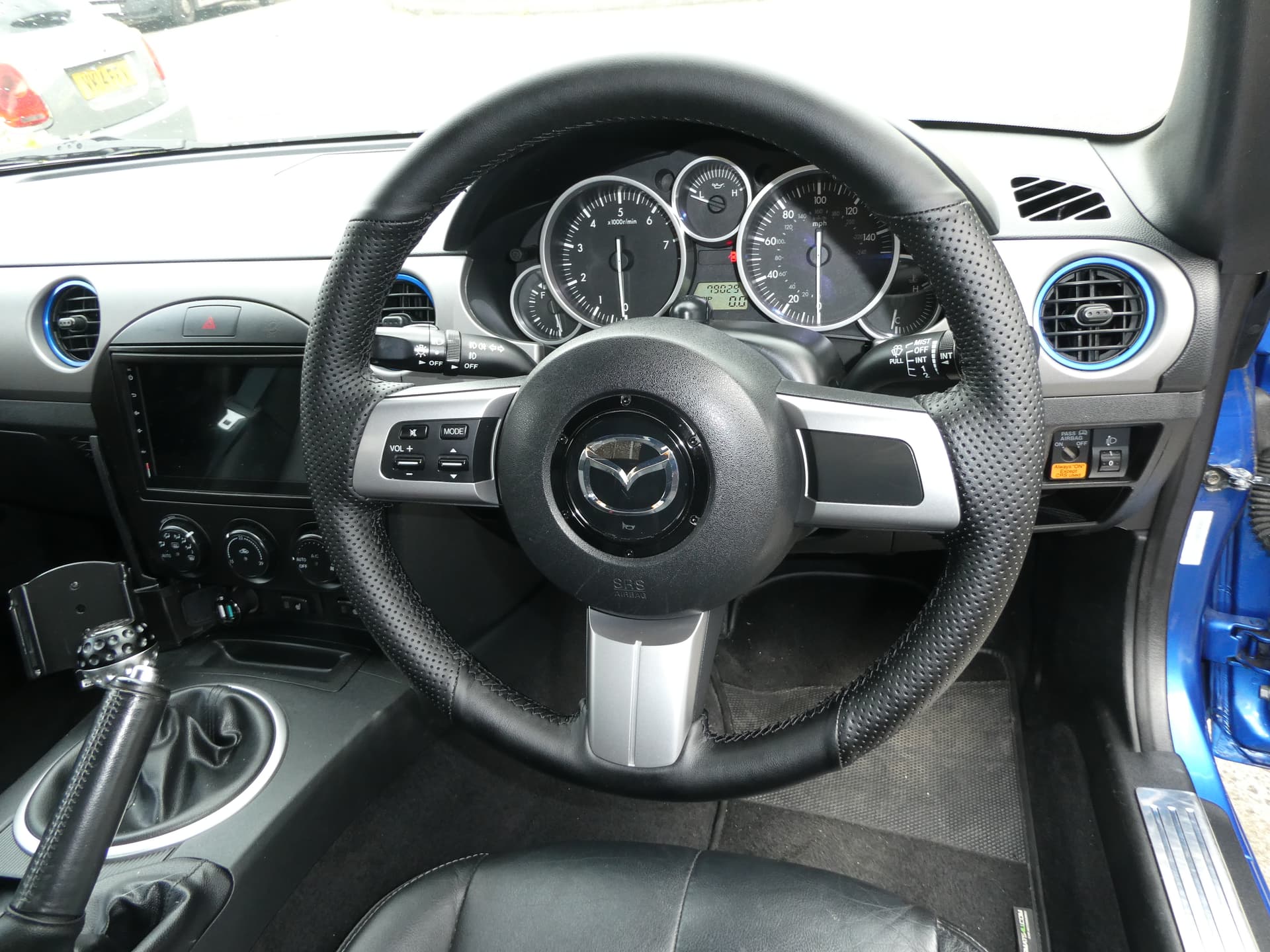

I took a risk on a £20 steering wheel cover kit.
Looks and feels great fitted - does not increase thickness much - it is about 1mm thick.

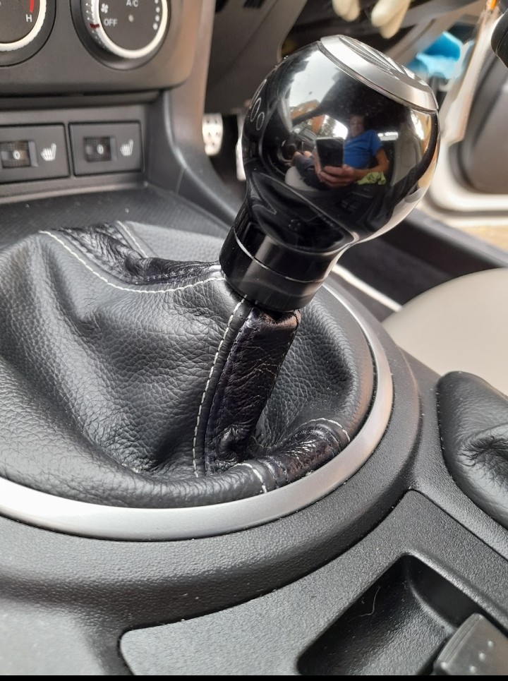

I also went with an alloy golf ball gear knob.

Don’t be put off by the price ( has gone down since I bought it ) - it is a nice shaped cover.
Some covers are not shaped and won’t fit around the spokes of the wheel.
Thanks for the link. My wheel is starting to show its age and I was wondering what to do about it. That seems to fit really nicely.

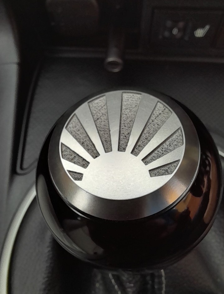

I’ve seen some spherical knobs not sure if they’re made ftom resin or wood. Appreciate you wanting to keep it oem but, it can also offer an opportunity to personalise ‘your car’ I fitted this…
Polished with a yellow microfibre cloth before photo taken me thinks :thinking:
Haha, it’s always clean…I carry a detailing kit in the glove box…often get strange looks in a car park :wink:
Just ordered the ND version for mine, as the leathers a little too shiny at the moment for me :+1:
Im well impressed with that steering wheel cover, would you mind letting me know where you purchased it?

You have done a very neat job with that :+1:
