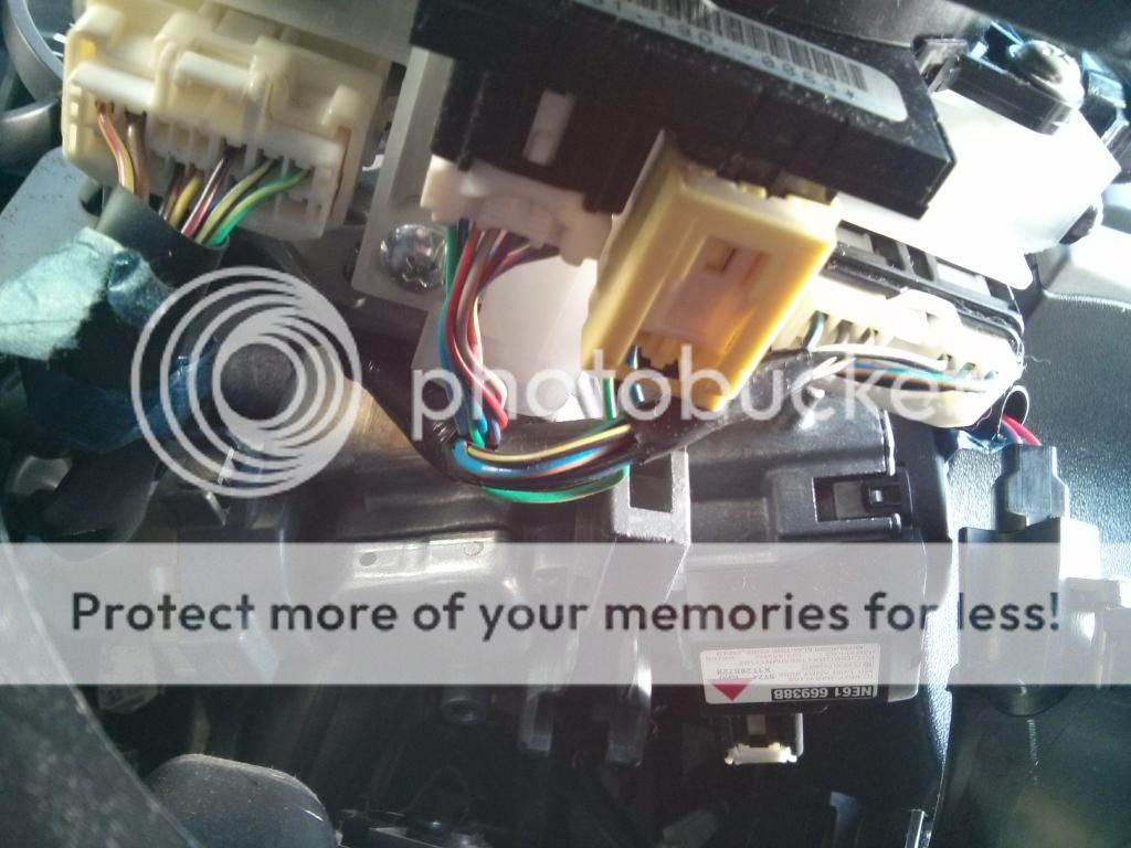

Longer answer - I was doing some work on the car today (swapping the wiper stalk for an RX8 stalk), so I took a couple of photos.
^^ This photo was taken from under the steering wheel.  Hanging down on the right is the bottom steering column cover.  To the left of it is the ignition key barrel.  There are 4 connectors.  From left to right, they are (I assume): inidicator stalk, wheel controls, airbag & wiper stalk.   This is from a Mk3.5 Sport, so the “wheel controls” includes both Radio/Bluetooth and Cruise Control.

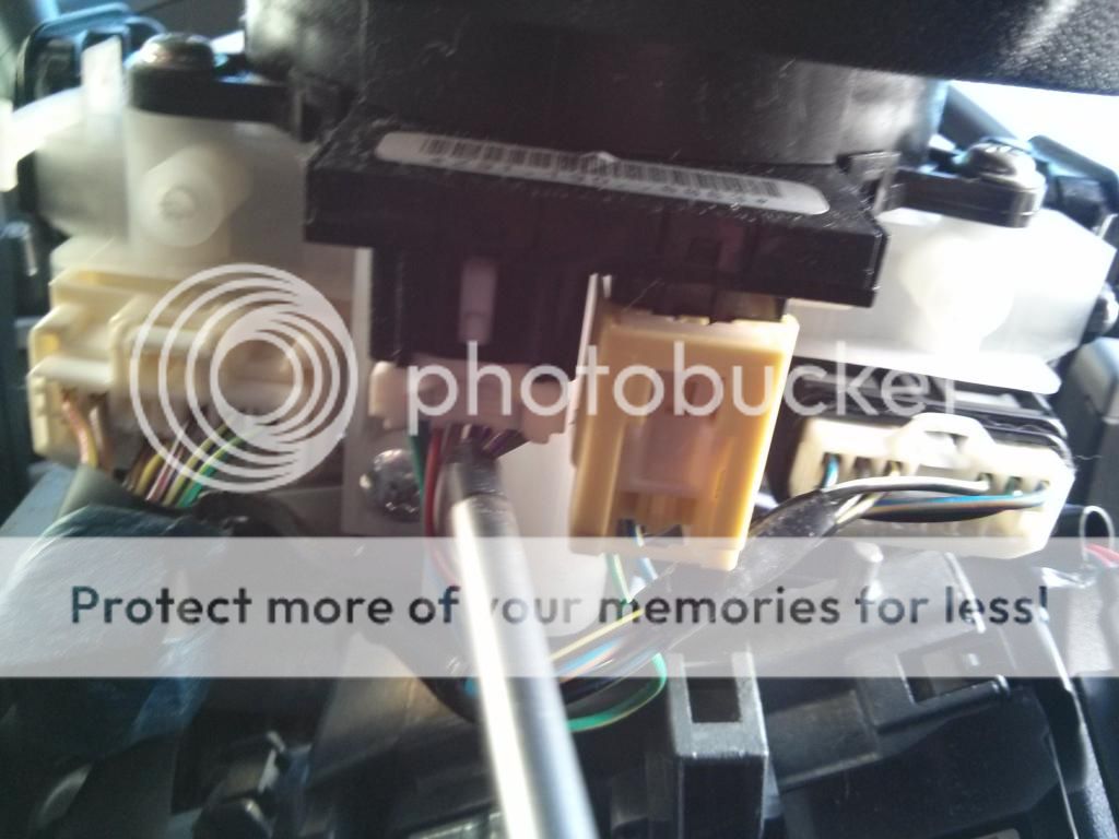

^^I’ve put a screwdriver onto the steering wheel controls connector.  It goes into the clockspring, which you can’t see in that photo.
What I suggest that you do is to remove the steering column cover and take a peek underneath.  If you know how to do it, it’ll take 5 minutes.  If you don’t, then:  remove the 2 nearest screws from underneath the column.  Pop the top half of the column cover off.  Then remove the third screw.  Pop the bottom half off.  Note: the bottom-half screw is different to the top-half screw.  If you’ve pulled a Mk1 apart then you’ll find it very familar.
 NOTE: some of this is guesswork, based on quick observation, and the fact that all of the SRS/airbag connectors that I;ve seen on MX-5s are yellow.
