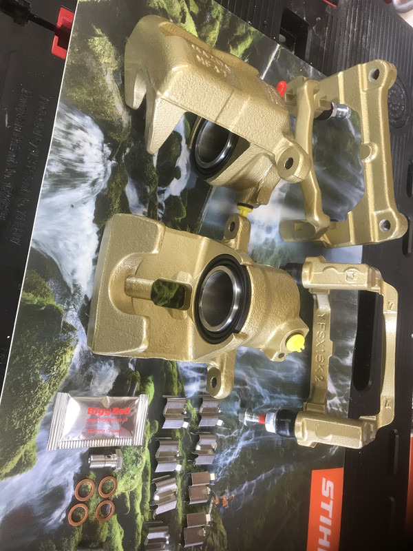

Well the callipers are now with Bigg Red in Worcester for a complete rebuild…
BR. offer a Premium service which is a total strip then shot blasted and painted a colour of your choice The lacquered. . They then fit new pistons seals clips bolts in fact every last part. . New slide pins rubbers are also included
It costs just under £200 for the pair of front callipers inc VAT. Very reasonable considering the options ???

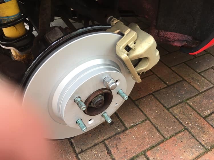

I went Gold. I had recently painted the calipers when I fitted new discs and pads all round. This was nothing to do with the sticky caliper by the way the blame for that was the previous owner using nasty corrosive brake cleaner. This buggerd the piston surface then I of course push those pistons back in to accommodate the new thicker pads.
This is how they looked.
Bigg red offer two shades of Gold. Subaru gold which is in your face. Or a shade that was a virtual match to what I used so I went with that. ??

Picked up the reconditioned callipers from Bigg Red in Worcester who did an excellent job. I opted for new banjos new clips and fitted new anti squeal shims. The premium package included new slide pins and rubbers.
