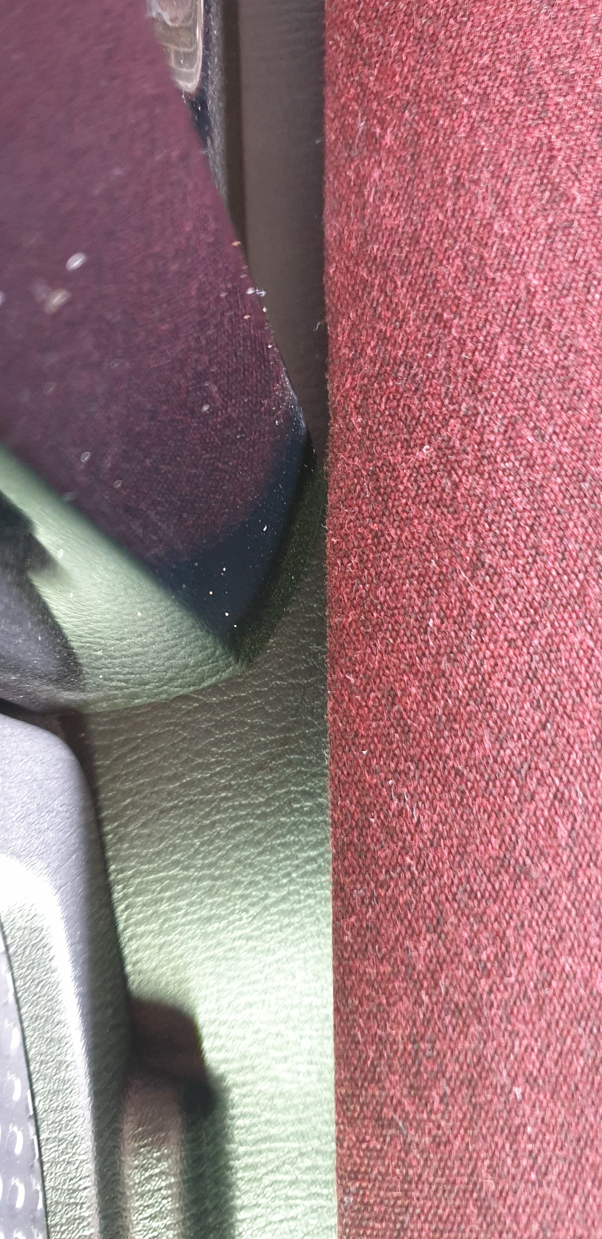

It has been catching as I can see two small indents on the roof. Clearly the previous owner didn’t notice it or care too much as the roof was filthy and needed a good clean. Did that today and its looking better, but will need another go before I try resealing it. Was the roof issue with the hoops a recall issue (I’m imagining not)? It’s an 18 plate so outside of warranty.

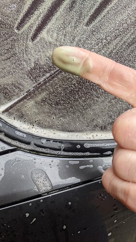

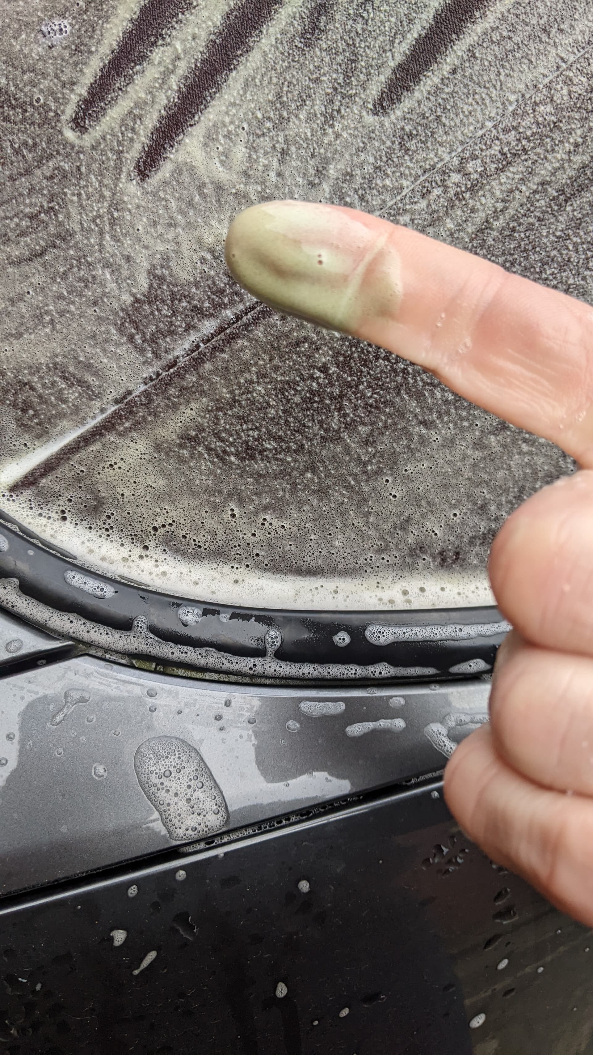

Not the cleanest
Wow thats some dirt!!
Out of curiosity, what do you use to clean it? I was told just general fabric cleaner such as Vanish spray will do it ok…
I used 100ml of Miltons, 100ml of baby bath and 100ml of all purpose cleaner with water as recommended on here :+1:
