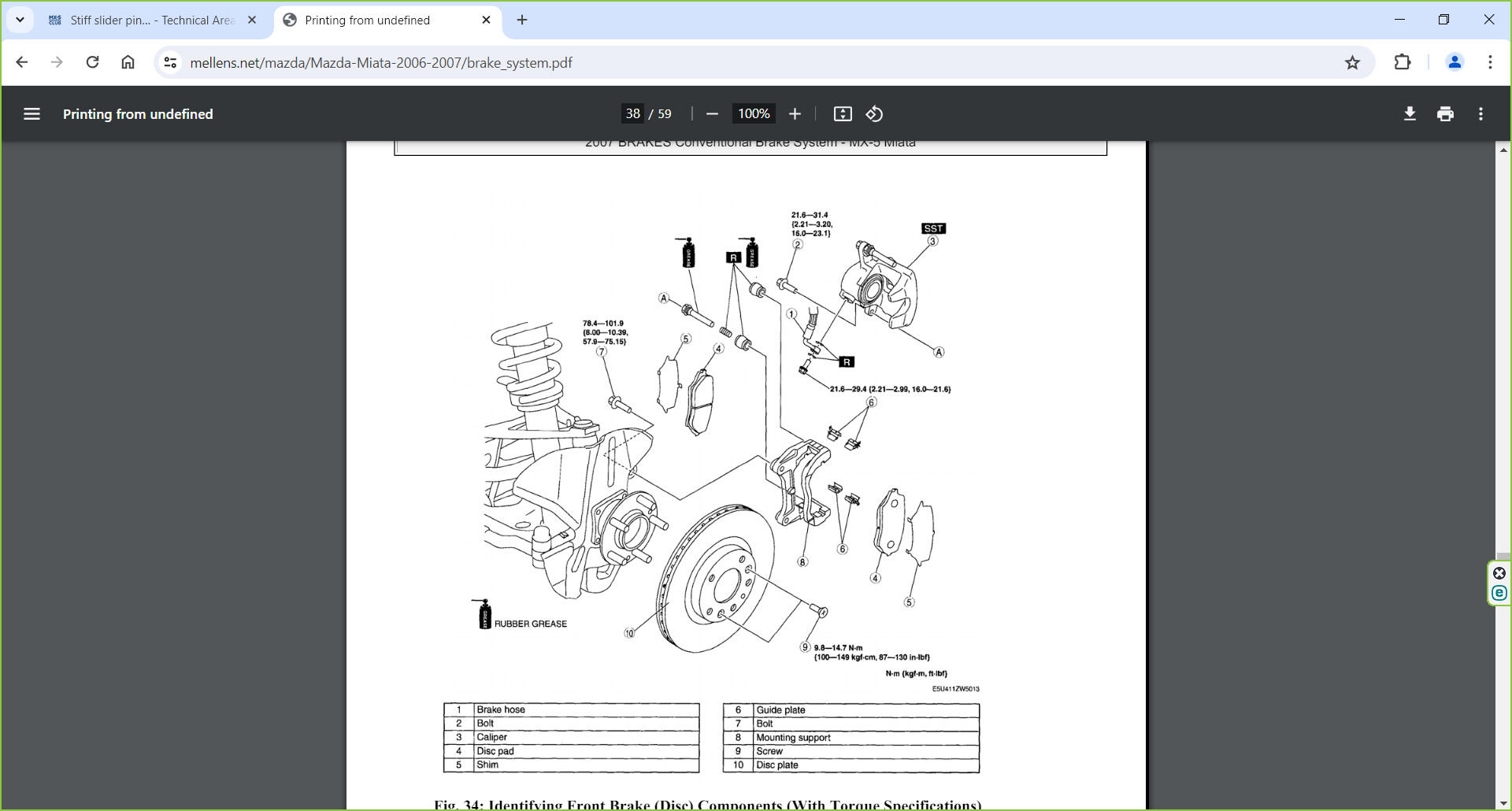

I can’t recall whether the bottom one is the one with the rubber sleeve. This one is definitely tougher to install.
The book says that the BOTTOM pin has the rubber sleeve on it
