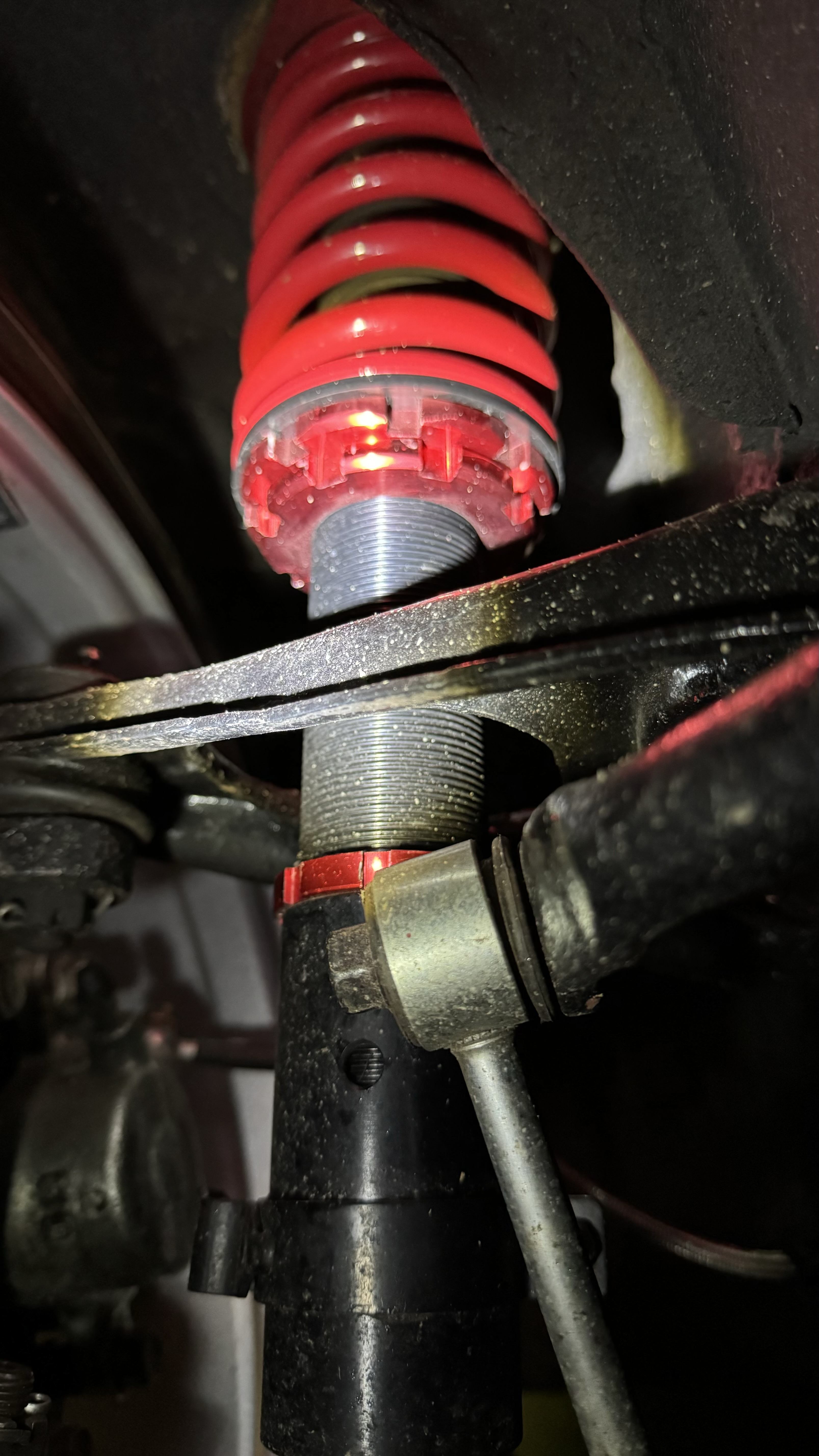

Our Eunos has some aftermarket coilovers fitted (unsure of the brand - first pic). They work fine with some F1 rims and uniroyal rain tyres (2nd pic)
However, I recently purchase some rims with track tyres that have a larger offset than the F1s (3rd pic). Fitting to the car there is serious tyre rub whenever we hit a bump. I’ve increased the height of the coilovers but still on larger bumps we get rub, which I’m thinking could be dangerous at high speed.
Question then - has anyone upgraded the springs on an existing aftermarket coilovers setup? I’m wondering if this would solve our problem (as the car won’t bounce so much). Would prefer to do this over ‘rolling the arches’ as we’d lose the classic look of the car.
Some pictures attached.

You’d be better off buying coilovers with adjustable damping and specc’ed springs. (Unless these are adjustable) youl find most setups the spring and shock are matched and adding stiffer springs to a damper will give an undamped ride feel and lots of horrid bounce.
The car doesn’t seem low enough to encounter tyre rub, those coils must be very soft? Are the wheels spaced away from the strut/ arch correctly etc? Lots of possibilities here!

I agree with what is said above, first step, what are the specs for wheels and tyres that didnt rub and what are the ones that do? It may be advisable to raise the coilovers again while you work this out (unless you dont use it much) and stiffen it up too . I wouldnt consider any other change to the coilovers such as changing the springs though myself.

Coilovers have the spring rates matched to the dampers. Adding stiffer springs may cause a mis-match.
