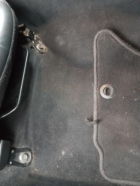

Stoopid newbie question about the MK3 single post to hold drivers mat
Where the hell is it??
Apologies if this is in the wrong part of the forum. And I’m almost embarrassed about asking this but my mat is all over the shop

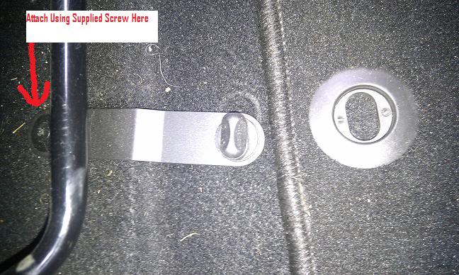

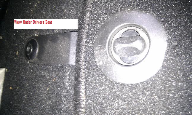

That is a standard MX5 mat as supplied by Mazda. There should be a bracket with a turn buckle fixed centrally in front of the seat that the hole in the mat locates with. I suspect yours has gone walkabout or it may be hiding under the seat.
This may help
https://i.postimg.cc/htbfGS6J/IMAG0161.jpg
https://i.postimg.cc/NMTF2mjx/IMAG0163.jpg
All good advice posted above  thing is, if you don’t ask you’ll never know, we were all newbies once. Often, these brackets get turned around under the seat and appear to not be there, have a rummage around to see if that’s happened. Failing that, new ones are available, easy to fit so go for it! Mats that move about and slide forward are potentially dangerous as they could affect pedal operation, you never know, you might even get more performance out of the car if the loud pedal can go right to the floor!  Only joking there
Thank you all, thank you Captain for the pic. Yep, my bracket has gone walkies in it’s 35000 miles. I wondered why that screw was under the seat like that?! Easy fix, thank you.

It looks like the original fixing would be pop rivetted to the seat frame.
I’ve had a look around and no sign of a replacement available new.
If you could find yours and in one piece, would be feasible to reattach or get one from a breaker.
Might be worth taking the one off the passenger side as a temporary fix.
Given oommon MK3 issues with clutch pedal, you do not want the carpet to get involved in that area.
