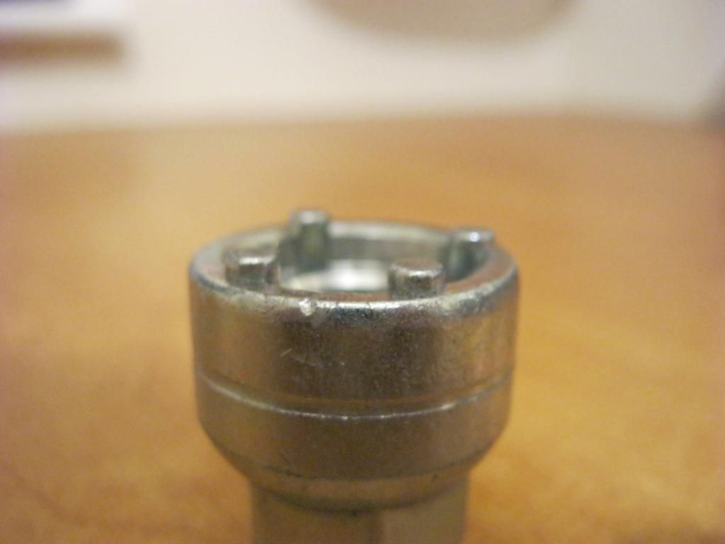

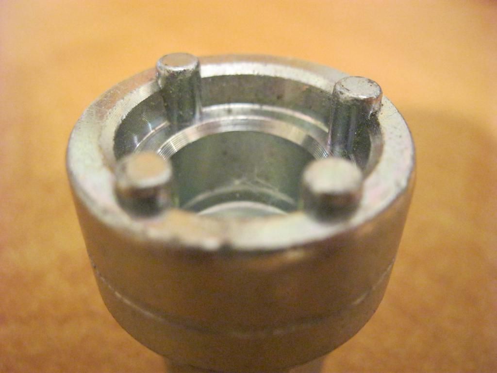

Its worth checking the locking socket as i’ve seen some of the posts get pushed into the socket so they dont make correct contact with the nut. The sockets are drilled to match the nut and then have posts pressed into the holes to make contact, they can often be pulled back out with a decent pair of pliers.
