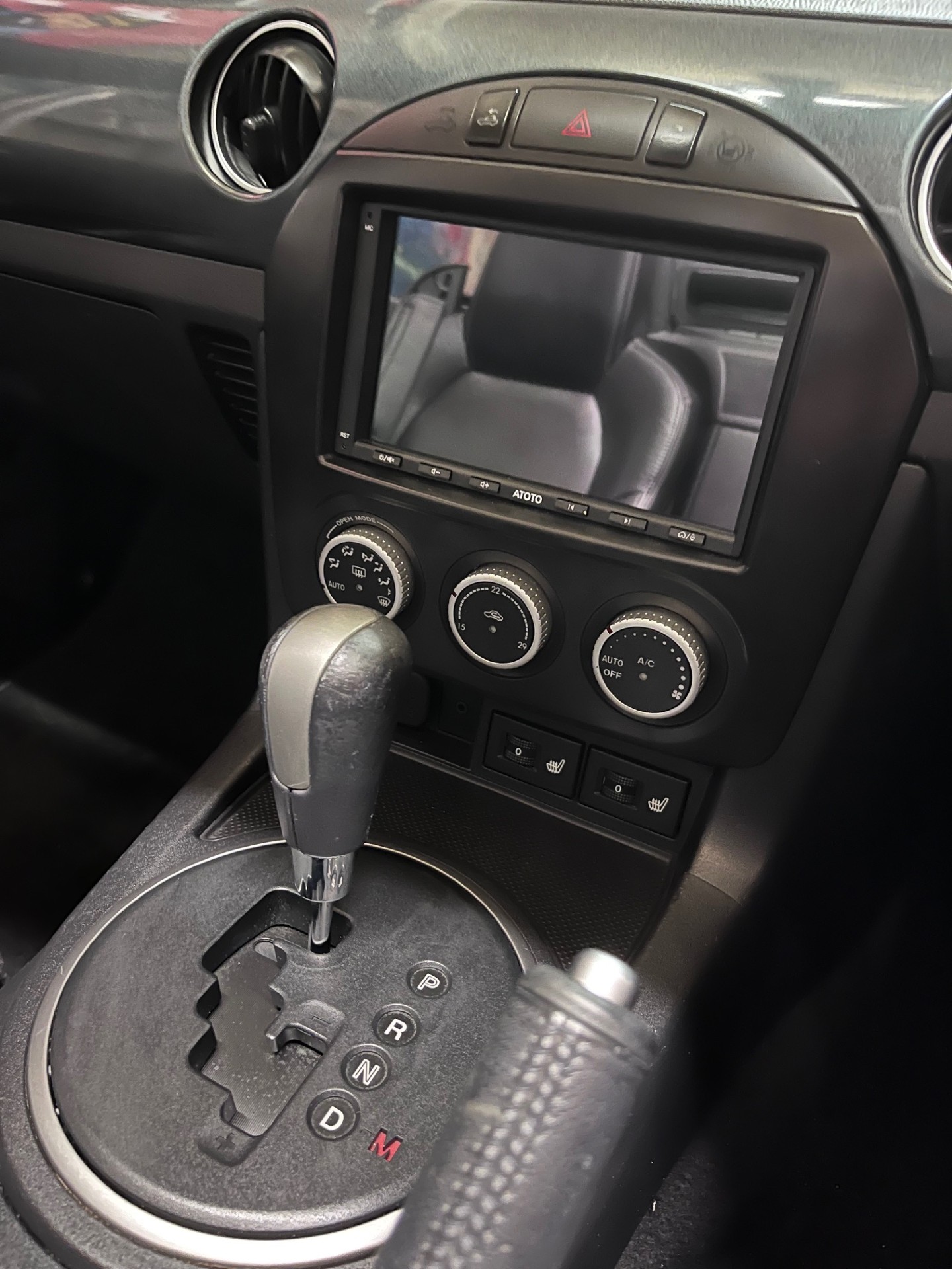

Successful installation Atoto A6
  1. My model of MX-5 is: NC 3.5
  2. I’m based near: Chelmsford
  3. I’m looking for technical help or recommendations on: Finally finished installing my new Atoto A6. Was fun as I didnt realise I had a Bose amp but I fitted the line out convertors and its now working a dream. Clever bit of kit and so easy to integrate into the MX-5. I found this video invaluable Atoto A6 Bose install
