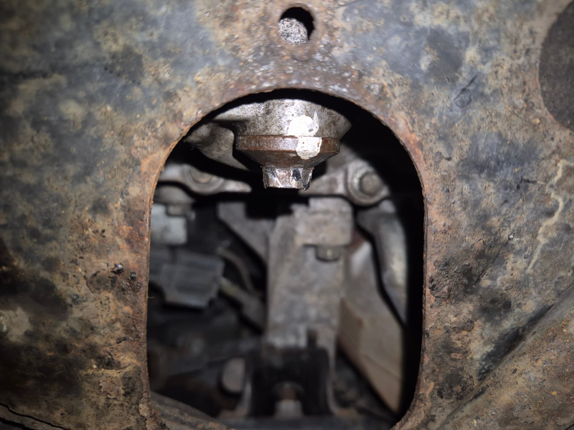

Update, a simple task has now become a headache. With the gripper bolt extractor i was able to get a good grip on the bolt but it was almost impossible for me to loosen it. Annoyingly i was the last person to tighten it last year when i did the oil change :expressionless_face:. Weirdly i found the sump plug’s head needs a 13mm socket instead of the regular 17mm, not sure how that happened as almost all forums online suggest a 17mm socket for the job. Seems like this time i would need professional help

That’s not an original sump plug. It might be worth trying to knock it loose using a chisel on the edge of the washer. Shock will probably loosen it rather than a twisting action. The trouble with this sort of problem is you learn how to get round it from experience rather than from the internet…
I’ve got to question, is that the engine oil sump plug? It looks odd, not anything I’ve seen on an NC sump maybe it’s the camera angle it was taken??
Just an observation but where is the sealing washer ?
That looks like the sump plug is directly seating on the sump.
I think the sealing washer has been crushed into oblivion!! I certainly can not see any evidence that it has one fitted.
Okay seems like the drain plug in the picture is not of the MX-5. This makes sense as the washer i got last time didn’t fit, i naively thought i have bought the wrong one. However that being said i did put back the drain plug with the washer which was already on, i know you can’t see that in the picture but i remember well to have used it. I gave up lossening it as i tried knocking the rachet with a brick in the hope of loosening it as @Roadster_Robbie suggested without any success. I’m pretty sure it can be undone but trying to do it under the car on axle stands is bit tough for me, if the car is on an ramp it should be way easier. And the hard lesson here is to always use a torque wrench for setting the torque.
That sump plug looks like one from a Mazda2 DY… Did it have a rubber seal on it?
