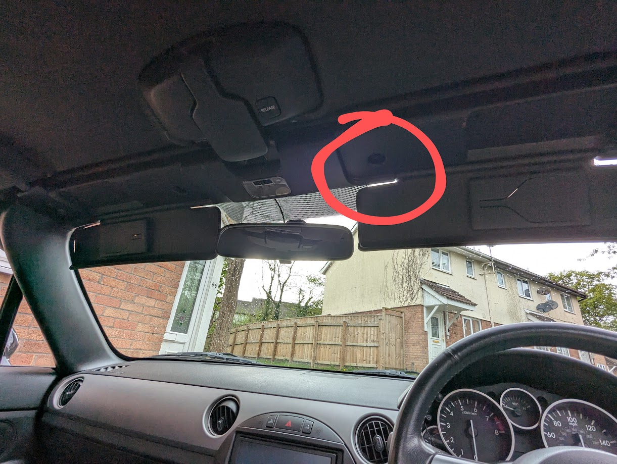

  2. I’m based near: Cardiff

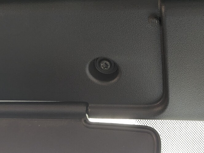

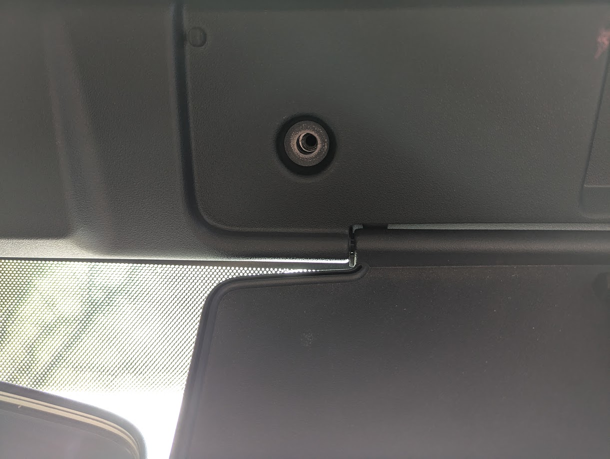

  3. I’m looking for technical help or recommendations on: My car is creaking and clicking over small bumps and it appears to be coming from the sun visor area. On inspection there is a bolt missing from underneath the sun visor. I wonder if anyone knows the part number?
I don’t know the part number but I would remove the old one, measure it and buy 2 new Torx bolts that match as it looks like the old one has seen better days.
So simple thank you. Found 2 bolts the same size (hex heads) and fitted. Also performed the roof tightening fix and it’s much quieter on a short test drive.
