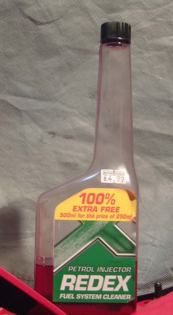

 I had similar problems to yours in 2006 so I used this stuff, I used it over 4 tanks full of petrol. The last two MOTs have not been a problem as far as the emmisions test is concerned.  There are different bottles of similar stuff made by REDEX so make sure you get the one for Injectors. If your car is an Import make sure the MOT tester knows that, as it does make a difference

One more question, on using the Redex injector cleaner, is it better to empty and refill the tank with fresh fuel before the MOT or is it better to leave the injector cleaner in the tank while they do the emissions test?

 No need to empty the tank. I use it all the time now and I have never had any problems since I used the first bottle full over 4 tanks full of petrol. REDEX keep having special offers on the cleaner so I just keep my eyes open when I am near any of the many motorists shops and when it is on at a special price I buy 2 or 3 bottles .
