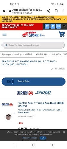

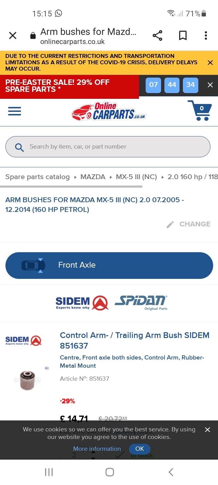

So lets say if anyone wants to change/refresh the suspension bushes on their NC where can one find said rubber bushings?
Thanks
Try here :crossed_fingers:
thanks dude
