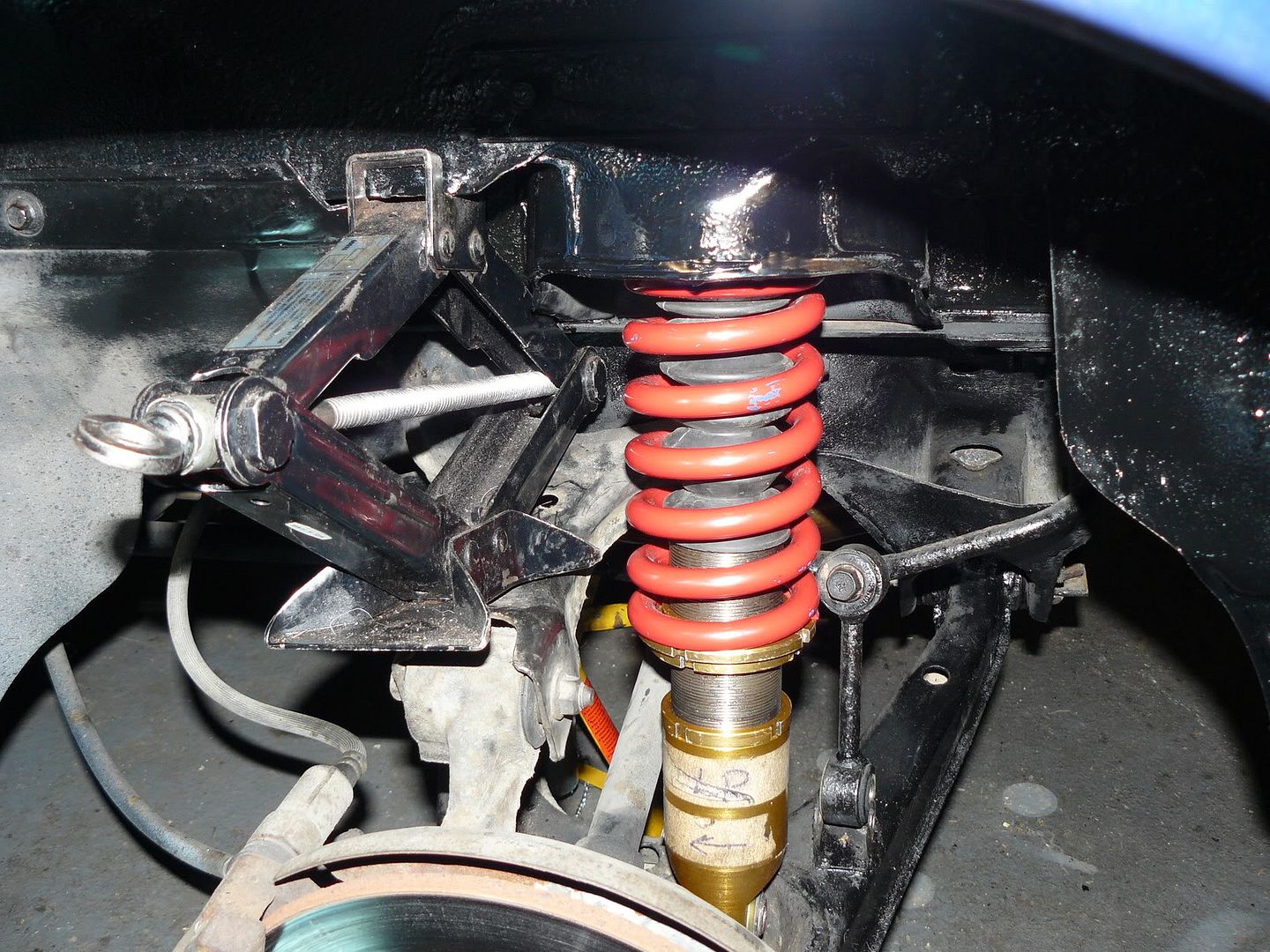

This always works for me to push down the rear upper wishbone in a controlled manner.
Robbie this is the guide I used on mine the other day http://www.mx5oc.co.uk/forum/default.aspx?g=posts&t=242 it does say to compress the spring in situ.
Compressing the spring in situ is something I’ve done before, when swapping out standard shocks and springs. I believe the San Dieo Miata Club first came up with this method. The issue is the front springs, because there isn’t a lot of clearance. But then I discovered the long bolt method (releasing the long bolt on the front upper wishbones, which makes remove of the front shocks unbelieveably easy ( timed it, admittedly with pre-free’d off nuts and  bolts; 5 minutes a corner to remove the shock and spring). From memory; release the ARB links, undo the front ARB mounts, remove lower shock bolt (using jack under wishbone to take the presure off the bolt), undo and withdraw long bolt. The wishbones drop down, leaving the shock/spring assembly dangling. Removing the long bolt is the fiddliest bit, because the ARB bolts foul up its exit.
