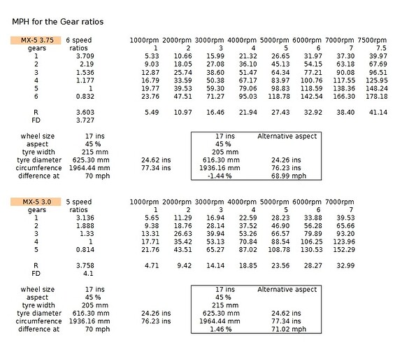

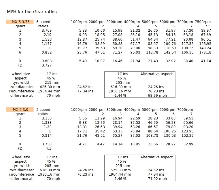

However, I’ve done a quick spreadsheet to see what the differences might be with the gearing. It’s just numbers and does not really explain the difference in urge I felt between the two cars.

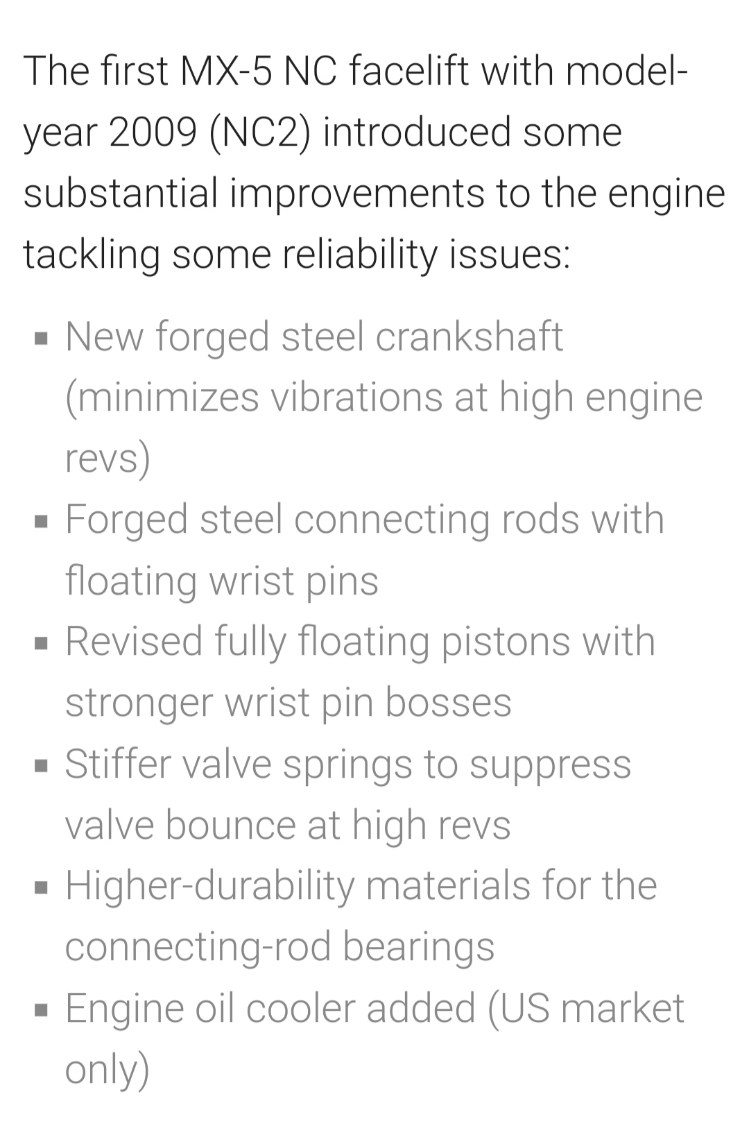

Also wasn’t there a change by mazda to throttle mapping at some point between the nc’s to supposedly remove flat spots in acceleration?
Also found this:
Good point on the mapping.
