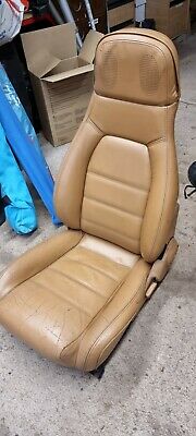

Hi
My tan leather drivers seat has the usual bolster issue, but also the main seat pad is completely ripped. Does anyone know of anybody that can repair seats?
Many Thanks
Duncan

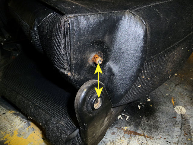

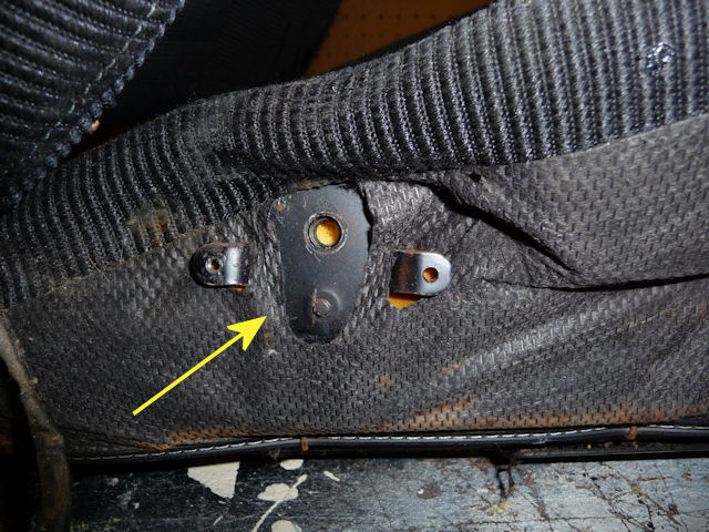

The covers are handed. On the outboard side, you have a big chunk of plastic covering the hinge. Obviously not on the inboard side.
Now you could say “but you won’t notice the two inch holes” when swapped, but I know I would. In addition, on the inboard side, there is an indented cutout in the foam for the smaller hinge.
