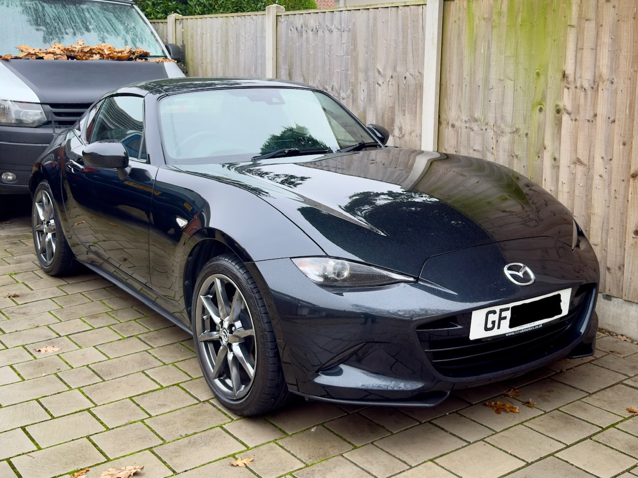

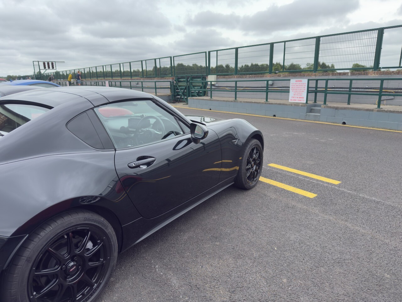

Hi all, new to posting but have been lurking since November.
I’d like to introduce you to The Girl Friend.
Named because the original number plate began with GF and I’ll clearly be spending all my money on her :laughing:
A joke that fell flat with my wife, who initially wasn’t keen on me having it due to buying it whilst she was away… (something about a midlife crisis and living dangerously :roll_eyes:)
Until that is, she saw how much pleasure it brings me and I took her out for a spin one sunny day. Now she understands why I’ve been calling it the Sunday Lunch car and is all in favour of me having it!
It’s an MX5, every mile brings a smile! :blush:
Thing is, I’ve been on something of a medical adventure these last few years and it’s left me thankful to be alive, albeit with a few mobility issues. Every moment is precious and not to be wasted. There’s no point delaying your pleasure for some mythical point in the future when everything is “perfect” .
I fell in love with the RF the moment I saw the first images in 2017. It reminds me of the Datsun 240z which was parked on my street as a kid. I drooled over that every morning on the way to school, just as I drooled over the RF.
Those mobility issues however have left me unable to drive a manual these days. I can shuffle one around a parking lot if needed but soon tire if I have to drive more than a few miles. An auto wouldn’t be my first choice, and the MX5 desperately needs a DCT box, but what it has is ok for my use case, a toy for the weekend on the twisties.
It’s not a track weapon but I do have an upgrade path in mind as I fettle it to bring more precision and finesse. I’m looking for an OE+ outcome. A “sprightly GT” feel where I’m as comfortable taking my wife away for a weekend in it, just as much as I am throwing it around the B-roads at the weekend
It was stock when I bought it in Nov 2024 with 9,871 on the clock. Overall it’s in great condition with just a couple of small rust blisters underneath (that I can see ofc) and some light swirls in the paintwork

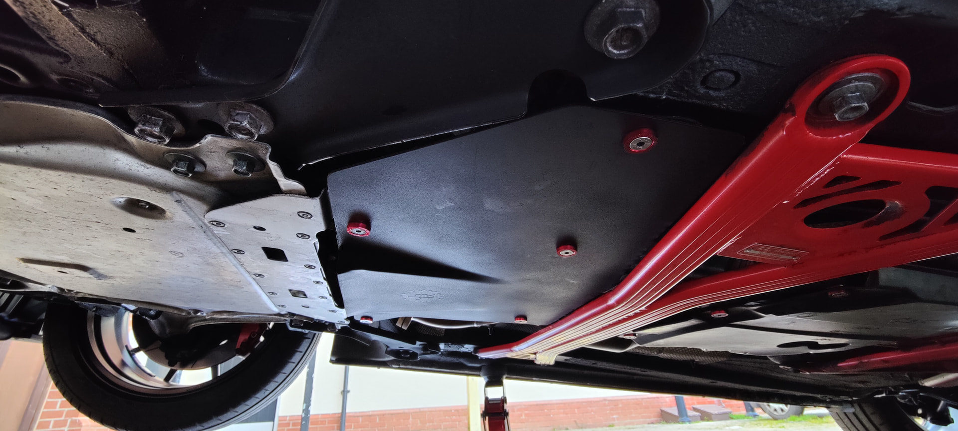

I’ll be taking care of those issues later in the year with a Dinitrol underbody coating and some paint correction/protection.
Since then I’ve swapped the rear cluster and side repeaters for smoked ones and bought some new rims. When the paint protection is done I’m going to swap in black badges. If you knew me you’d know everything has to be black :laughing:

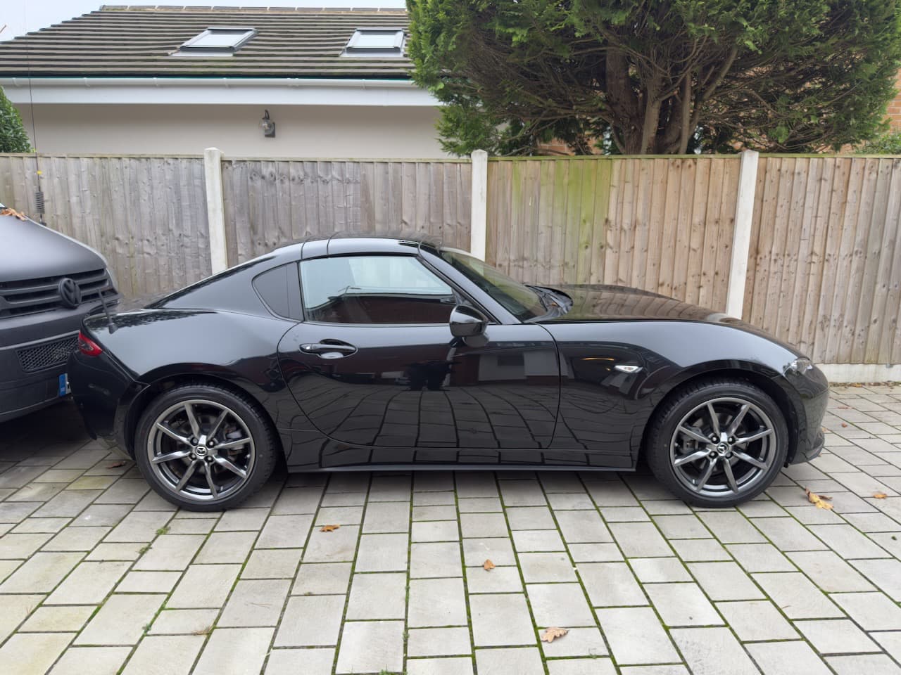

The old stock rims have my “winter” tyres on, Pirelli Cinturato All Season SF3.

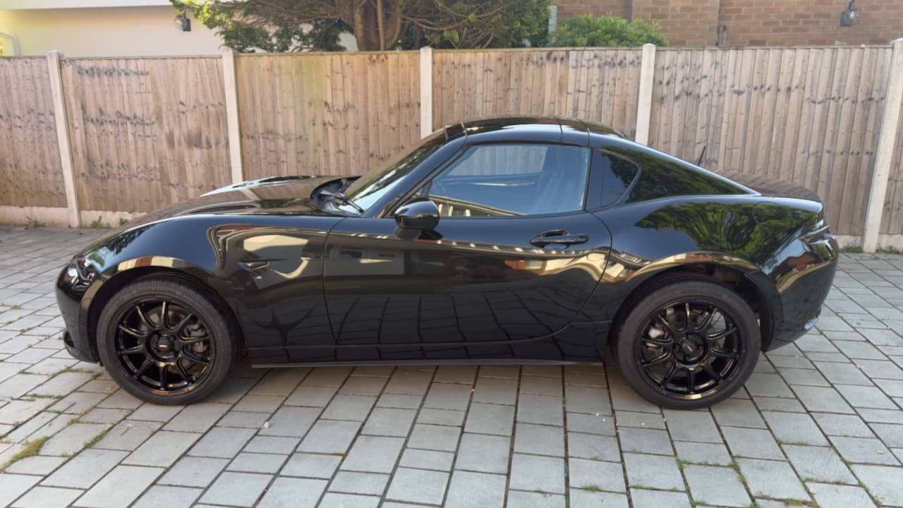

The new rims for the summer, are Team Dynamics Motorsport Pro-Race LT, with Bridgestone Potenza Sport
I got the Team Dynamics rims because they only weigh 7.5kg each, less than stock and so removing some unsprung weight
As I mentioned in another thread I recently had an alignment done to the Flyin’ Miata figures which has massively improved the handling. It now feels like the rear is glued to the road. Unfortunately during that alignment, it was discovered one of the bushings on the FOS was spinning and preventing the camber from being adjusted properly so the front end still needs a bit of work.
I’m now looking into replacing the bushings all round and weighing up sticking with rubber or moving to poly.
I’ve put a mild Versatuner remap on it to open up the bottom end torque and let it rev more freely at the top end. This has helped with getting a bit more life out of the long gearing of the auto
Currently, I’m very happy with it. Actually, that’s very much an understatement. I’ve fallen in love…
I’m not going to do anything else but the bushes and protection this year. I wanted to drive it for a full year to get a feel of it and work out how I want to tweak things before any real mods but I do have a path mapped out through brakes, bracing, intake and exhaust, suspension, LSD, and finally, in several years time, a BBR Super 220 engine rework. I’d go for their new supercharger upgrade but I don’t think the auto box would handle it. 220bhp is as much as I’d dare put through it and tbh absolutely plenty for my use case.
That’ll do for now. I’ll update this thread as I go along detailing the changes I make.

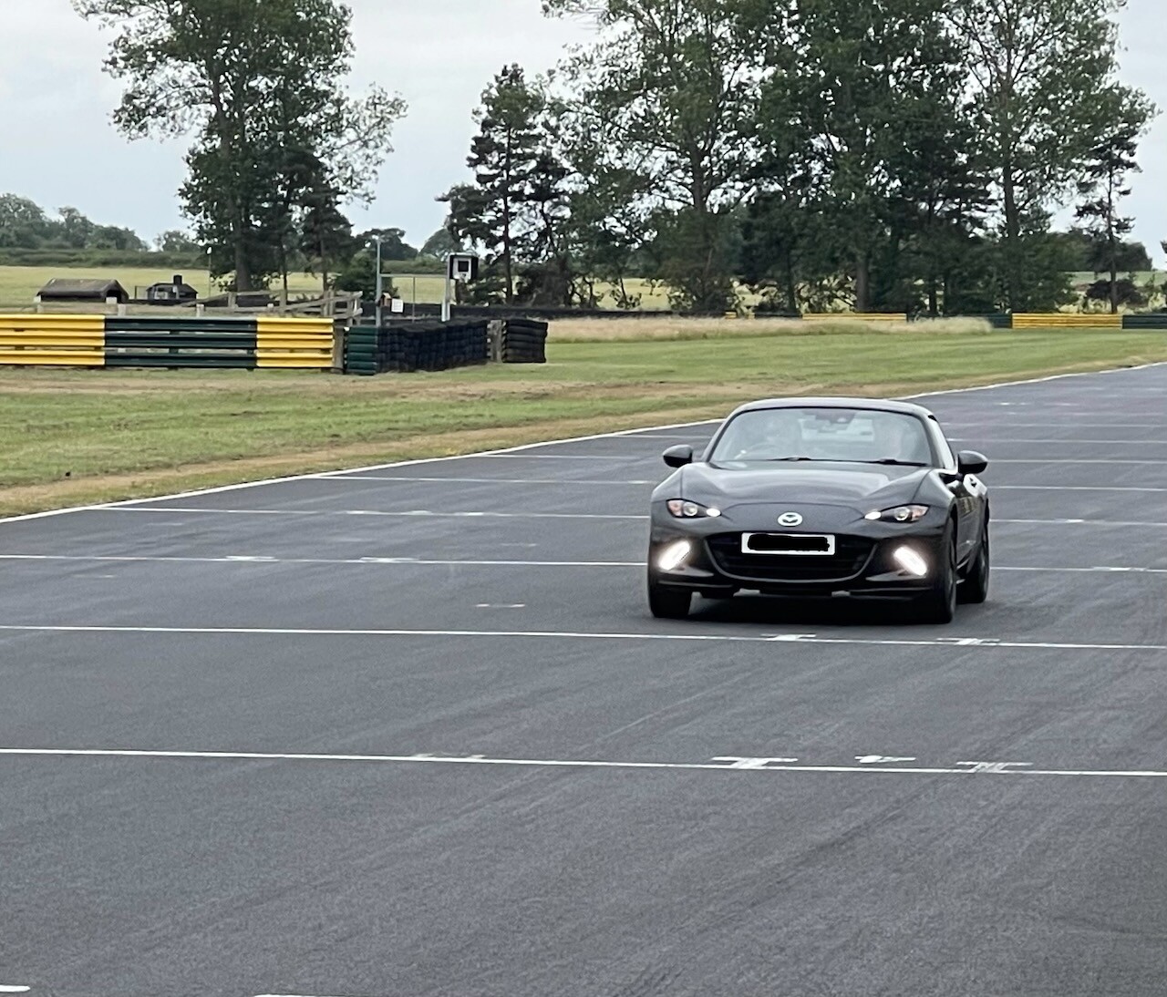

Then in July I took her to Croft Circuit for a skills day with the IAM. Superb fun thrashing it around for a few hours (don’t tell anyone, it was purely about improving my driving skills :wink:)
The result of which boiled my brake fluid and left things decidedly softer under foot. I could smell the brakes every time I got out and undoubtedly could have fried eggs on them!

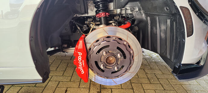

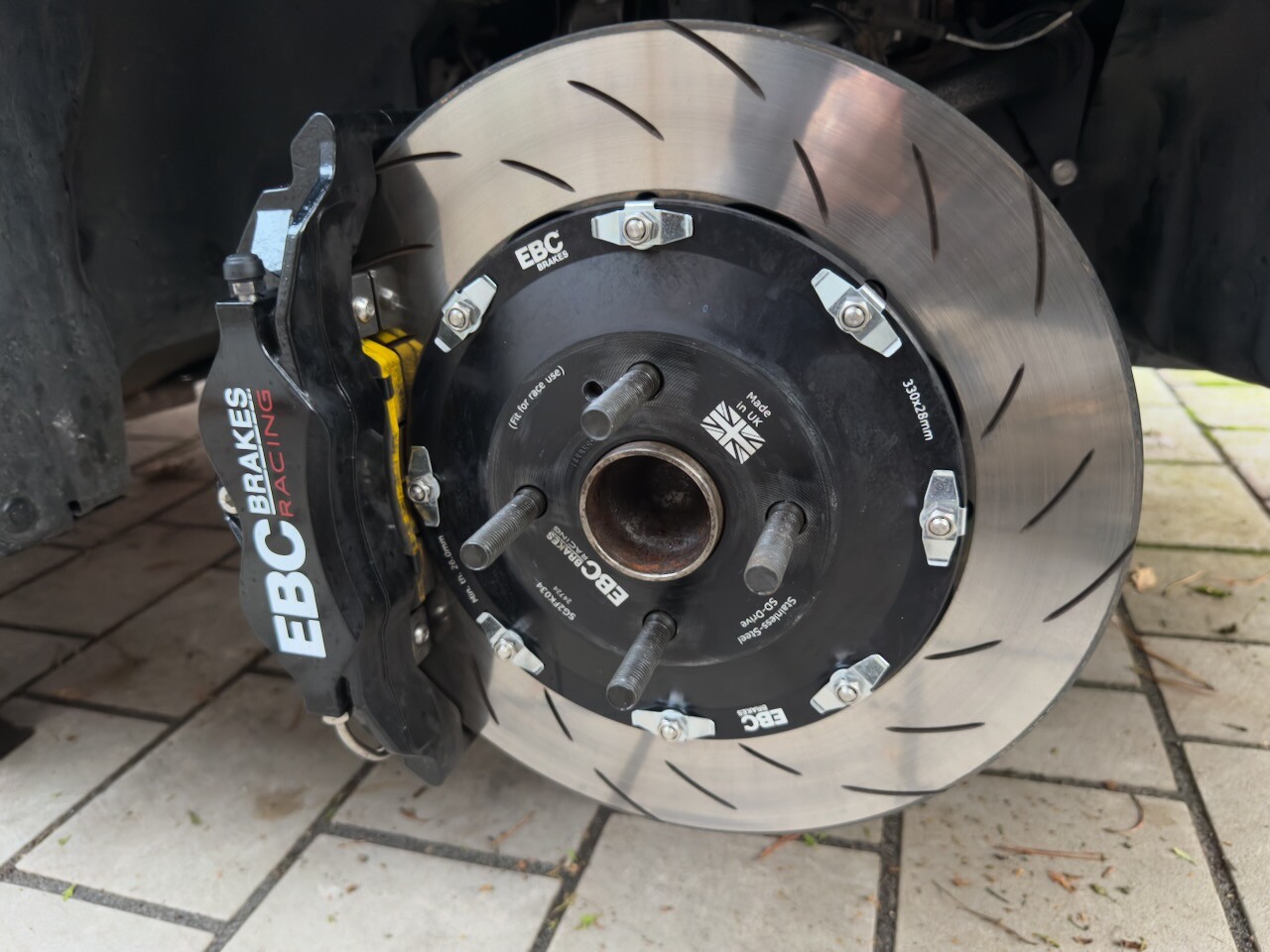

I’d chosen to fit the EBC Apollo Balanced Big Brake kit with Yellow Stuff pads, my local garage doing the work.
Problem being the new calipers were catching on the rims. No problem, I just ordered some 10mm spacers.
Problem being the studs were now too short :roll_eyes:

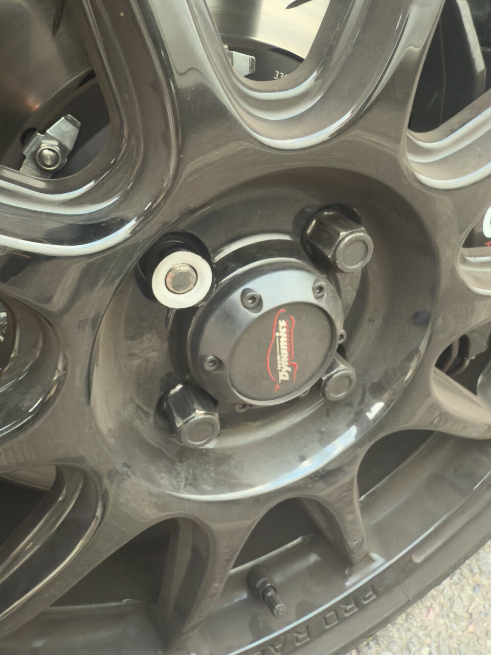

The longer studs then caused a whole raft of problems, unfortunately not fully understood until I reached the carpark at Thruxton.

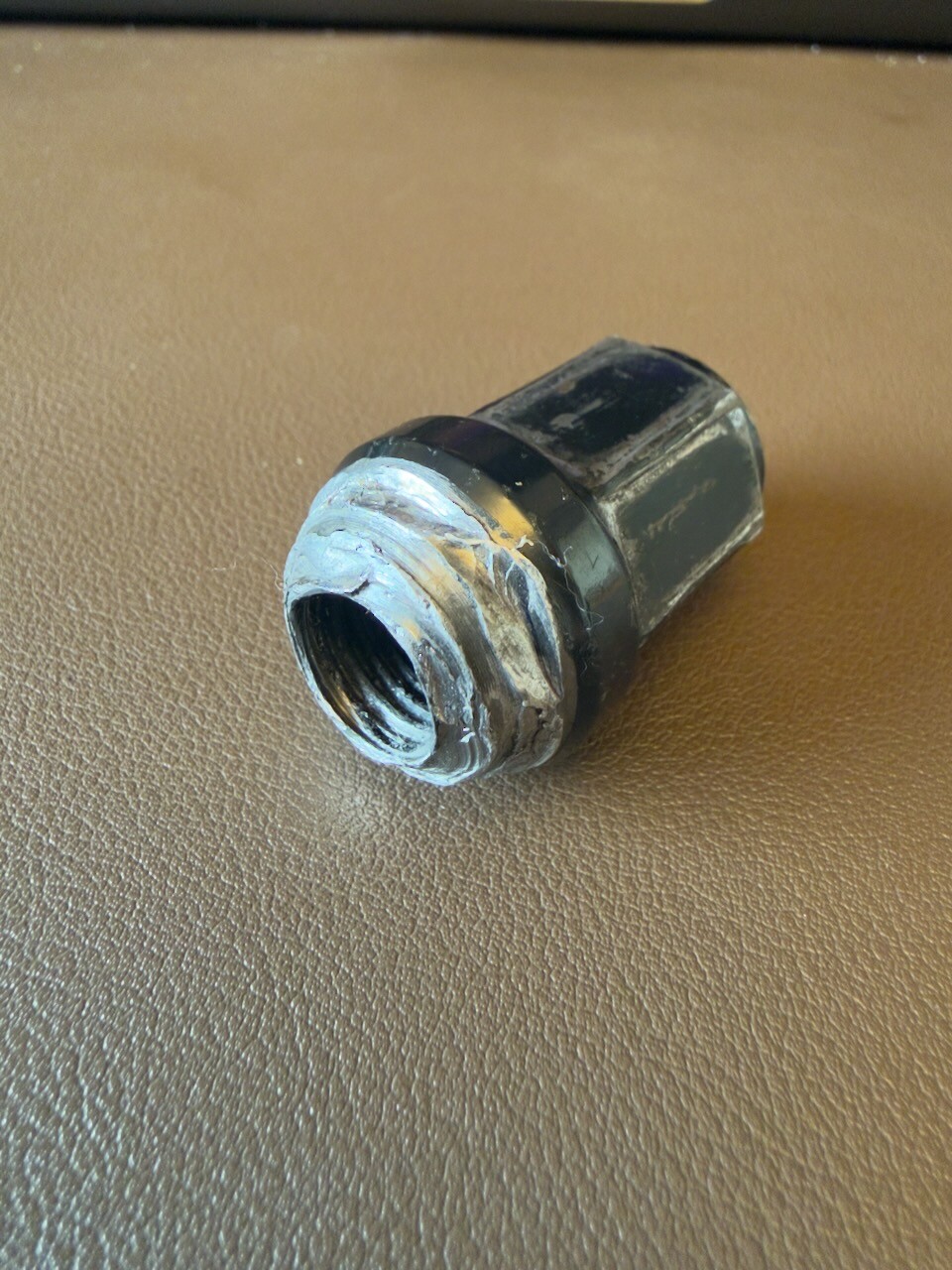

My existing closed end wheel nuts were bottoming out and so the wheels weren’t being torqued up correctly. An imperceptible amount but over the 150mi journey to Thruxton it made a difference.
I’d heard some knocking from the rear on the way down but since I knew the sphericals needed replacing (I’d heard knocking from the rear before), didn’t associate it with the wheels. Prior to my session on the skid pan I thought it best to check the wheel nuts were torqued properly where I discovered a couple were loose. Like spinning freely with my fingers loose :flushed_face:
Of course I promptly tightened them down as much as I could, only to blow the end off two of the locking wheel nuts long before I reached the correct torque! :flushed_face::flushed_face::flushed_face:
You can see the EBC brake disk in the above image. This was off the front, the other blew on the rear.
One skid pan session and a very slow 150mi drive home, stopping regularly to re-torque the nuts, left me with severely damaged rims where the remaining nuts gouged away at them, becoming damaged themselves in the process.
That drive home was not a pleasant experience to say the least!
After getting home I bought some open ended nuts and got the studs replaced as I no longer trusted them. The rims will need replacing eventually as I’m not entirely trusting of the no longer conical seats but I’ve not done any particularly hard driving on them since and won’t be doing much over winter. They torque down enough and hold properly but peace of mind dictates replacing them before pushing it too hard (“making progress with a spirited drive” in IAM parlance) on the twisties.

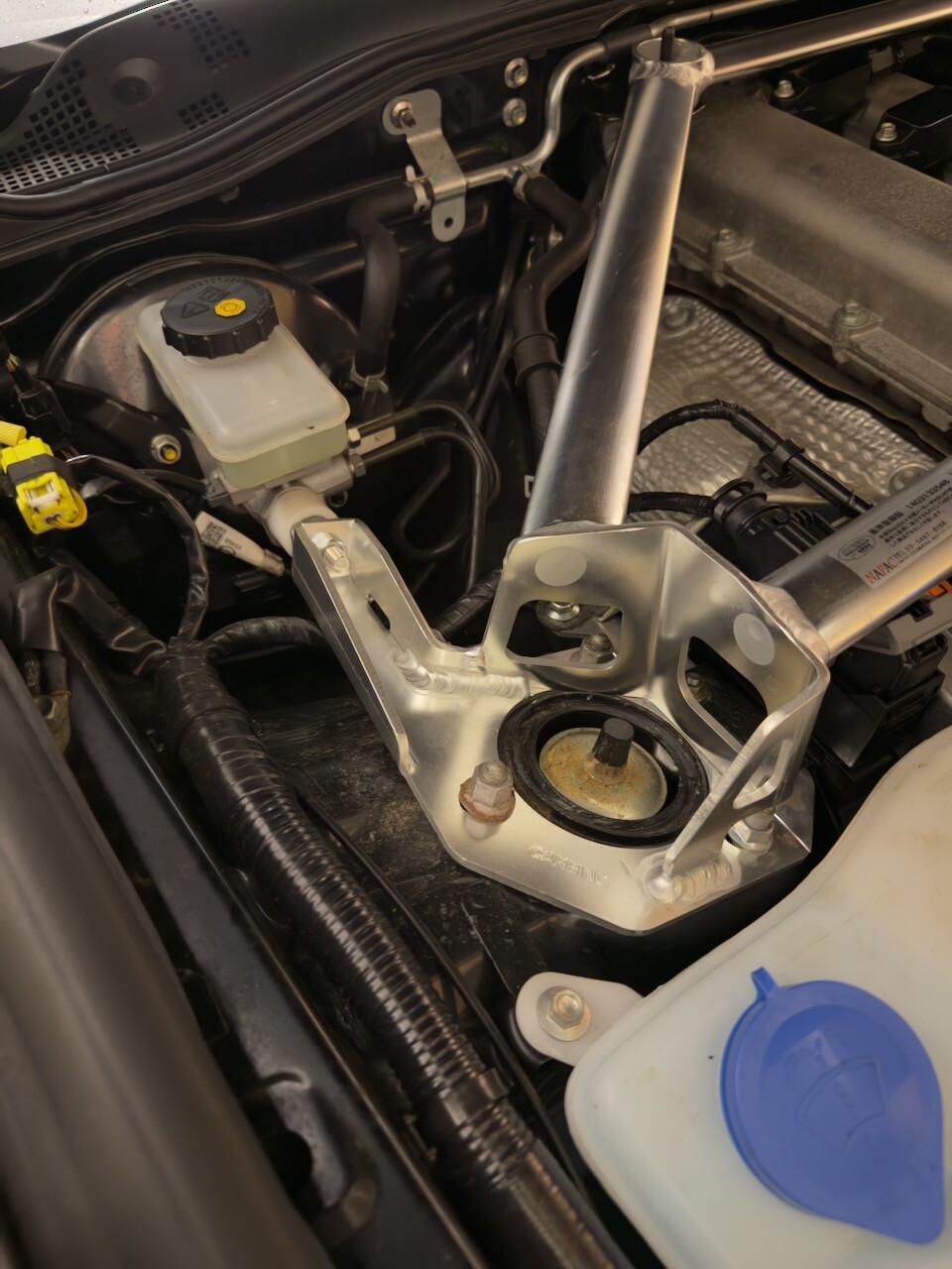

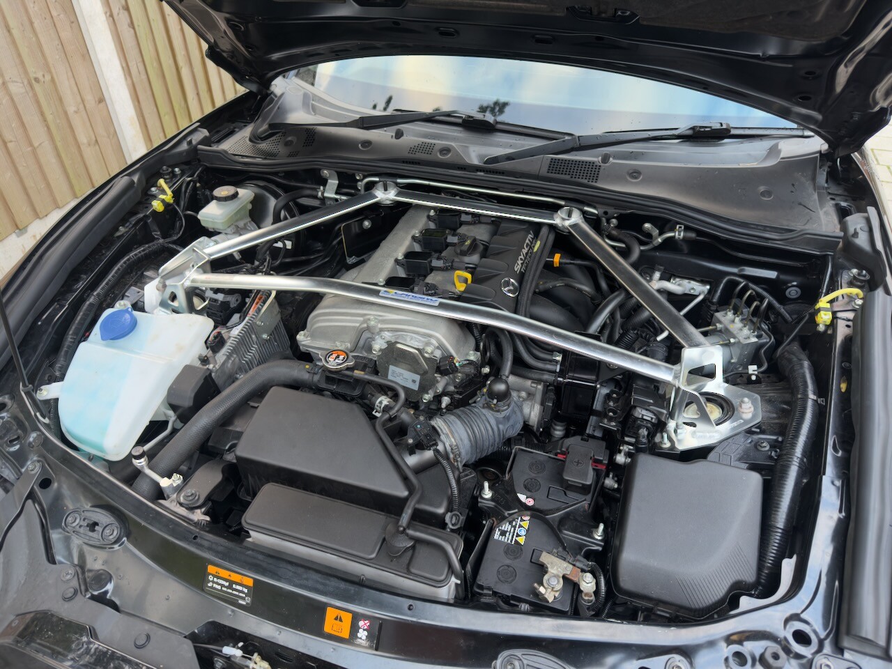

That changed the other weekend when I finally got round to fitting the Front strut brace from Carbing. This has a cross brace as well, not just arms going back to the bulkhead, and has the added benefit of a brace for the master brake cylinder.
This has made an amazing difference to the feel. I’m now back feeling connected to the front and the steering sharpnesss has improved greatly.
During the fitting of this, since I had to install the cowl strut mount, I took the opportunity to reach in behind the engine and plumb in the Verus Air/Oil Separator. Fitting under the cross brace took some doing and I might have to rethink things down the line if I decide to supercharge her but for now it fits and all is good.
Subjectively it feels more responsive now. I don’t know if that’s as a result of removing the sound tube in the process, or the fitment of the AOS itself, but it’s definitely noticeable and not something I was expecting.
Whilst the cowling and cover was off I also took the opportunity to fit the screen for the cabin air filter, however I didn’t have time to take the cabin apart to fit the filter itself. That might have to wait until I have time to pull the seats and carpet out and install some heat shield matting in the cabin so I can stop my left foot being boiled alive every time I drive it for longer than and hour!

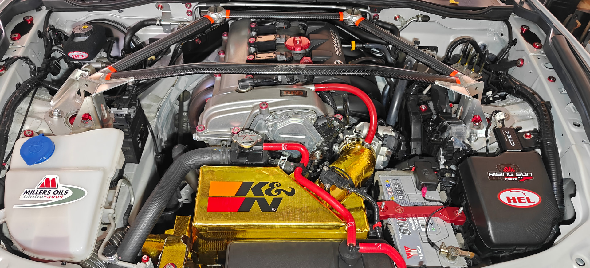

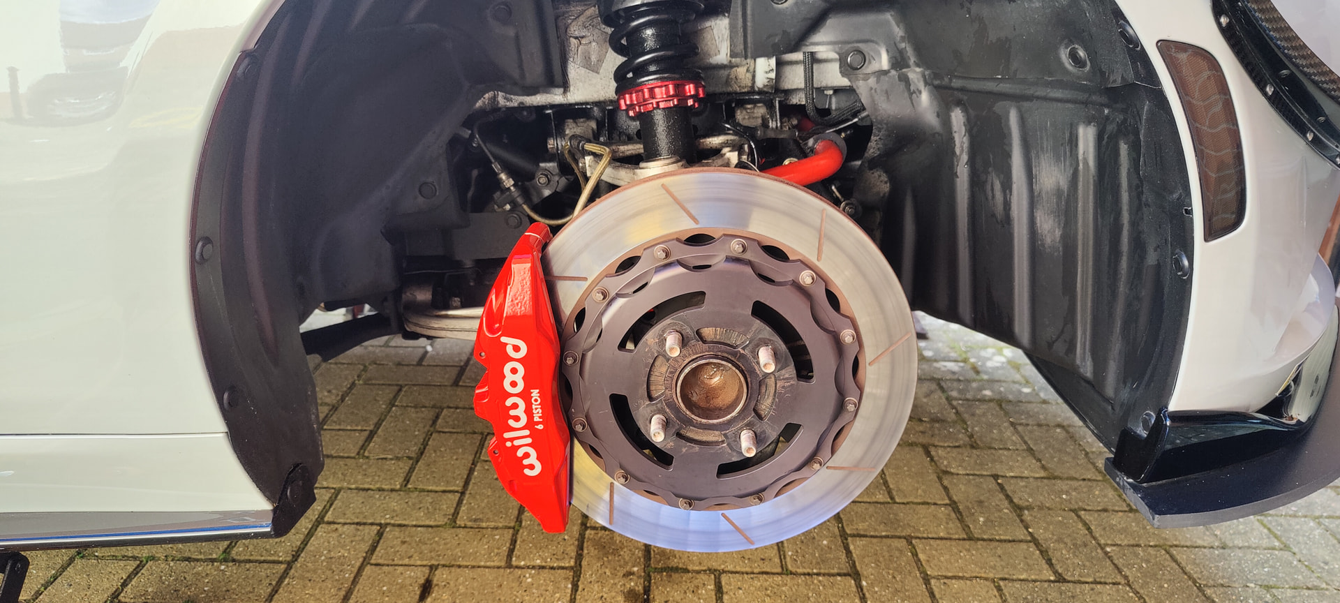

I took got the Carving strut brace back in early 2017 as it had the cross brace and brake stopper.
For the brakes I used Wilwood 6 pot calipers (EBC brake kits weren’t around in 2017) with Goodwin Racing 12.88 discs and provides superb braking. It’s interesting to see how other people modify their cars
I love seeing how people mod their cars.
For example I really like the gold heat shield around the air filter and pipework on yours.
That’s a great idea. Might have to steal that when it comes time to install the BBR cold air intake.
I’m sure the gains are marginal but keeping the air as cool as possible can only be a good thing.
For the airbox I used Zircoflex 3 which is an excellent heat shield material. Still working on reducing heat soak further.
I had a feeling it might be that. I’m actually looking at putting their coating on the exhaust when it comes time to upgrade it, as well as covering the underside of the transmission tunnel in Zircoflex 3
I have to do something about the heat in the footwell from the exhaust/cat and transmission. It’s not so bad for people driving manuals as their left foot is always moving. But for me in an auto, my left foot just sits there and gets boiled alive!
I’ve smelt the glue in my shoes wafting up on a number of occasions whilst on long drives :flushed_face:
A gearbox cooling scoop will help in reducing the heat
Although not OEM, I like that :slight_smile:
You do like your red accents don’t you? :wink:
Unfortunately I’ve only seen ones for a manual transmission. I suppose I could get one and butcher it to fit an auto but I think a scoop is an additional measure on top of upgrading the heat shielding.
Looking at the underside most of the heat comes from the cat so I’m actually looking at upgrading the OEM heat shield (going to approach Zircotec and see what they can offer and adding to it with their flex shield inside the cabin and lining the tunnel.
That’s for the future though. It’s winter season now, the extra heat is appreciated!
