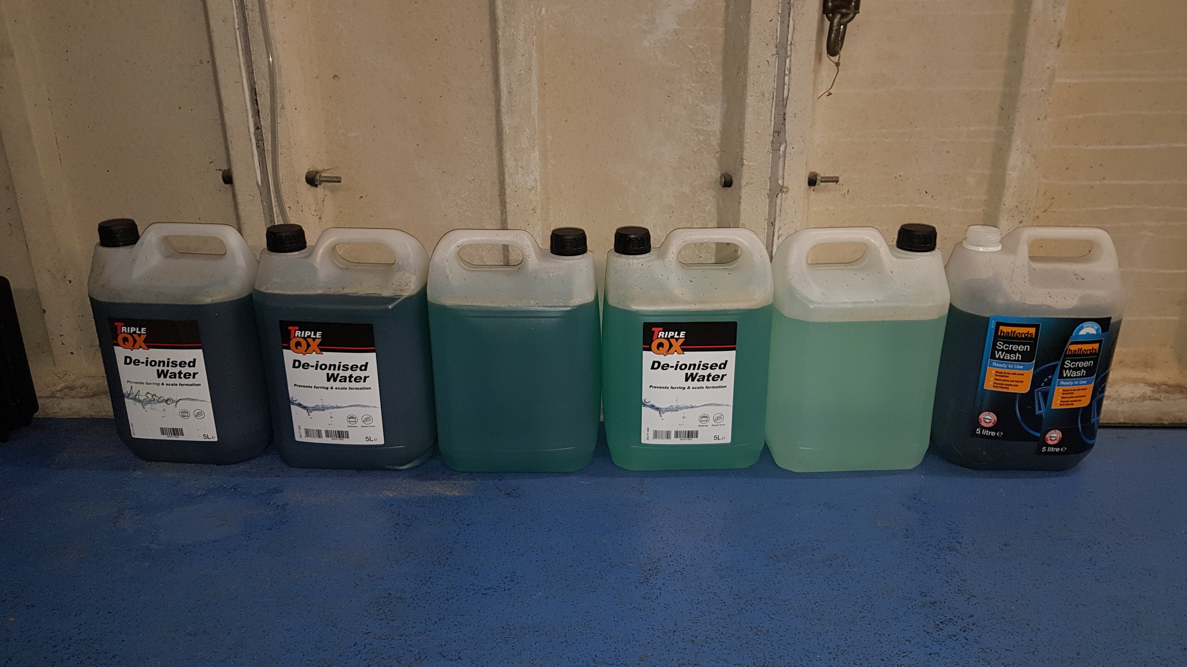

Right well I’m going to do the drain and flush tomorrow (picking up 10L of de-ionised water shortly), and then the stat and final refill on Monday :ok_hand::ok_hand:
ChrisMK3 don’t flush it with a hose. Depending on your water hardness and purity you probably don’t want standard tap water in your cooling system. When you fill up with coolant there will be some normal tap water left inside, the old coolant you flushed out is probably better. Flush with deionized water if you really think it needs it. Regardless of what you flush with you will be reducing the antifreeze concentration levels in the FL22, unless you flush with FL22 of course but whos got the money for that type of escapade!
edit: That first bit was not supposed to sound like an order! just a recommendation :slight_smile:
Yeah I’ve since bought 10L of de-ionised water to flush it, but it got me thinking, how can I be sure that as much of it is out before I do the final flush?
I don’t think you can get all of it out unless you can suck it out with some special equipment. Just flush with what you have, you’ll be fine.

I would not worry too much about getting every last drop out. Empty the radiator and change the stat, refill with deionised. Run engine till warm. Empty radiator and then refill with whatever coolant is the right one for your car and then burp it. If you use fl22 it will be diluted a bit so you could do the empty refill process once more with fl22 instead if you have enough but I’m sure that even slightly diluted the antifreeze properties of fl22 are good enough for the uk. When i first got my mx5 I gave it a proper flushing. It took few tries with deionized water to get the original fl22 out
Whether that was entirely necessary is anyones guess. I had to empty it again when I changed the stat.
