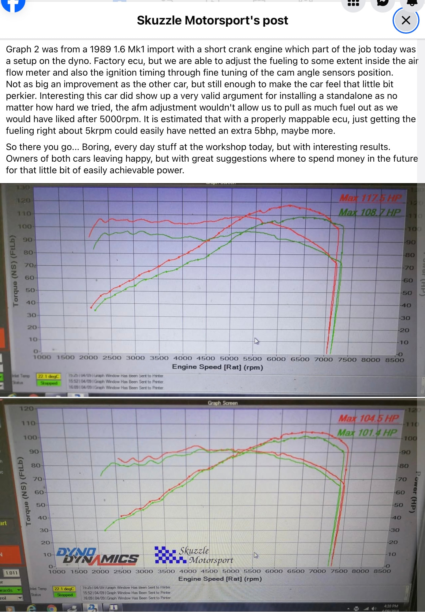

Here is a graph I found on skuzzle Facebook. This is for a 1989 shortnose crank engine with no mods. These figures are wheel horsepower. Showing about 5lbft increase throughout 2500 to 4250 rpm. With the intake/exhaust yours would be better still.
