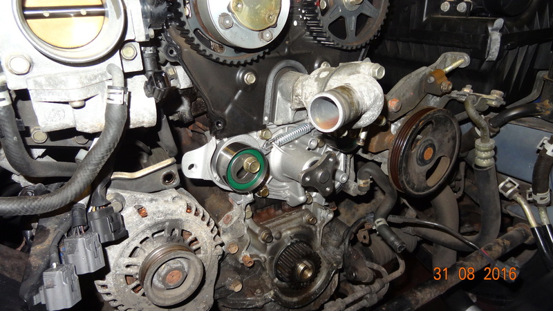

This is the new water pump

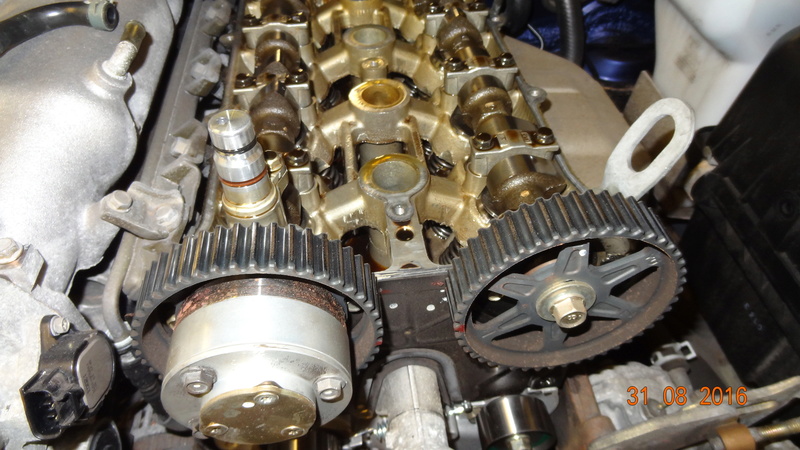

The cam box looks like new
