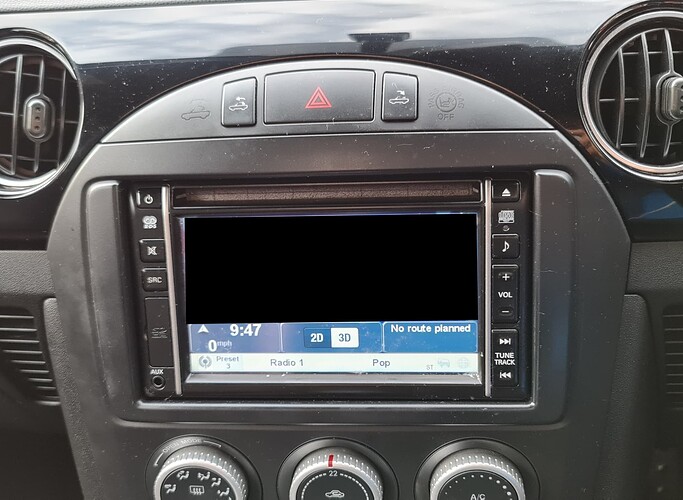

Hello
I currently have a 2012 NC which came from the factory with a double DIN headunit, which I believe is what came with the car from the factory.
I would like to replace the current head unit with one that has Android Auto. I think I know what cables I’ll need (linked below, if something doesn’t look right, please point it out!), but I’m unsure about the facia.
Will I need to buy a replacement facia? It seems like the stock one is close to, if not an actual double DIN facia. I don’t want to buy a new facia to only find out I didn’t need one in the first place.

The shape of that facia does look different to mine after an aftermarket head unit install. Not 100% sure you’ll get away with not changing the facia part, maybe a member who’s changed theirs can comment. I think it’s a Sanyo later an Alpine that were installed in these.

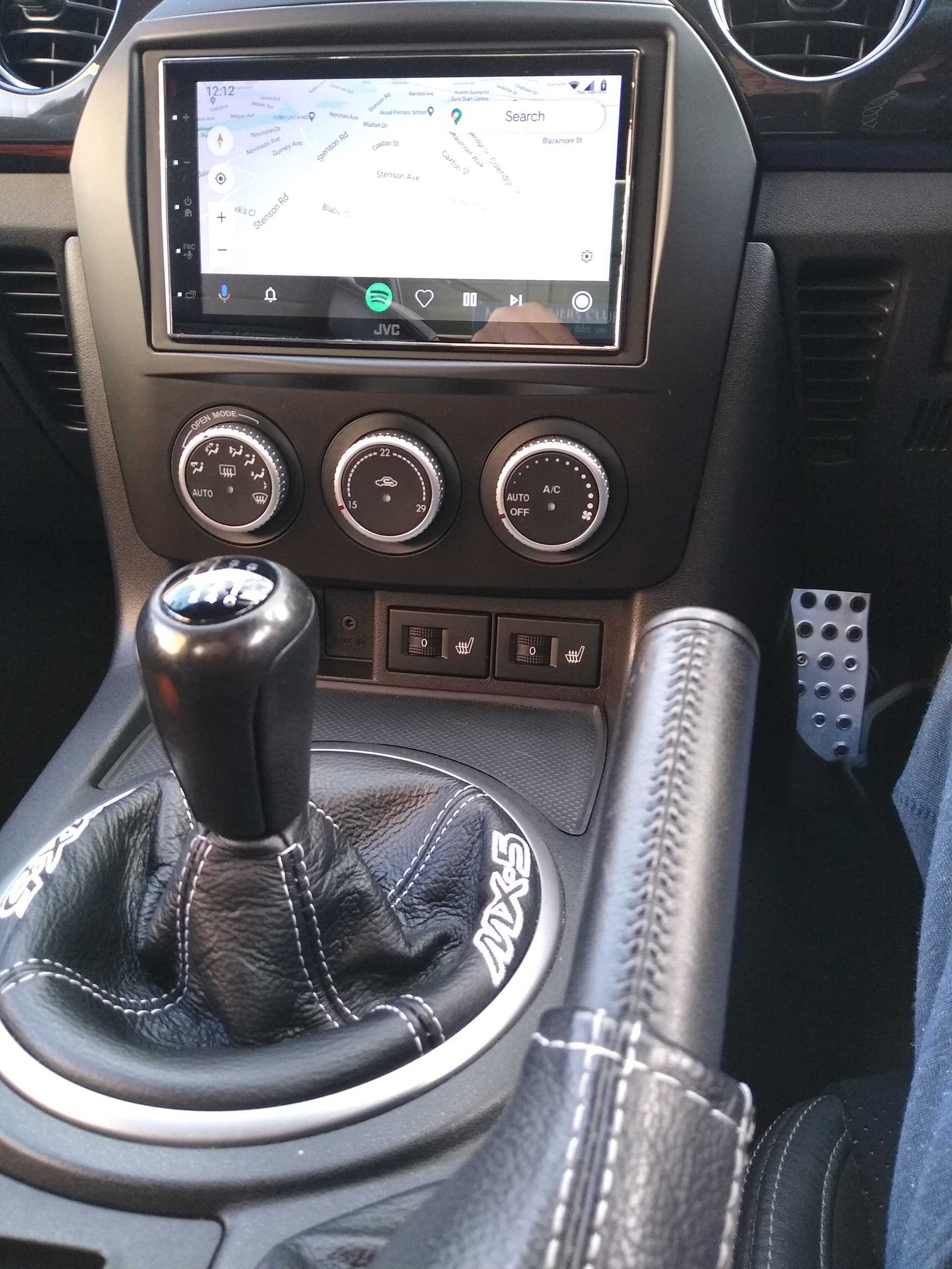

Mine’s a JVC, have heard Pioneer are pretty good too.
Compare head units facia…
Yes this one as I bought.
CONNECTS 2 FACIA CT24MZ20.

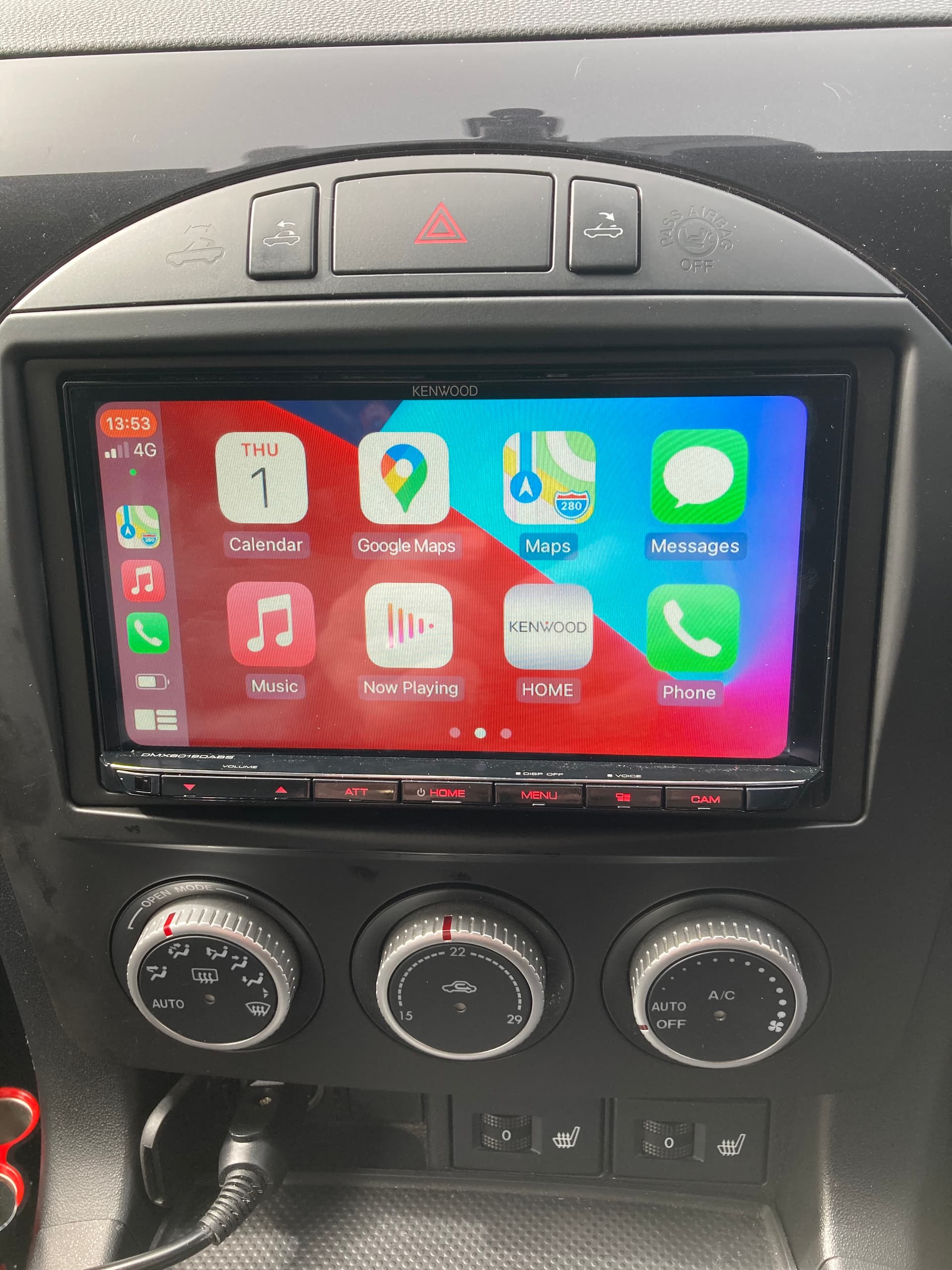

I replaced my TomTom Unit with a Kenwood.
A few threads on here of what we have all done.
If you get stuck more than willing to help with pictures etc.
The wiring is a tad confusing behind there depending what you are going to fit.
As I added a reverse camera to mine at the same time.
