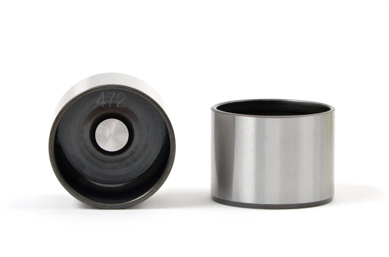

The lifters on the MZR 1.8 and 2.0 are not hydraulic - they are shim buckets.

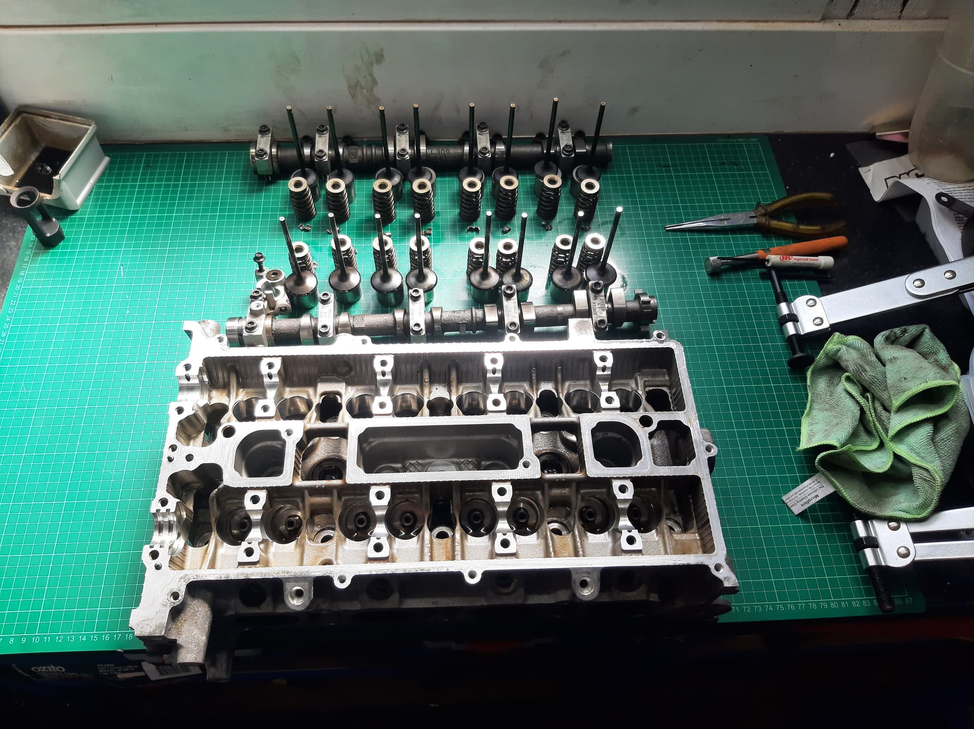

I have just reconditioned my 2.0 at 83k miles. It needed 6 shims changing to bring all 16 valves in to spec. There was no tapping to indicate it needed doing.
Shim buckets, that would explain a lot of the confusion on the forum I mentioned earlier between shims and solid lifters. So one can get shim lifters in different sizes not solid lifters :smiling_face_with_sunglasses::+1:
Yes - the cam follower is a shim bucket - it has the shim built in to it.
To adjust the valve clearance - you need to change the shim bucket.
Unfortunately - you can’t see the shim size until you get the bucket out.
