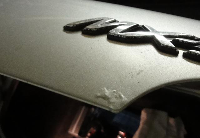

I have photographed the affected area of rust bubbles , but do not know how to upload the image from my computer pictures gallery.
The rust bubble area is on the bottom right corner of the boot lid, just below the silver MX5 badge, so its going to be seen whatever I do, so I either have  rust bubbles  or an area of miss matched paint if I cant get a good match ,

Looks like something has appeared
That won’t be rust on the boot lid if you have the soft top, the bonnet and boot lids are aluminium. I’d be trying to touch that in first with a brush after preparing it first of course. If it looks unsightly then spray it instead. Have you looked under the boo lid around the number plate lights, the paint usually lifts off there?
Yes, as above - looks like classic lift of paint on aluminium where water has got under the paint, oxidised the metal underneath.
Assuming it is aluminium but check with magnet to be sure, you need to remove the bubbled paint. There will be a white powdery oxide deposit underneath that need to be removed completely. Once sealed with appropriate primer and touched in will be a good repair. As with rust scrape/dremmel/sand to a clean metal edge.

I have one exactly like this on the leading edge of my bonnet.
A body shop local to me said that he would have to paint a huge area to blend it in, he was talking about half the bonnet, half the bumper and half the wing.
He suggested that I should maybe consider living with it.
Five years on, it still bugs me, but I appear to be living with it.
If that scab is winding you up, then the colour mismatch (which will be bigger than the scab), is sure to do so.
