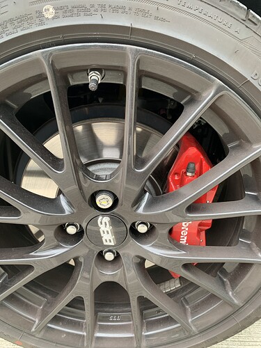

Hi Robbie. I have the BBs wheels on a RFlaunch edition and have the metal valves that look just like this pic. Therefore believe they are TPMS valves is this correct?
Yes, they should be.

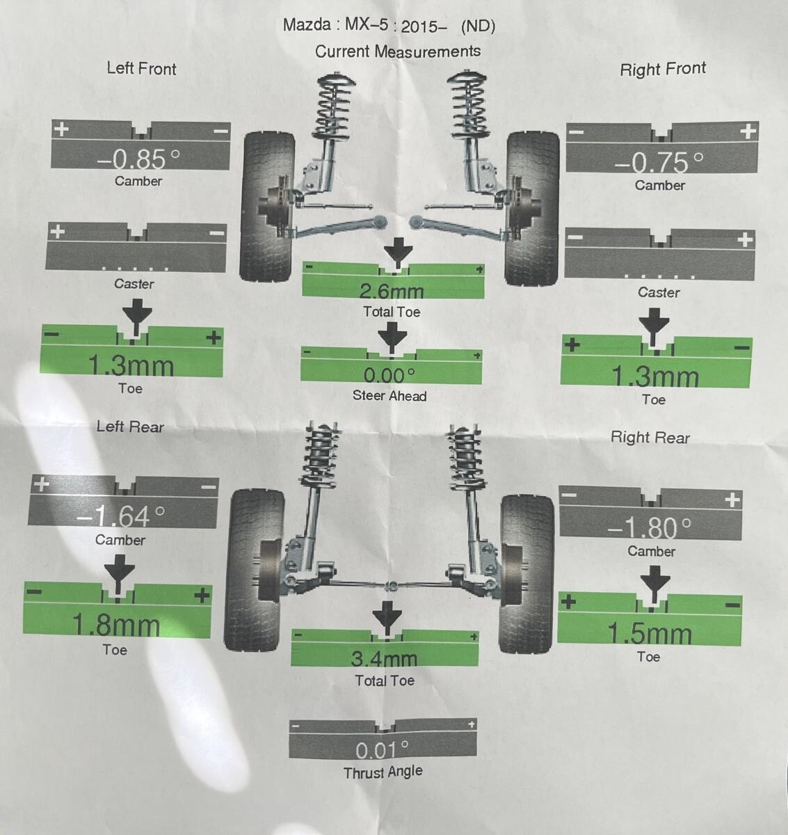

I have gone up a width on new tyres to 215/45/R17 Goodyears and had geo done with minor camber and toe in

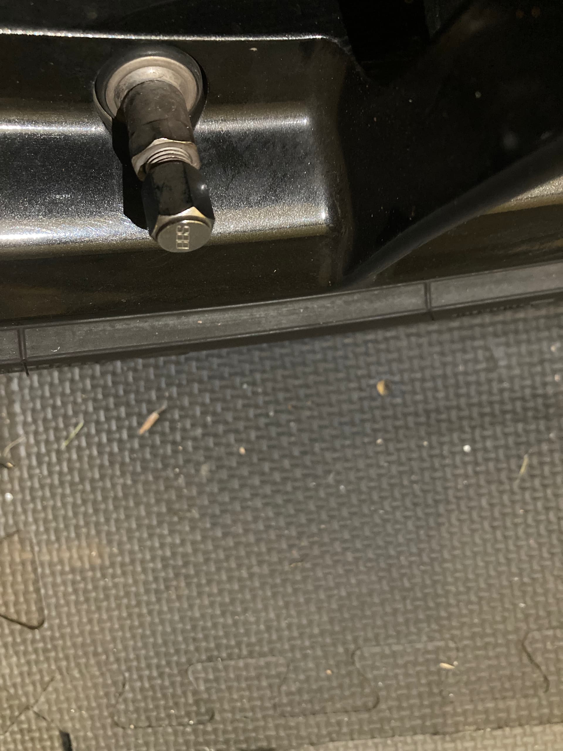

Pic of the valves below.
I’m confused why I would have TPMS valves and they would not be used
If it’s a Launch edition then the tyre pressure variation is taken from the ABS sensor. Those look like the standard valve stems that I have on my launch edition.
Yes, they don’t look like valves with wheel units.
