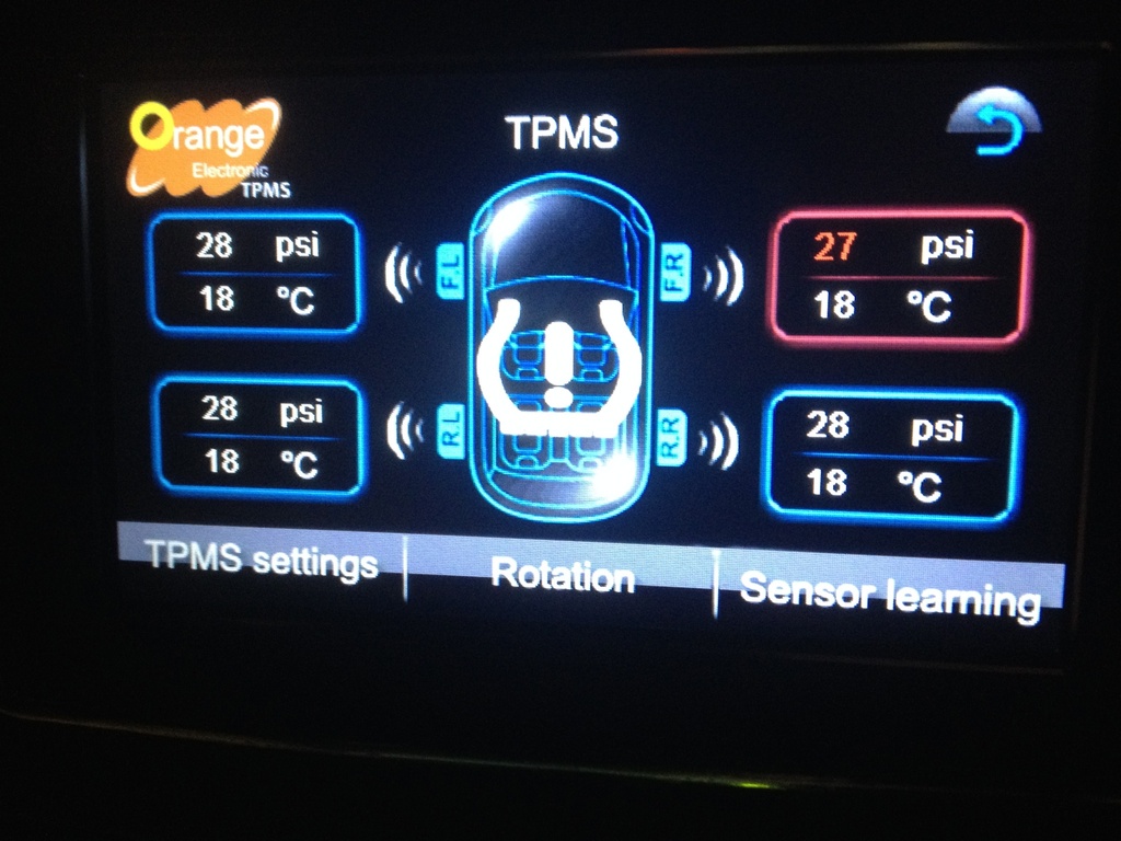

When I had my Mazda RX8 I used a company called orange and there units the worked very well in fact the left hand rear tyre blew but gave me enough time to react when the tyre deflated they have now up dated there products since then… and the read out monitor is a lot better….
Orange P429 TPMS OTO Wireless Car-Locate Tire Pressure Monitoring System 74 Psi
It’s a little pricey but do as search with the above in google you might get the price down

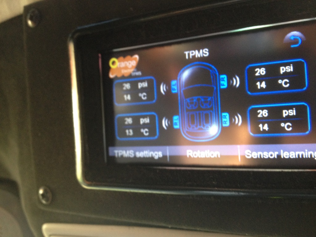

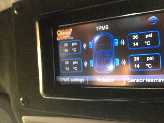

Made my own roof console to mount the devise

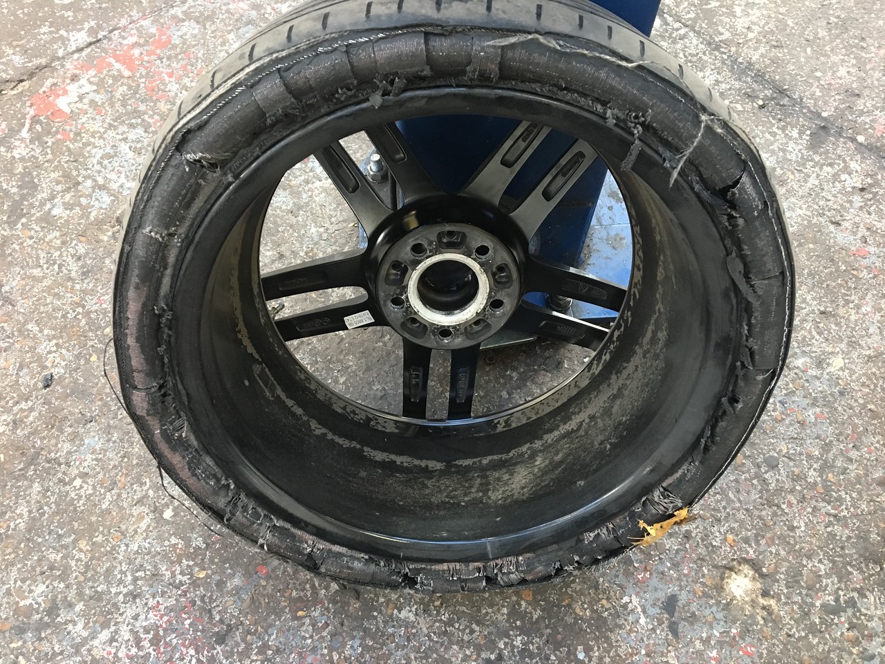

And this is the 4-5 seconds tyre alert to give me time to respond :wink:
It could have been a lot worse I had low profile run flat tyres fitted
