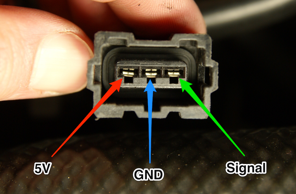

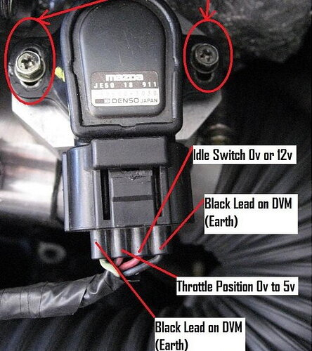

For reference, here are the two tps plugs. Manual 3 pin, auto 4.
I am under the impression that the Auto TPS is used for aftermarket ECUs as it is a variable one rather than just a switch. The later 1800cc Eunos has the four wire TPS as a standard fitment I have used one on my 1800 ITB car for a while.
so unless you are changing your engine loom I suggest you keep the four wire TPS and change the throttle body to suit.
