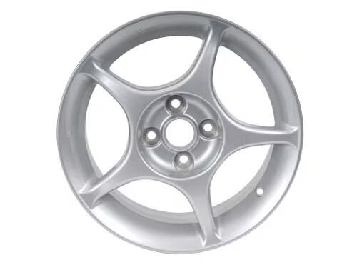

I also have a 2002 Sport on new last year OEM suspension, bushes, arms, Showa shocks, springs with all the nuts and bolts on 16 inch wheels and found this table, https://www.miata.net/faq/wheel_weights.html which shows one can save 1.5lbs a wheel by fitting the 2005/5 type 16 inch wheels.
I have since acquired a set and can confirm the ride feels a little less harsh on the newer wheels.
I did look into getting a set of Alutec 16’’ wheel but they turned out to be a bit heavier than the original Sport 16’’ 5 spokes.
Also found Michelin PS3’s feel like they have a little more grip than the Goodyear Assymetrics.
Hope that helps.

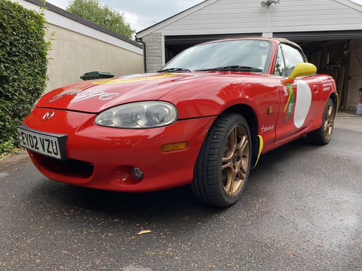

Go 15". Cheaper tyres and less unsprung weight.
A set of Enkeis as fitted to many MX5s would do the job nicely and they’re pretty cheap to get hold of now.
Then, wrap them in Nankang NS-2R semi-slicks. They may be pricier than road tyres, but you’re not going to be putting thousands of miles on them, rain or shine. :slight_smile:
