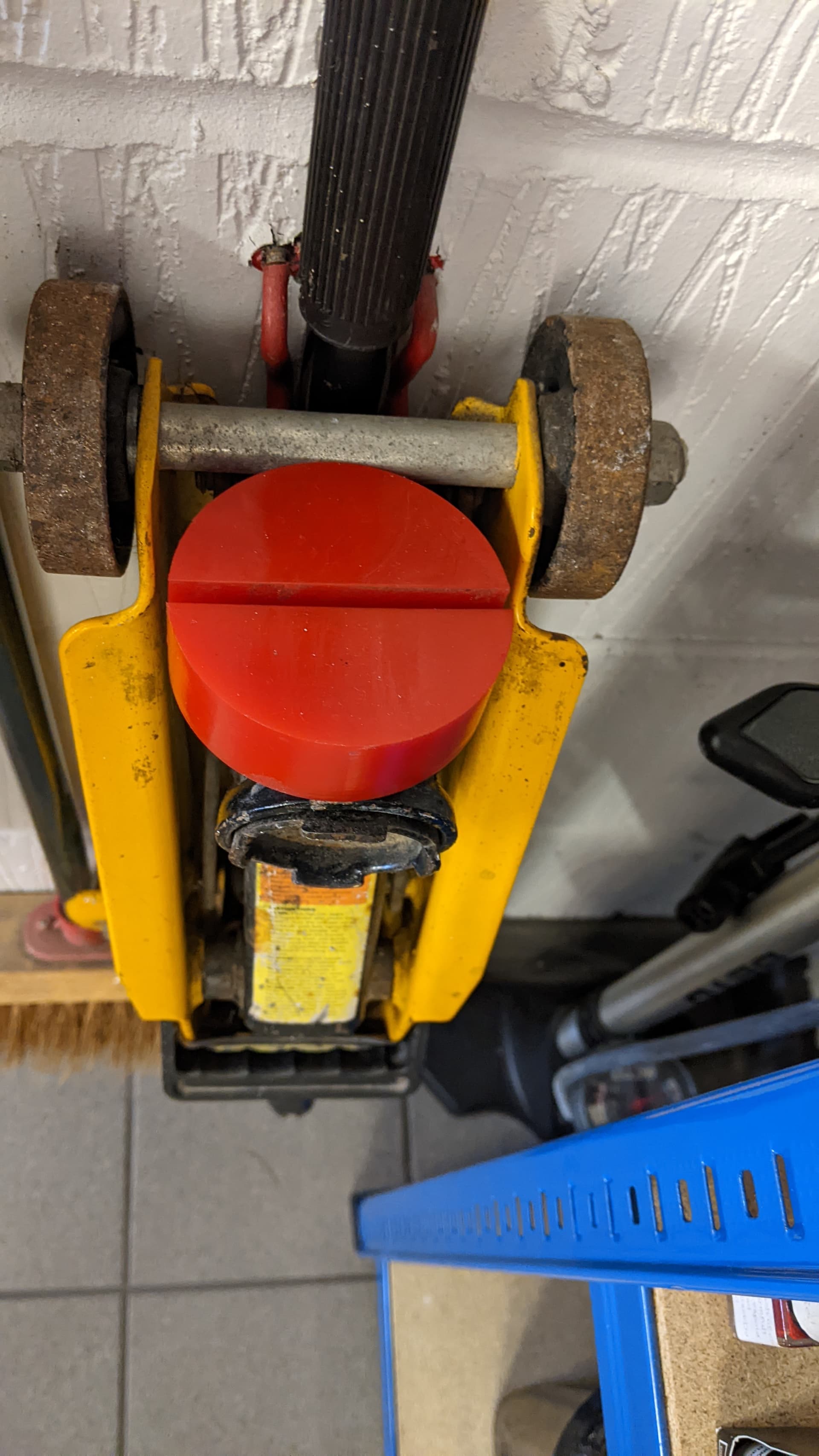

I use this, but it’s probably not much help to you, as it’s an old Halfords one.
You can buy slotted buffers like the red one shown resting on top of the jack, which allow you to spread the load around the seam of the pinch weld.

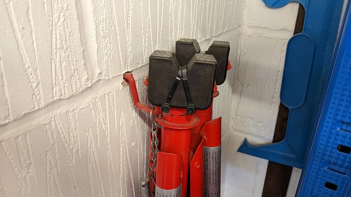

I improvised some slotted tops for my jack stands.
That, and the slotted jack pad were from Amazon.

The slit/slot is a little bit less than the pinch welded edge height. So that edge does take the weight, but is a bit cushioned, protected from denting, folding, scratching, and the load is spread along a good length of it.
The tops for the jack stands were too narrow for mine, so i cut the flange off on one side and secured with zip ties, as you can see.
There’s no lateral load on them. In fact, I’ve only used them as a safeguard, positioned right next to the jack, as you can see in the picture, while working.

The pinch welds are perfectly happy to take the load, but I recall I wanted to prevent any unintended folding force on them, by spreading the load along a good distance.
