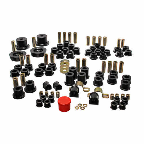

Would it be worth a full set of polly bushes?
Then take it from there?
And the can of worms as now been opened…“personally” from all the years of working on these and putting them right…rubber all the way…I am not a lover of poly from hands on fixing the aftermath it can cause, plus the ride on the road is harsh ,because our tax money pays for the so great super smooth roads we all enjoy.
M-m
Agree saving my sheckles for a complete set of the more durable and compliant OEM bushes which should last the better part of another 100k miles / 20 years on the road and the occasional bit of track work. If building a trailer queen for track only then the poly bushes ‘might’ be worth it, but then why not go the whole hog and go for bronze bushes and rose joints ?
