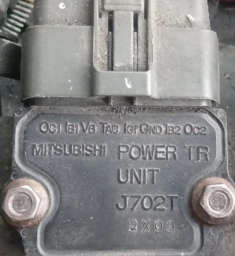

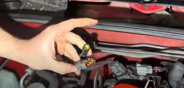

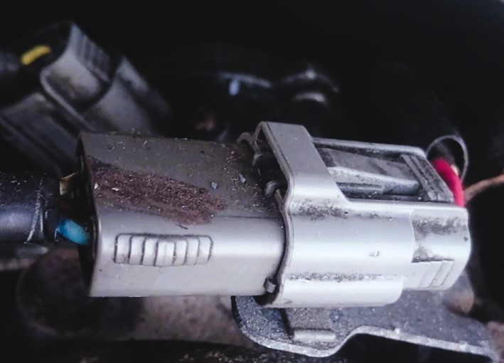

am i right i don’t have to pull the other connecter going into the CAS at the back? also, when replacing the coil pack, i’ve seen someone pull the 3 pin and another connector here: i don’t have to pull the one with the yellow centre do i?

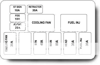

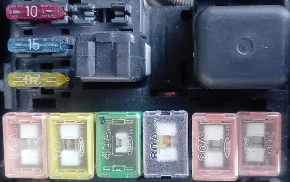

Fuel injector fuse. The Pink 30A in the main engine bay fusebox

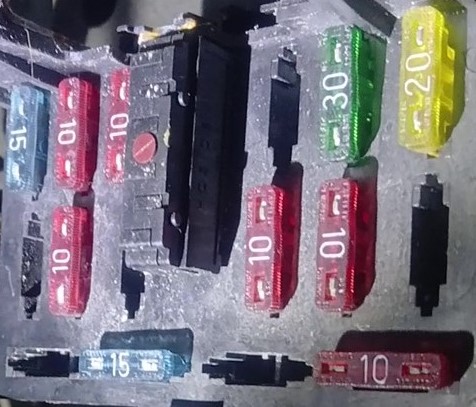

Pull and crank the engine until you start to see the oil pressure needle moving. Touch nothing else.

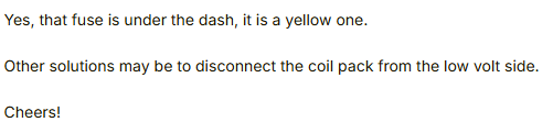

thanks! i forgot i have me diagram on the outside. ok thats that solved, as you say, i don’t need to pull any fuses inside. i’ll just tweak the question since that is solved. also, i found the post i mentioned before, from another forum, just gonna put it in here to show i wasn’t trippin. but we’ve established its the pink one.
