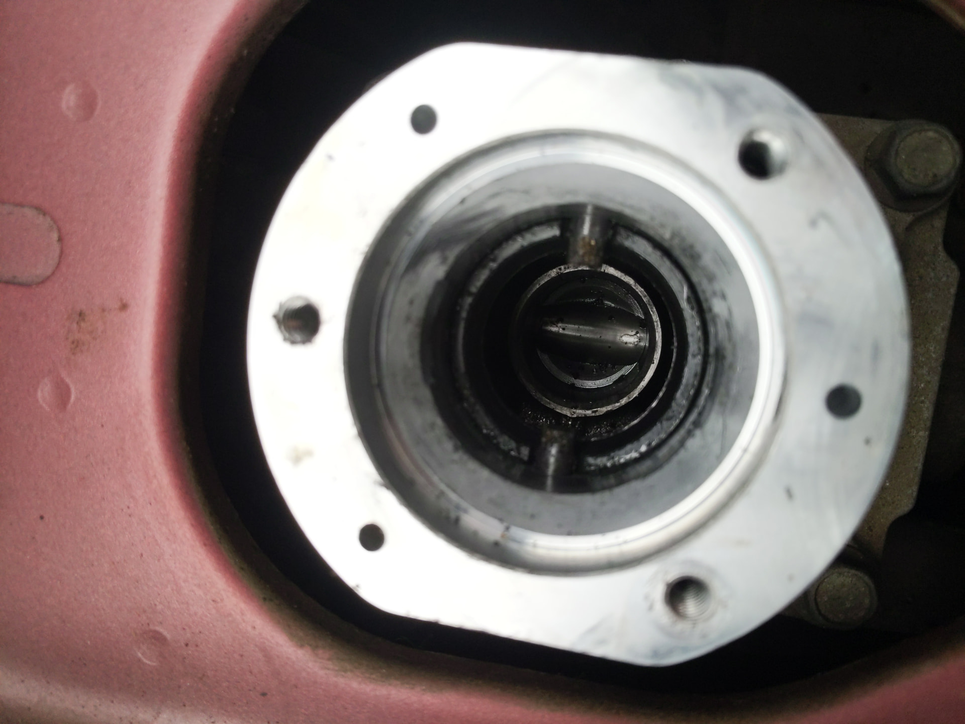

I’ve dismantled the top end, and this is what I’ve found:
  • The rubber boot is perishing leaving lots of crud in the turret, will order a new one
  • The turret was completely dry aside from surface grease that was black
  • The plastic lockout plate had definite signs of wear
My question is, does the NC2 need turret oil? If yes, does the previous recommendations apply; fill the turret to the bottom ball and grease the upper ball?
Yes it needs turret oil and grease on the upper ball pivot. Don’t fill the turret to the top, any oil will do btw but gear oil if you have any left over from a service.
About here in the pic below the fill level should be, no higher.
For the avoidance of doubt, that’s just above the selector cup, correct?
I’d probably be syringing a little out in the picture shown. When the stick shift is refitted the oil in my opinion should just cover the cup on the end.:+1:

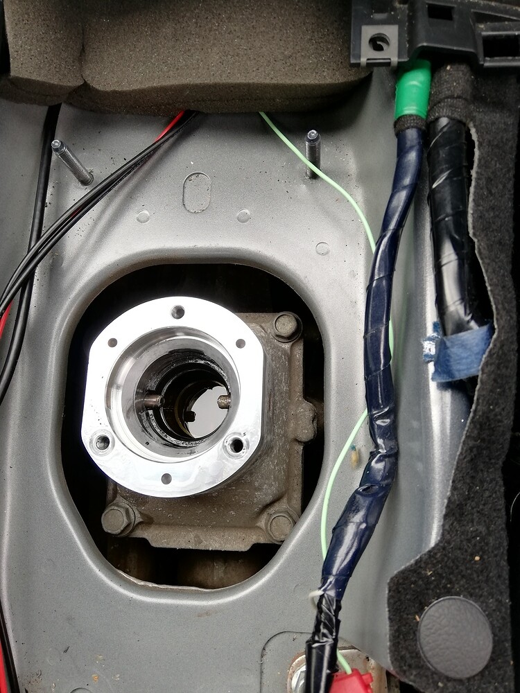

I finally found some time to do it and found that it was completely dry!
Surprisingly, the plastic bush at the bottom of the gear lever/shaft is still in very good condition.
It’s apparent that the gear lever hasn’t been removed since it left the factory.

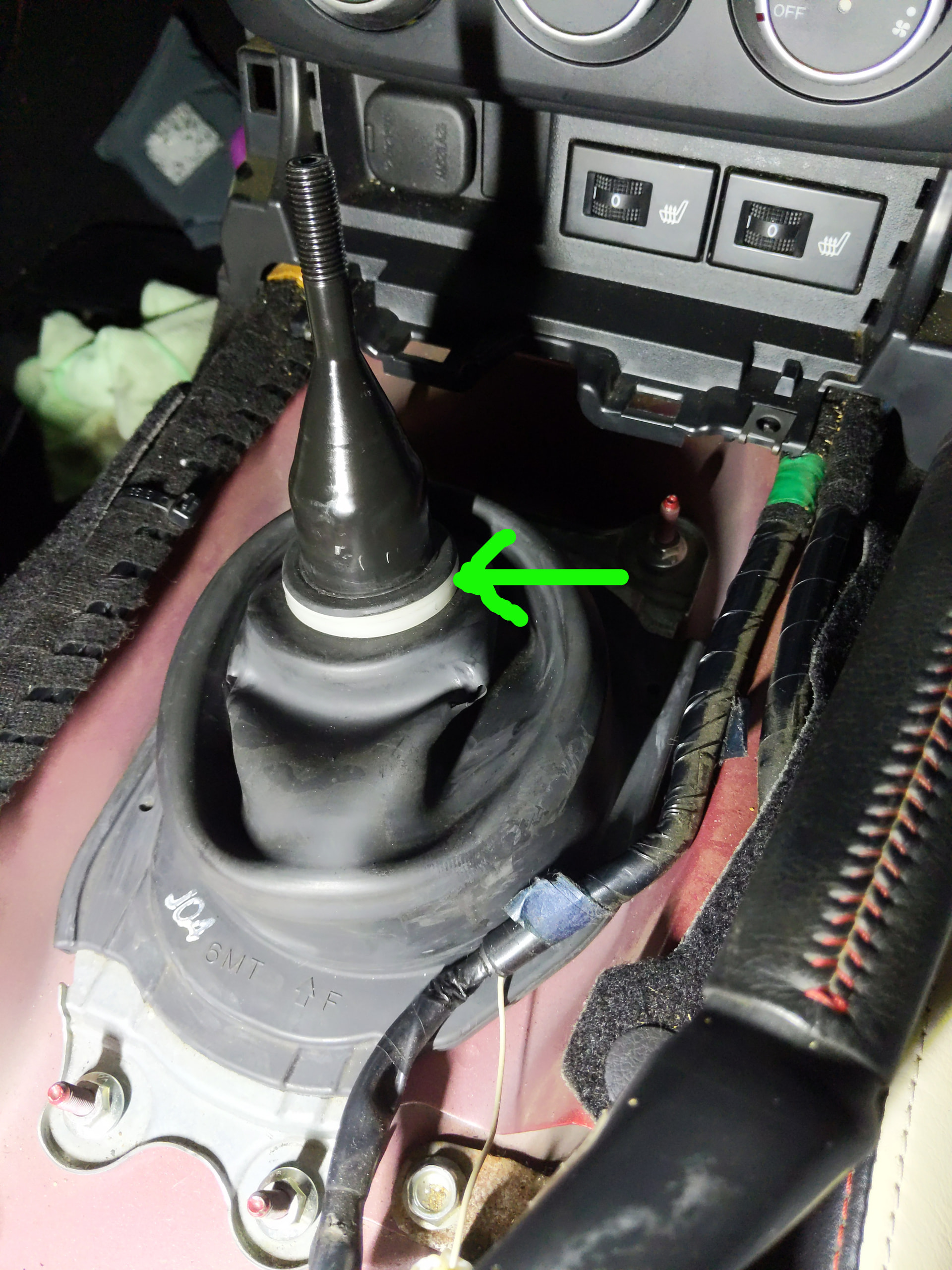

Once the centre console is off, remove the four bolts securing the metal plate.
Please note that the rubber boot comes off together with the metal plate and that plastic white ring (arrowed) just needs to be pulled up, off the shaft; no need to cut it off!

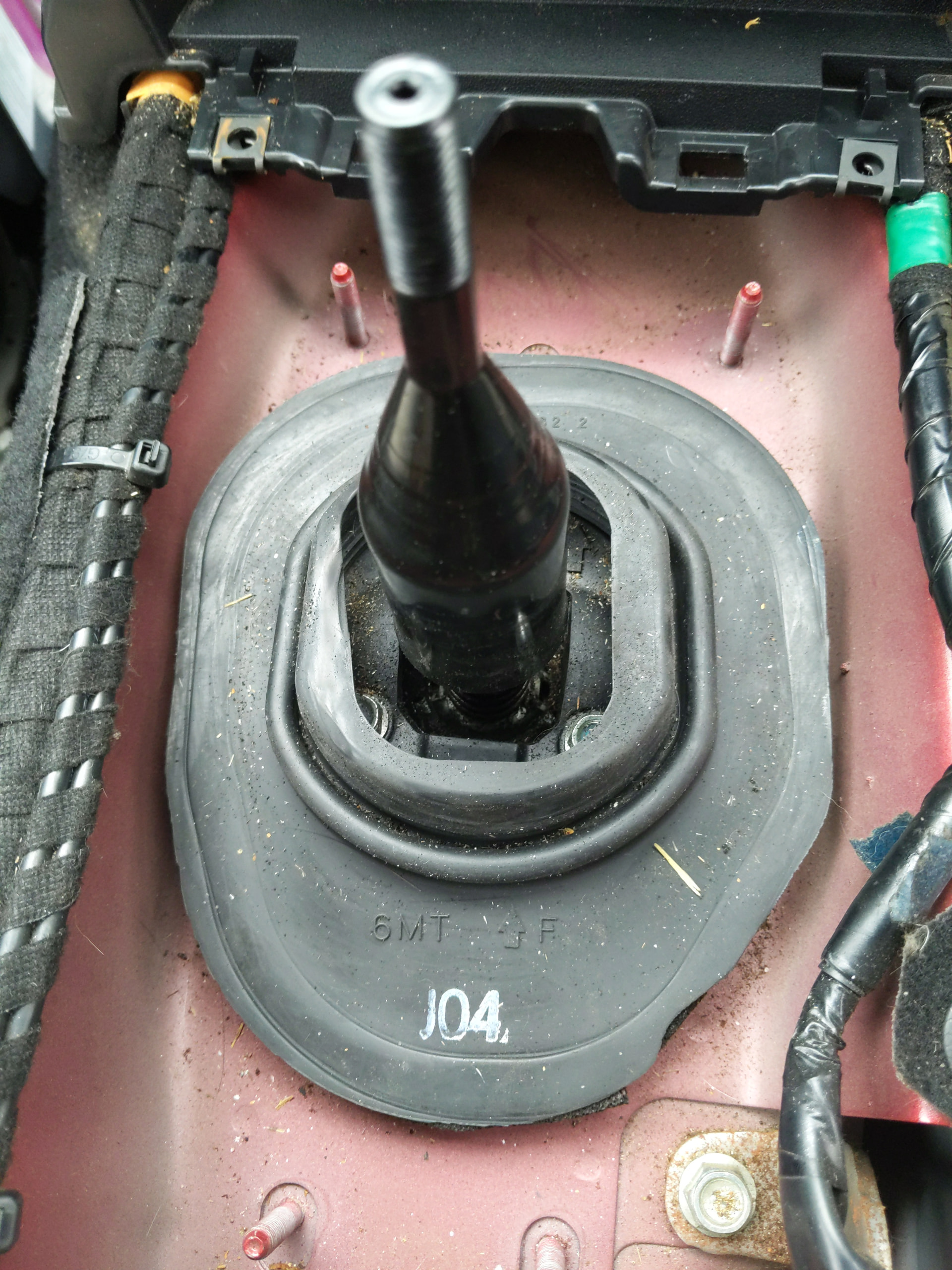

Also note that there are 4 slits on the rubber boot; these seem to be there originally, possibly to help the rubber flex and fold and to stop it tearing???
This second rubber boot just lifts off.
Then simply remove the 3 bolts securing that black plastic plate and lift off the shaft.

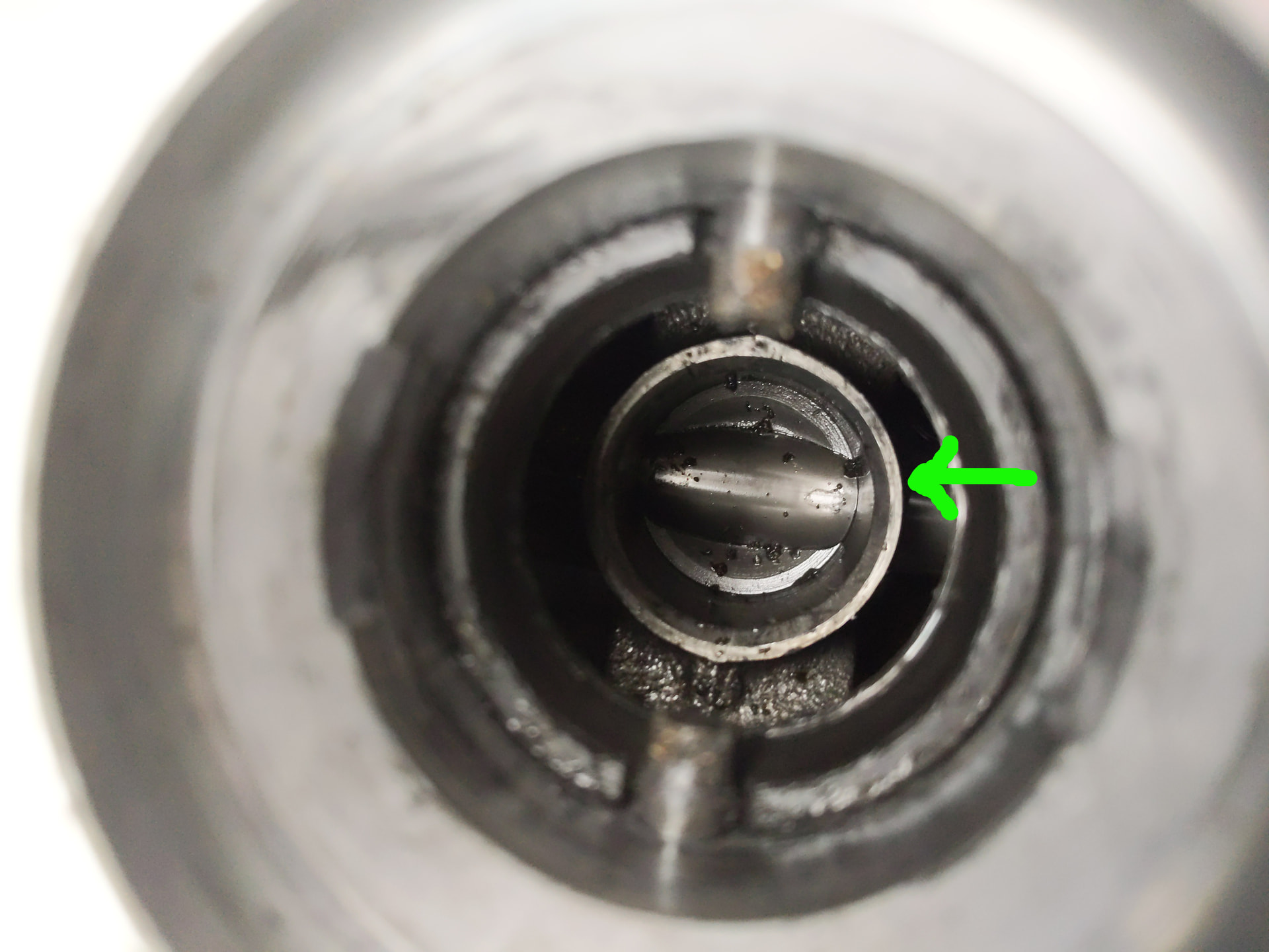

This is what I found; bone dry!
Gave it a good clean and refilled it up to that green arrow with leftover gear oil.
Some lithium grease on the ball pivot and re-assemble.

I had some oil left from when my gearbox was last serviced, (Red Line MT-90 GL-4) so I just used that. It took about 150-200ML; I didn’t measure, I just poured it in until it was level with the top of the selector cup (where the green arrow points to); any more than that and the ball pivot will be in the oil, which isn’t necessary since the Lithium grease will lube that bit.
The slits are not in the rubber boot by design, they are there because the boot is old.
