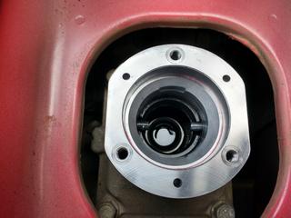

Turret oil.
It’s still there in my 6 speed NC
A couple of years ago I topped up the gearbox turret oil, it looked dry when checked.
So an update on this as in another thread it was asked if it needed any and I was curious to know how it looked now

Nice one Mick and presumably the general gearbox level is sufficiently lower as it certainly appears to be.
I think the turrets(MK1 - MK3) all work on the same principle where the oil that overflows the turret goes into the gearbox.
In that case if you are changing gearbox oil, sensible to clear out all existing turret oil and clean turret before starting to fill through the turret until turret overflowing and then top up through usual gearbox filler port until correct level achieved.

The only gearbox i know of (MX-5) that you can fill through the turret is the Mk2 6 speed, I’ve done it myself. As far as I’m aware if the turret takes oil it’s completely separate to the box itself on the others.

Well my 1.8 5 speed Mk3.5 had oil in the turret. When I changed the gearbox oil I sucked out the old oil in the turret and put fresh oil in there too.

My post above was just to clarify if you put oil in the 6 speed NC turret it stays there and doesn’t drain down into the box. Agree there’s some conflicting views on this and nothing in manuals apart from the one stated by the owner below.

Checked mine today as the change felt a bit stiff, it was filled to the brim! looks like the oil had washed away all the grease on the top fulcrum ball. Definitely worth checking :+1:
