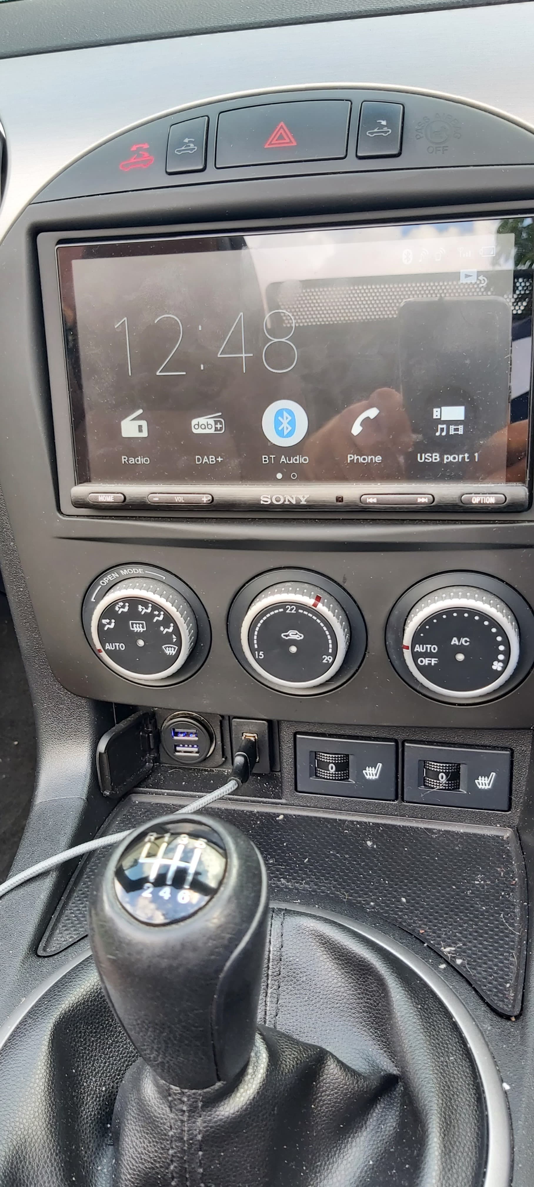

Ive been using a Baolongking single usb socket for a year with out any issue’s, the other usb is in the glove box with a memory stick with music on. Sounds as if you have a faulty connection.
Thank you for the info and picture. It does appear the connector is faulty in my wife’s Astra. So, ordered a Baolongking single usb socket which I will install in the Glove Box for the phone connection. Also ordered a LBSC USB 3.0 & HDMI Flush Mount Cable, USB Flush Dash Panel Mount Cable which I will mount in the Glove Box. Question, where in the glove box did you mount the Panel Mount? I assume your glove box rotates like mine so a bit bothered about chaffing etc.
The Sony supplied USB cable is loose in the glove box with a memory stick plugged in, its works well. The Single usb socket fits perfectly along side the seat heaters. Does this help?
