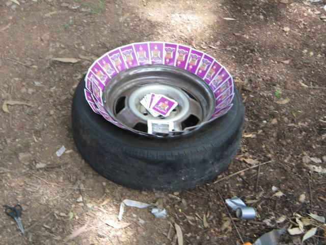

Not sure if this is what you meant by tyre protectors but loved the idea & think playing cards can be bought fairly cheaply
http://www.mx5oc.co.uk/forum/forums/t/25199.aspx?PageIndex=123
Have a look( last page) see what you think
You can sand off overspray from tyres, or use claybar. Some will use playing cards as a mask.

PM me your address and i will post you four You will have to let the tyres down to fit them . But the whole tyre will be masked.
