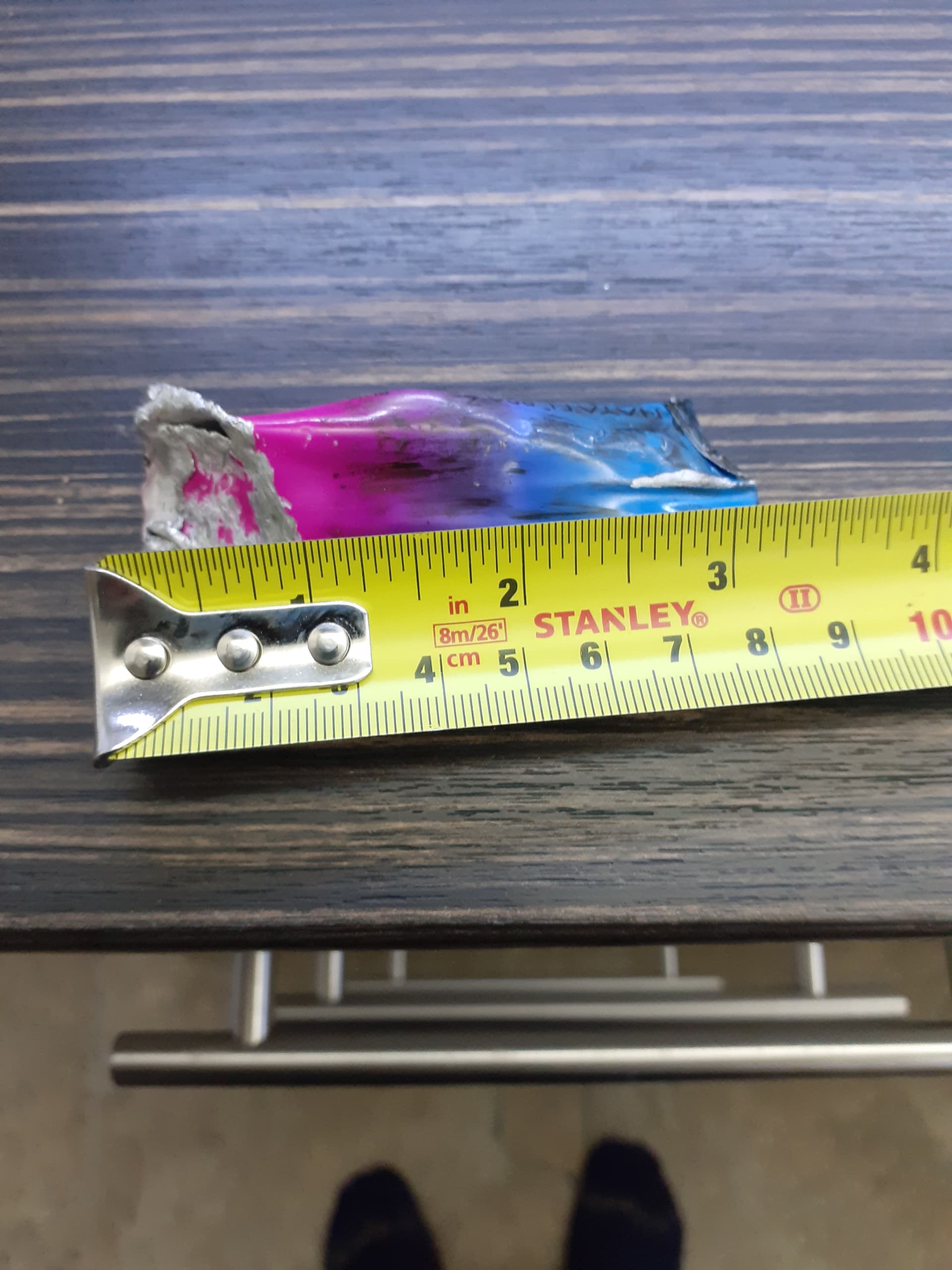

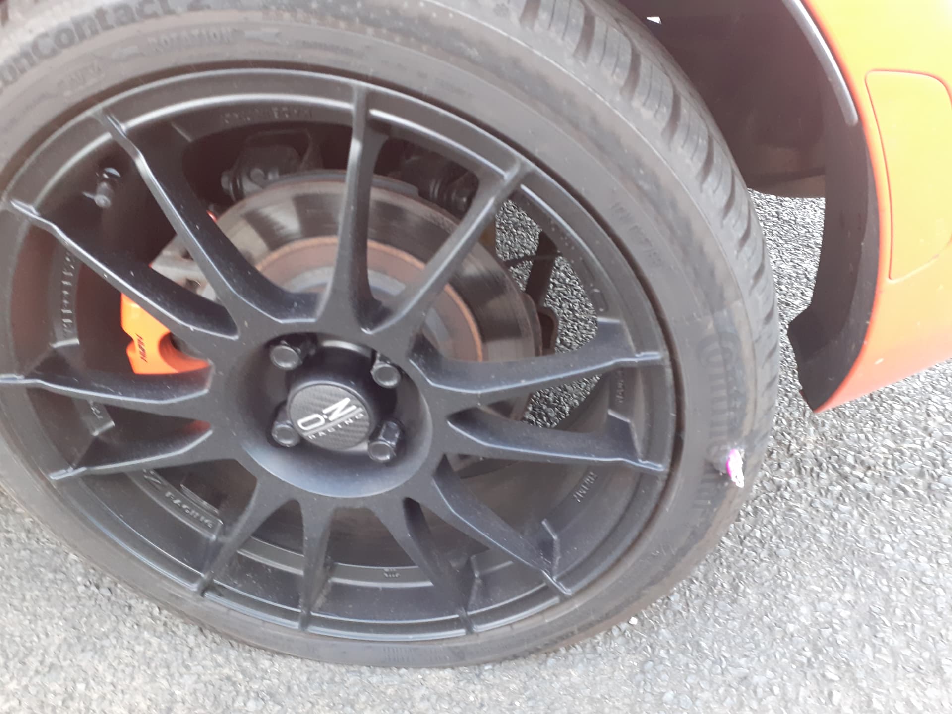

I was just reading this and thinking that I should get something sorted for my car and thinking I’ve never had a puncture in over 40 years driving. This happened yesterday. I realise foam wouldn’t have helped
Thanks blue razz gummy bear vape :enraged_face:
