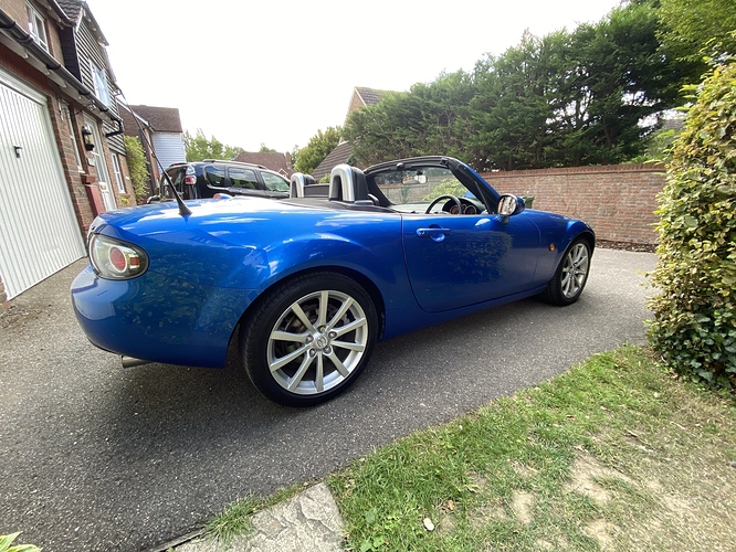

    Just upgraded from 205/45,s to 215,45,s
    All seems good and the 215,s were cheaper
    Went for ps 4,s again
How do they compare for diameter, width and aesthetics ??
Slightly wider,seems to drive better but also look better
Cheaper too, so win/win :slight_smile:
