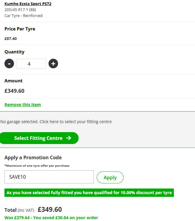

The newer PS72 is out now - £95 a corner on Blackcircles, with a further 10% off currently:
Yep, that’s what I’ll be ordering. :blush:
