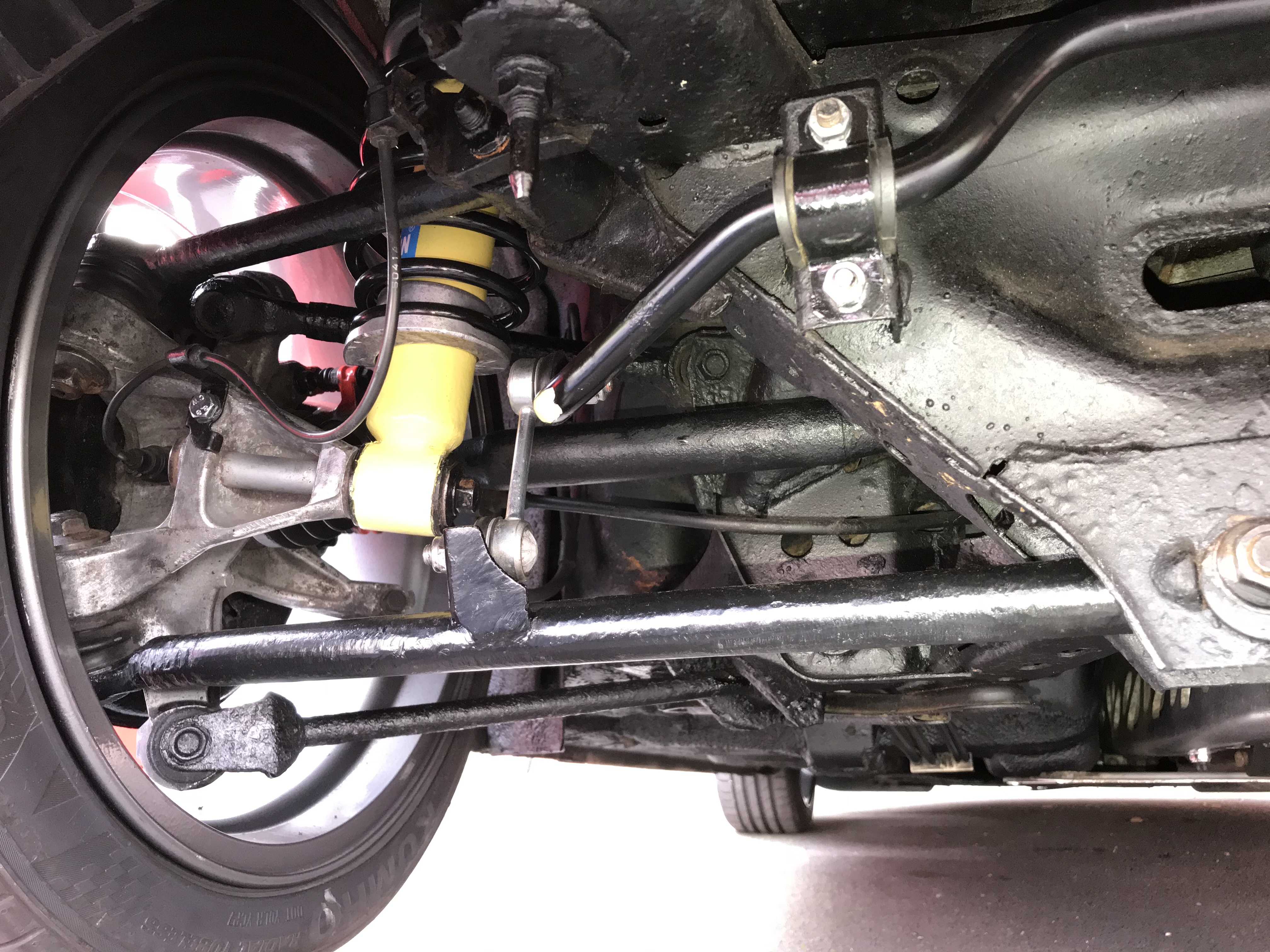

I, like many, have done this myself. Not all in one hit, but over a period of time. Guess the secret is in prep, a good wire brush on a drill, remove surface rust then treat with rust converter. I then used a Waxoyl based black under seal and the waxoyl itself in cavities. It’s quite a rewarding job and the undersea sets nice and dry. I got all the kit from Halfords.
Can’t comment on other products but feel I achieved a nice job. It also gets you well acquainted with your car.

It looks like you’ve made a good job of it well done.20 years ago I would have done the same thing , but my bones are a bit to old now . :rofl:

Dosthilldave, excellent job, were you over a pit /garage ramps or jacked and supported at home?
Thanks guys for your time will let you know pricing Monday :sunglasses:
Up on axle stands. Had it there for a week with wheels off. Ached like no-ones business after every session…
