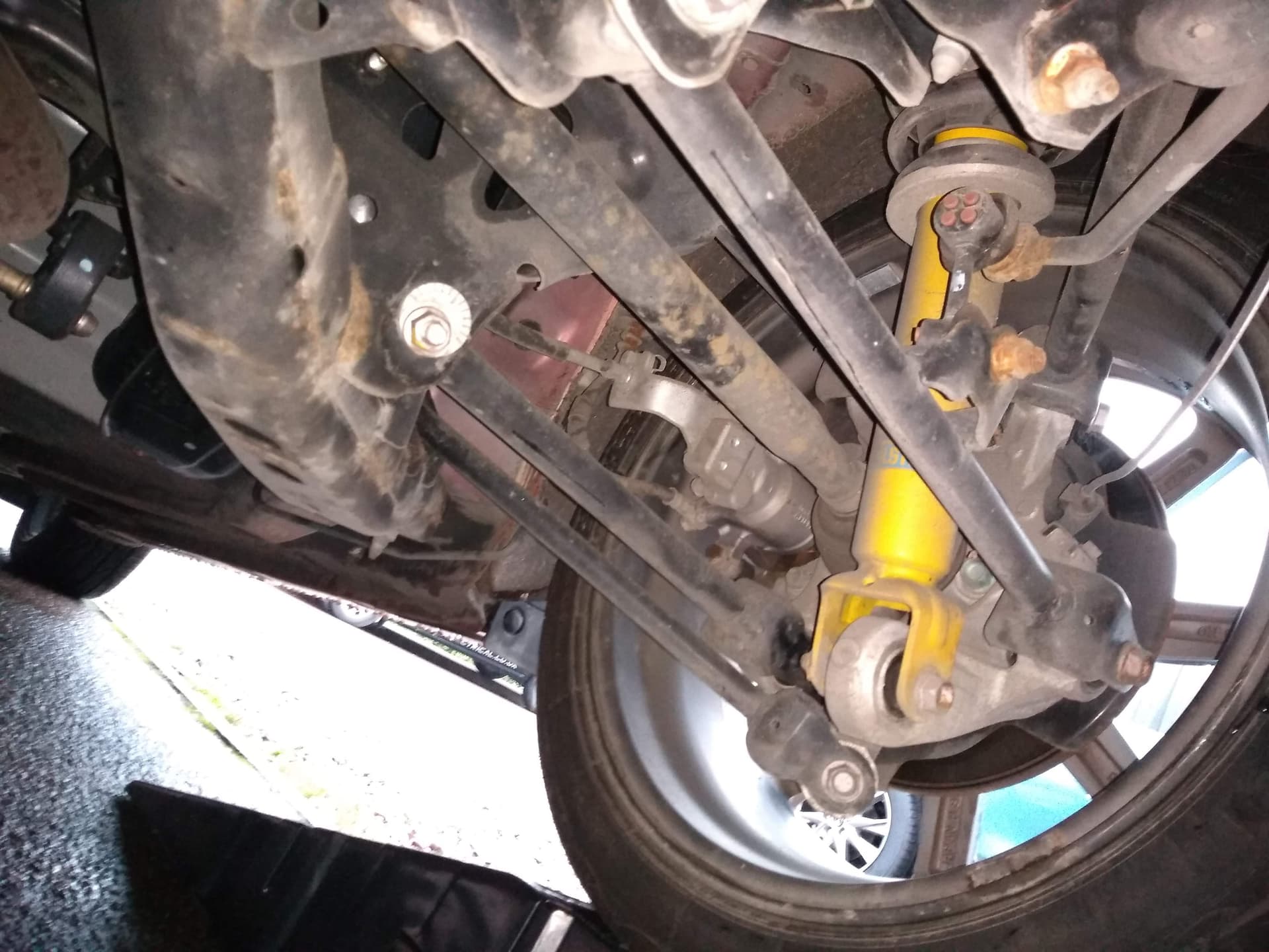

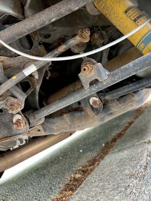

Had a look around the car (as one does on a Saturday morning) and noticed some surface rust around the underside at the rear end. Certainly nothing that I’m worried about but it’s started me thinking about some sort of underbody protection. Is it recommended and has anyone done it on an ND?
If required, I might have a go at it myself, but anyone know who does it in the North/West Yorkshire Area? (I’m based in Skipton).
Here’s some pics:
Hi , I have a 2018 RF and I have had mine done . There are some bits the factory appear to have missed and it is too good a car to take the risk!
Be worth doing that to catch it before it gets worse. Looks like it’s been driven through winter a couple of times.

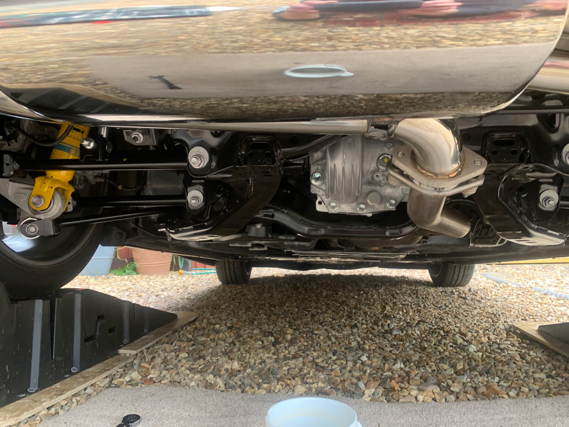

This was mine at 3 years old

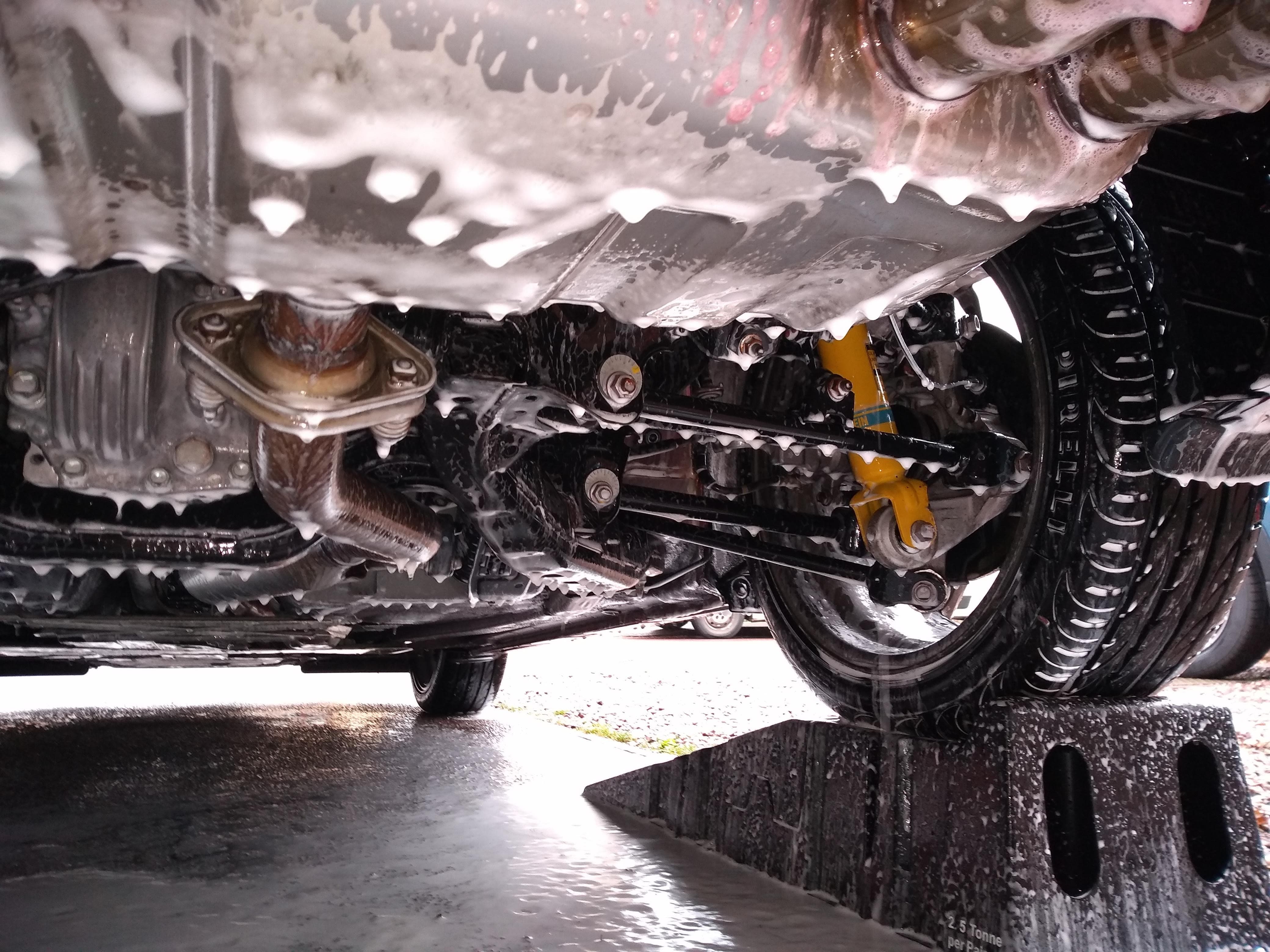

Then after a pressure wash on the race ramps
