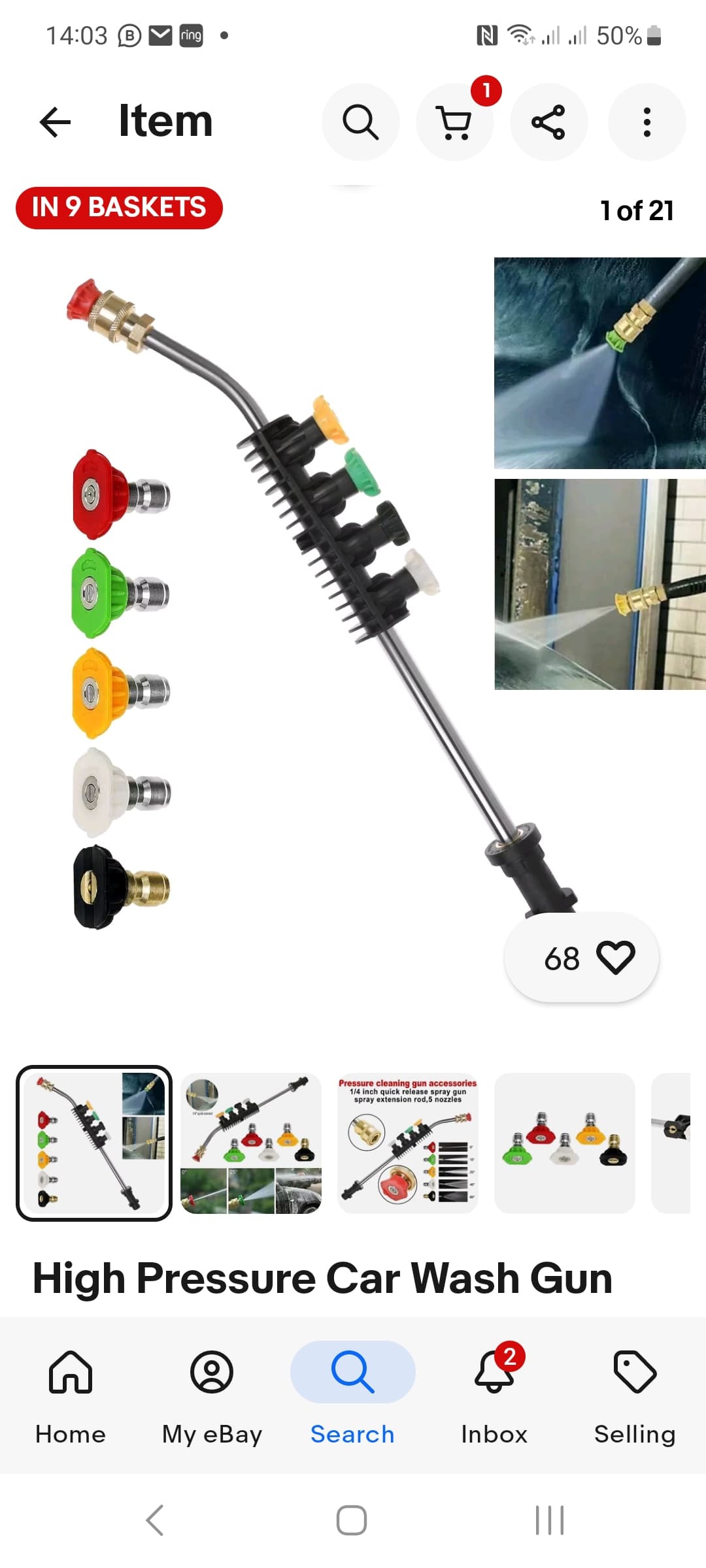

I use one of these off ebay ((£10) for under the car and the wheel arches, plenty of other uses around the car and house with the variety of nozzles provided.
…just be very careful which nozzle colour you select! :face_with_peeking_eye:
Which model did you get? Their heights (as described on Amazon) look a bit misleading and, of course, they need to be low profile enough to actually get under the car…
