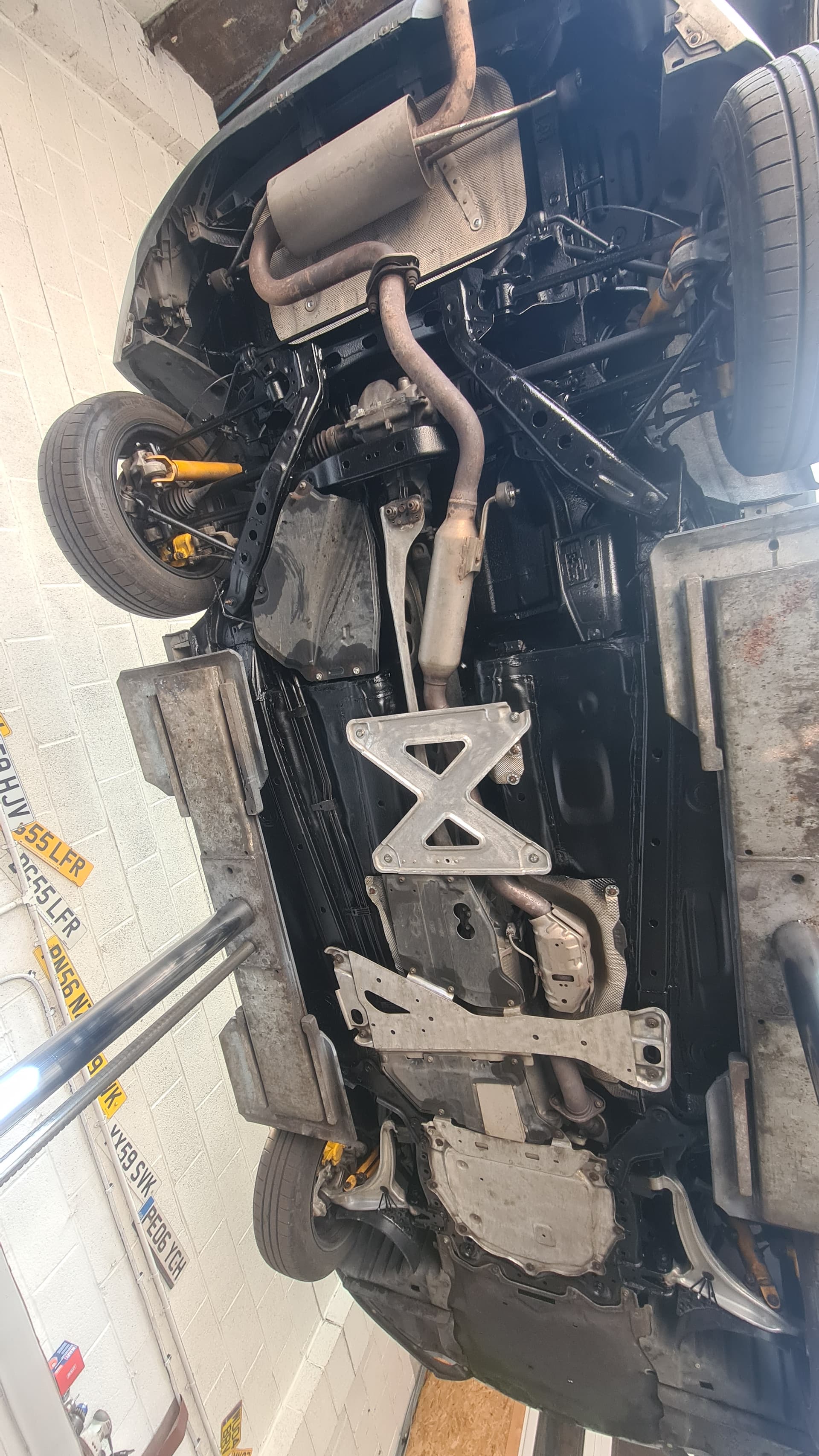

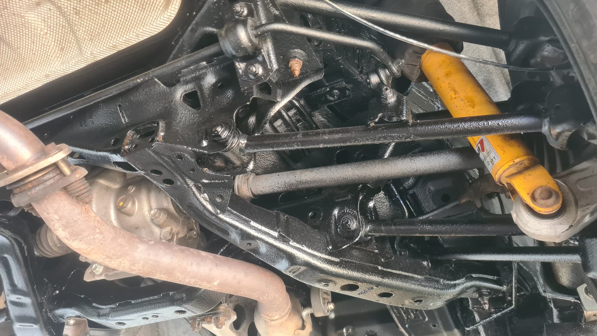

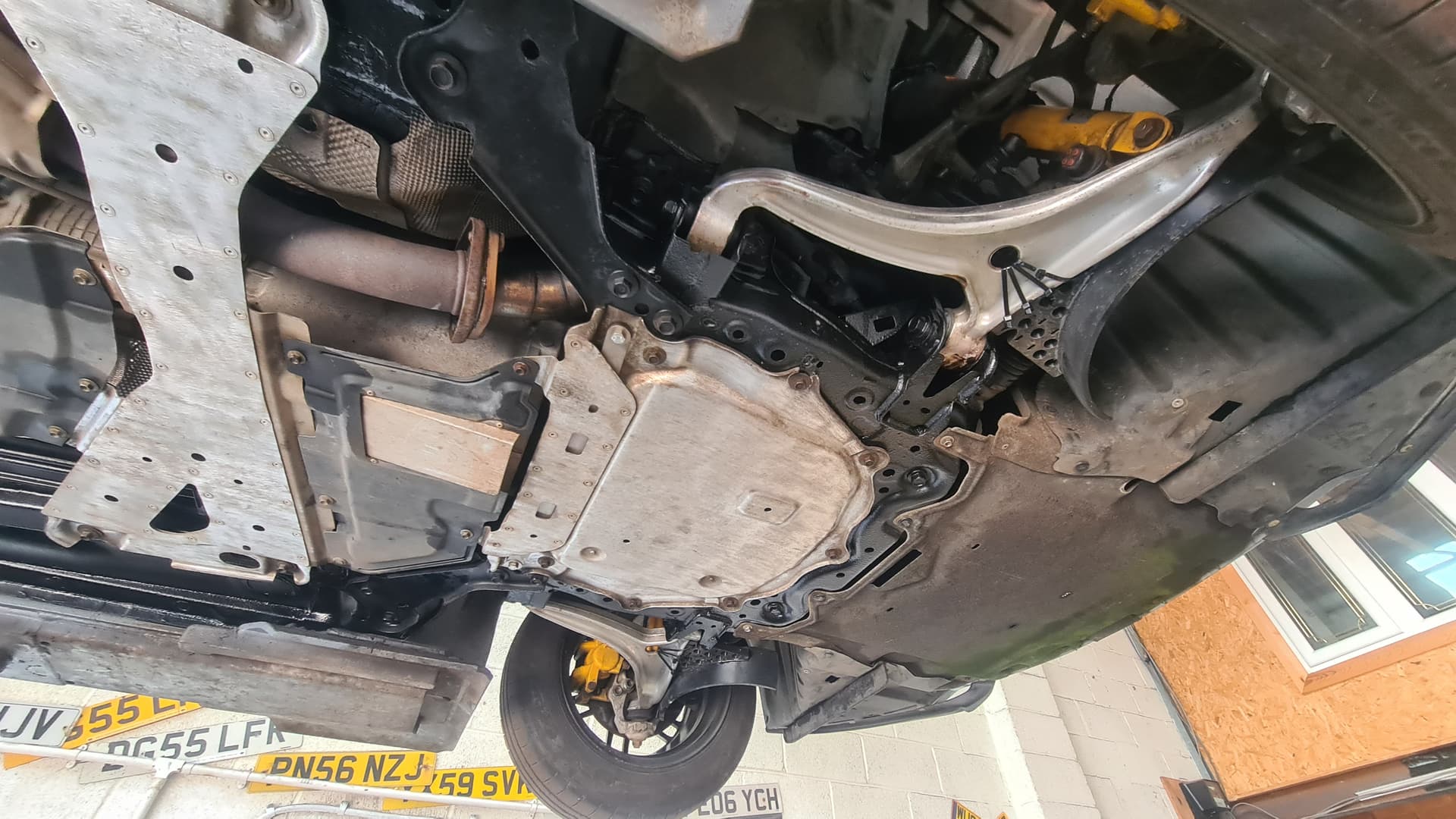

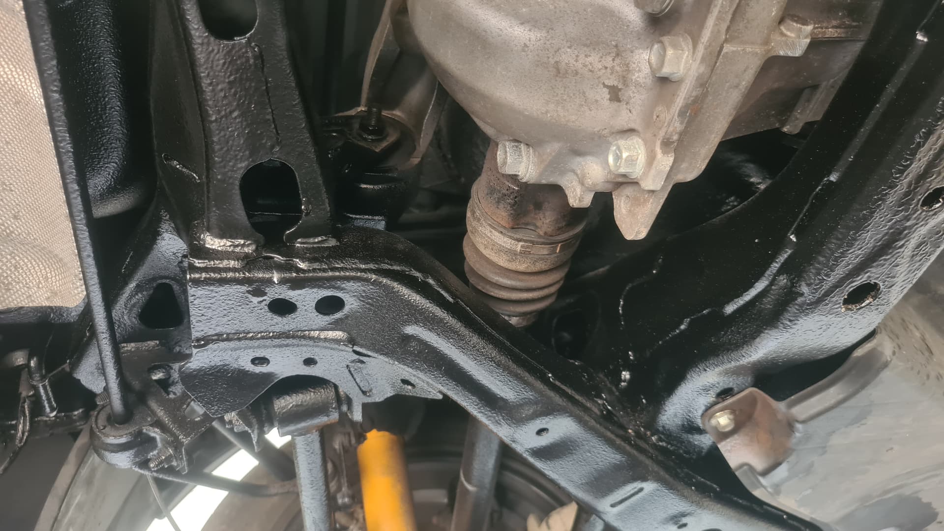

Yup that’s an ND, wow! Mine has had a relatively hard life and is a Sept 2015 car, yet nowhere near as bad as that.
Recently had it all brought back to bare metal, rust converter applied, 2k primer, top coat, cavity wax etc by Aaron at MX-5AVAGE in North East Manchester and it looks better than new. Top job.
You managed to restore it to that quality? That is impressive. I bet it cost a lot.
Not personally, but yes, Aaron did a fantastic job, very well priced at £1000 all in.
A grand!!
That is what I was going to say. £1000!? You have spent loads on your MX5 in terms of modifications too.
The end results are great though.
Does the undercoat need topping up now and then?
Cheap? Expensive? I’m never sure which side these responses fall ![]()
This was a “proper job” - going back to bare metal and following a 3 stage re-coating process means it it chemically bonded to the chassis / wishbones / subframes, and only needs future work should it be mechanically removed. The work took 9 full days of labour in total, so isn’t comparable with a £300-500 two day method of coating everything liberally in Lanoguard etc that needs re-doing every 12-18 months ![]()
Do it properly or don’t do it at all.
A cheap job will only hide what may lurk underneath and make it worse, I know from experience on my old Civic.
Yes, fair points.
