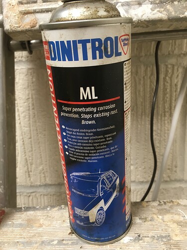

I donāt like covering everything with under seal as it looks horrid. The places that do rust easily are the cills. Wheel arches and frame rails, they rust from the inside out. Using a thin cavity wax stops them rusting but you need to be thorough injecting the cavities using a 360deg spray tube. Dinitrol ML is my choice as you donāt need a compressor a garage spray equipment. Itās very thin and creeps into tight weld seams which is where rust starts, 4 cans is enough for an Mx5.

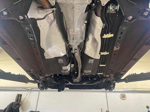

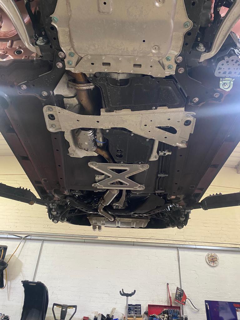

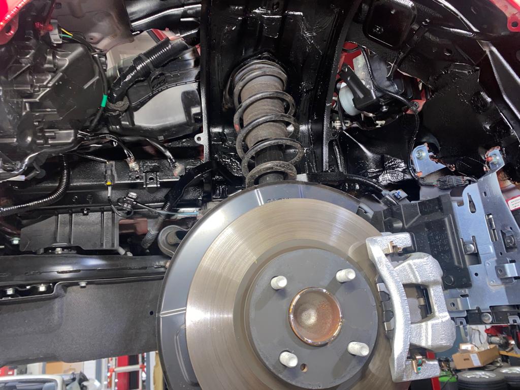

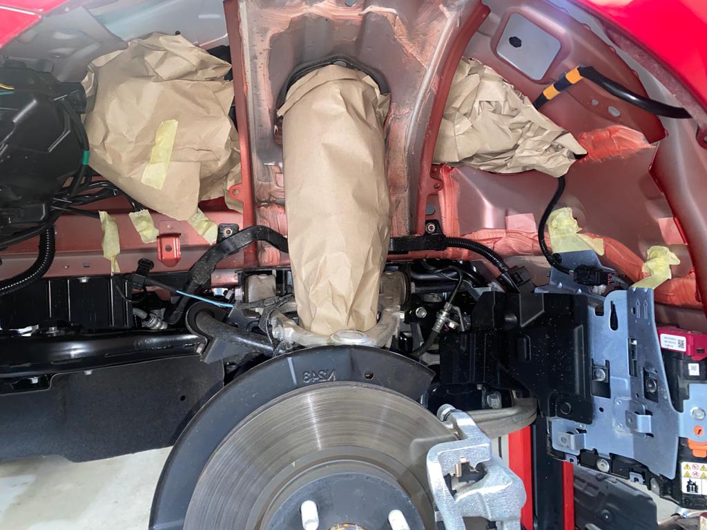

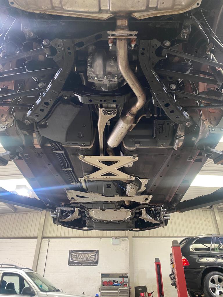

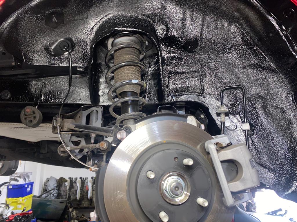

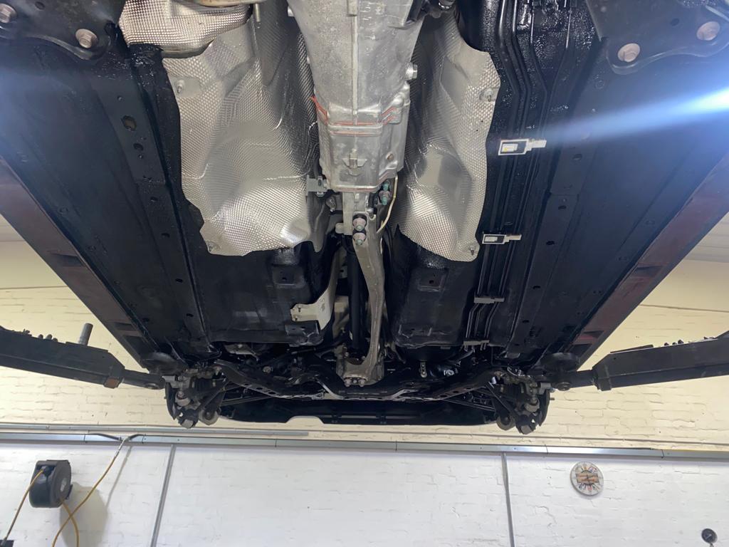

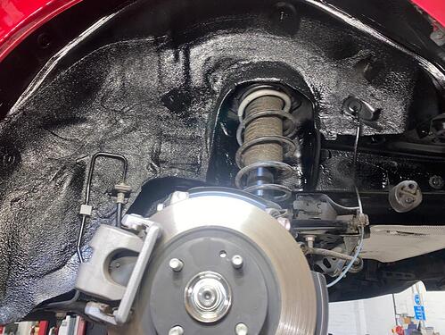

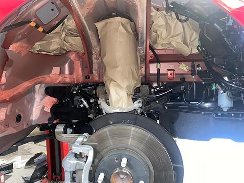

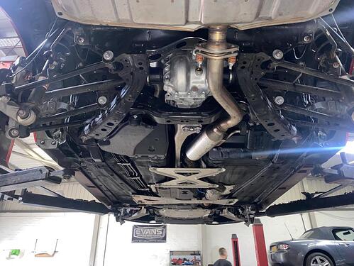

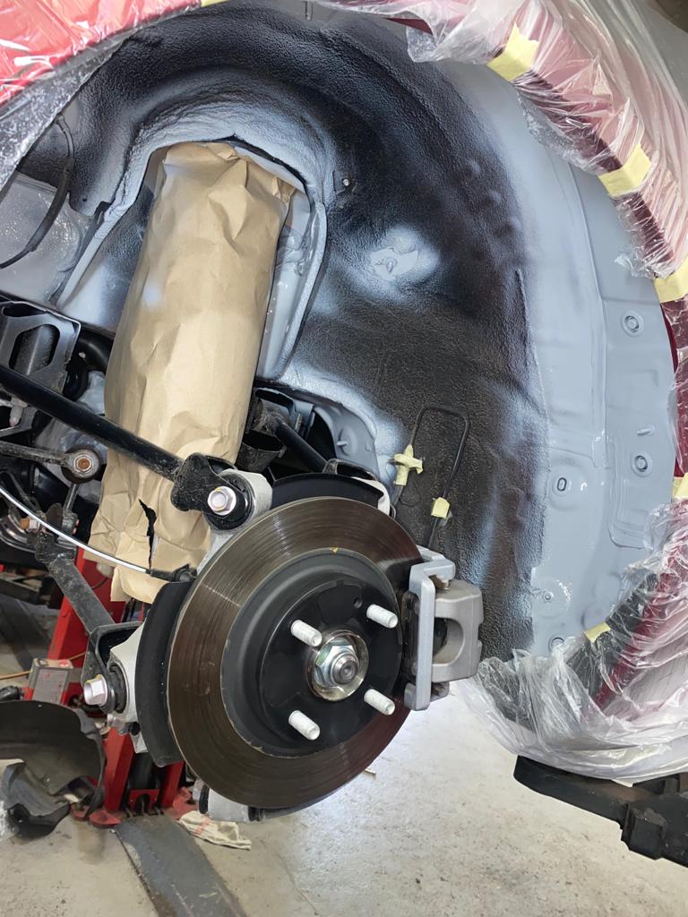

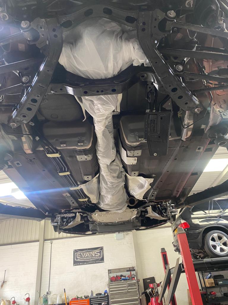

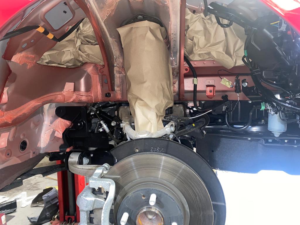

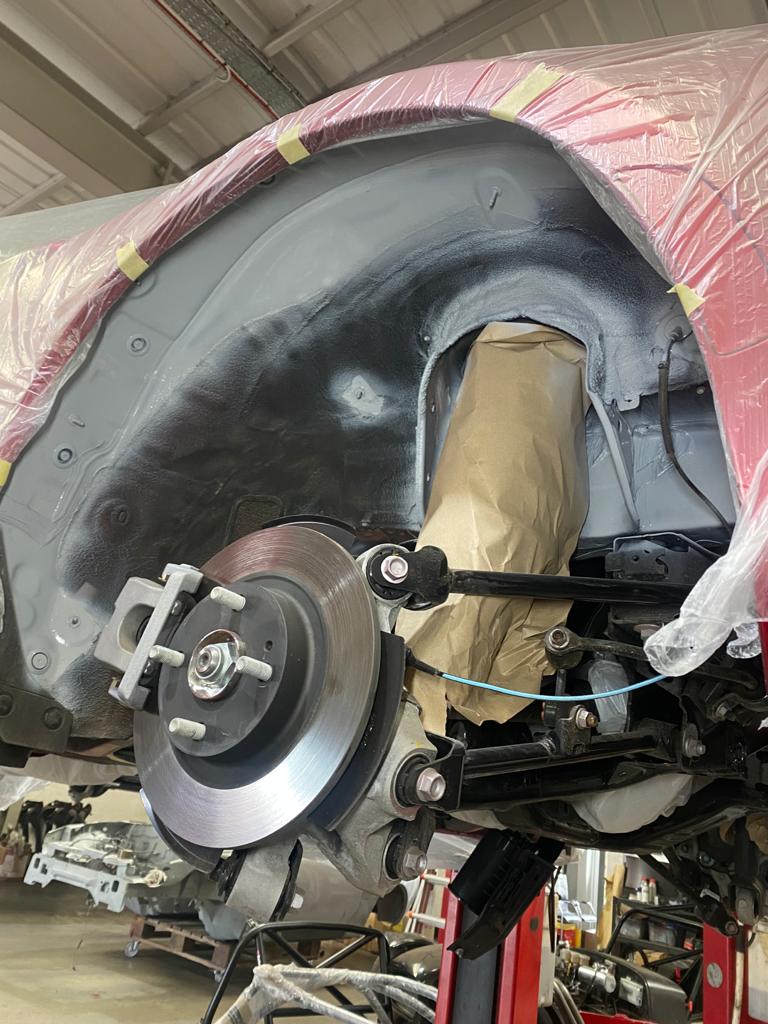

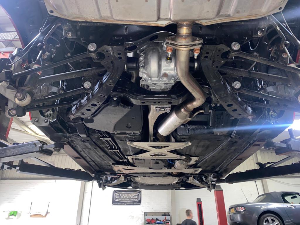

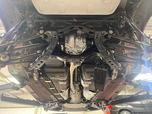

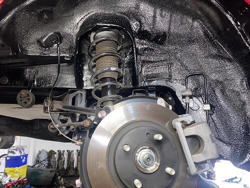

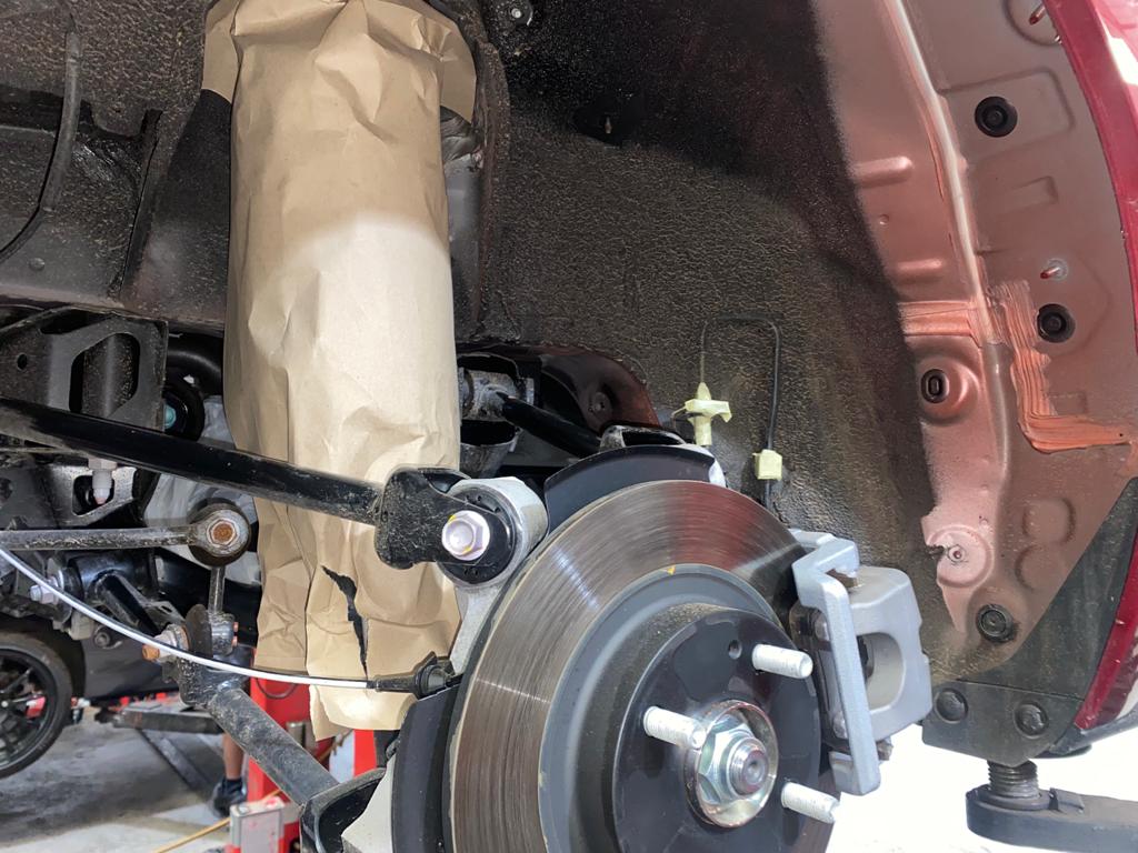

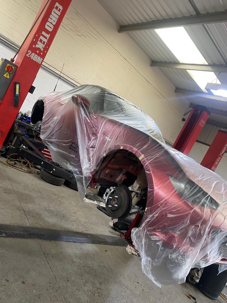

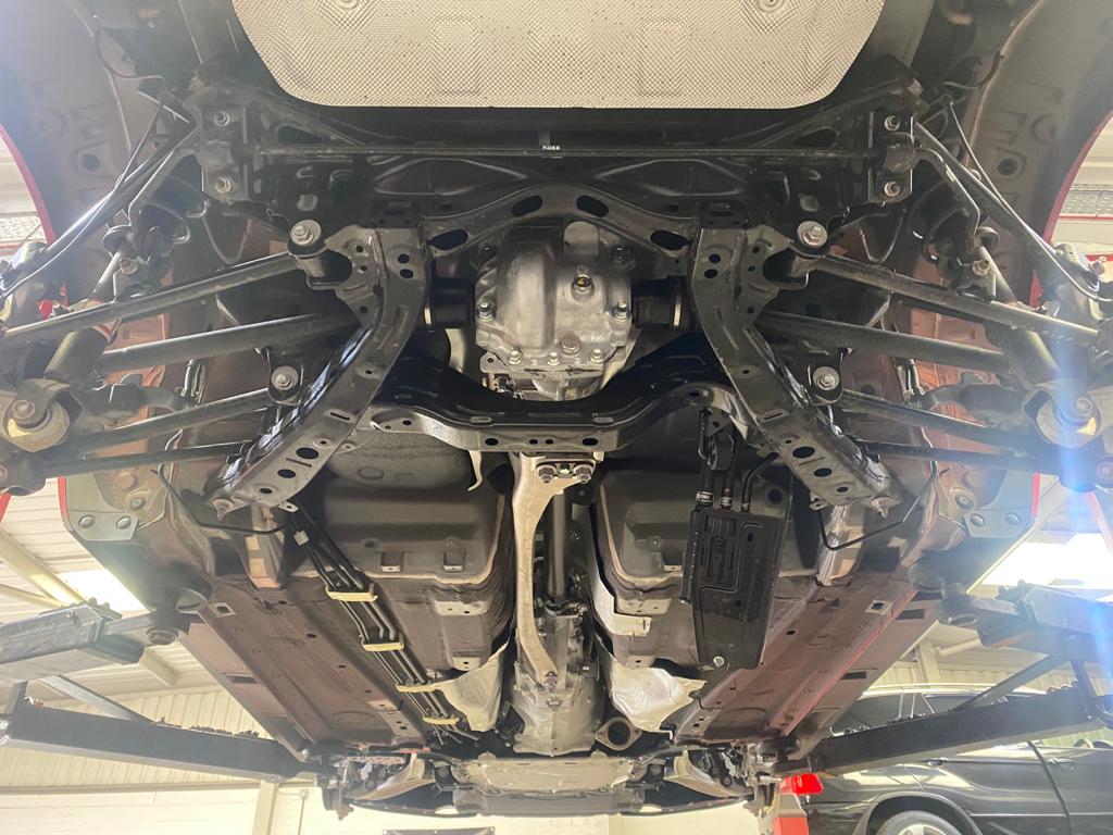

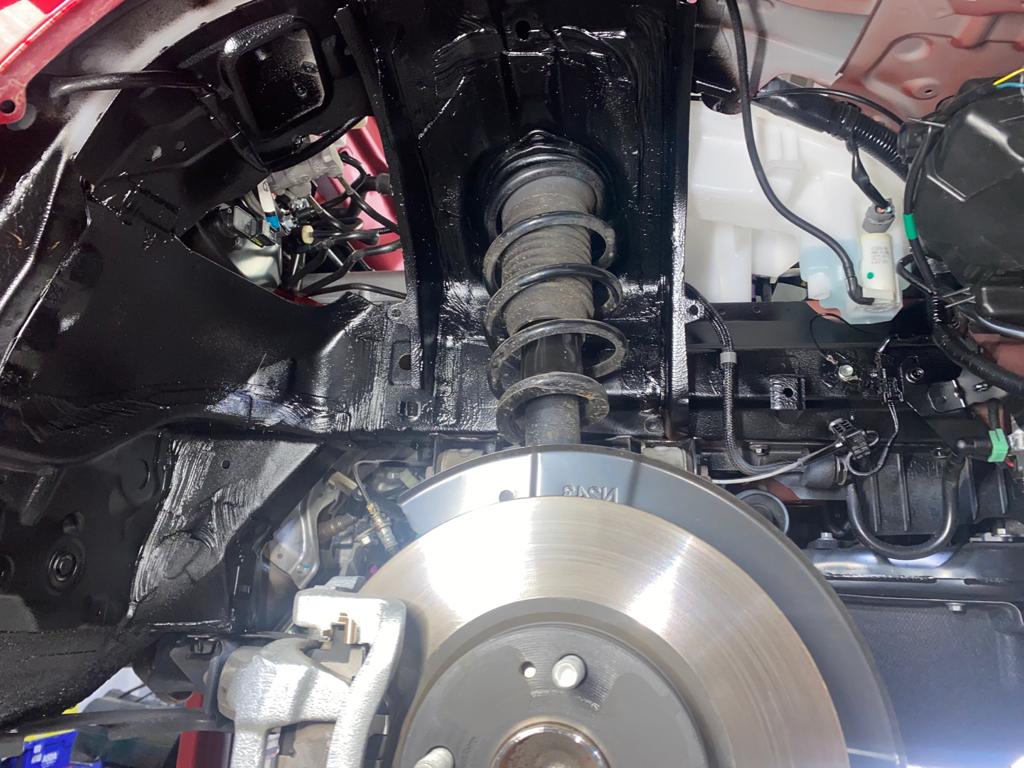

Hereās a few pictures of the Dinatrol application on my Nd picked up yesterday. From the before and after ones (you can see which is which) you can see how little protection there is once the wheel arch liners are removed. The work was done by Thrussington garage near Leicester who I can thoroughly recommend as per previous posts on this forum. There was significant attention to detail, which I doubt Iād get from a non mx5 specialist.
A lot of detailed masking is performed, including gearbox diff prop shaft. The exhaust , wheel arch liners and rear bumper are removed, some key areas etch primed. Followed by application of the dinatrol including inside subframes etc. where necessary. Need to leave it for 48 hrs approx with them partly for the dinatrol to dry.
As you can tell Iām of the do it camp !
