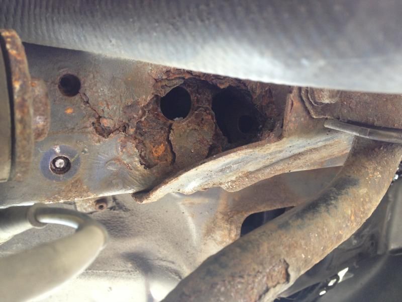

If you have followed the quite long thread on this topic, you will see that quite a few MK2.5s and some Mk2s have been suffering advanced front chassis leg corrosion, near the front anti-roll bar mounting and subframe attachment points. And this can affect cars less that 10 years old (average age of a car on scrapping in the UK is 14 years, average age of a car on the roads in the US is 11 years, so the popular “cars are only designed to last 10 years” has no basis and is complete bunk). The corrosion can only be seen once the engine tray has been removed, so is not spotted during a MOT and so potentially, the cars could suffer catastrophic failure during drivng. Engine trays cannot be removed during the MOT.

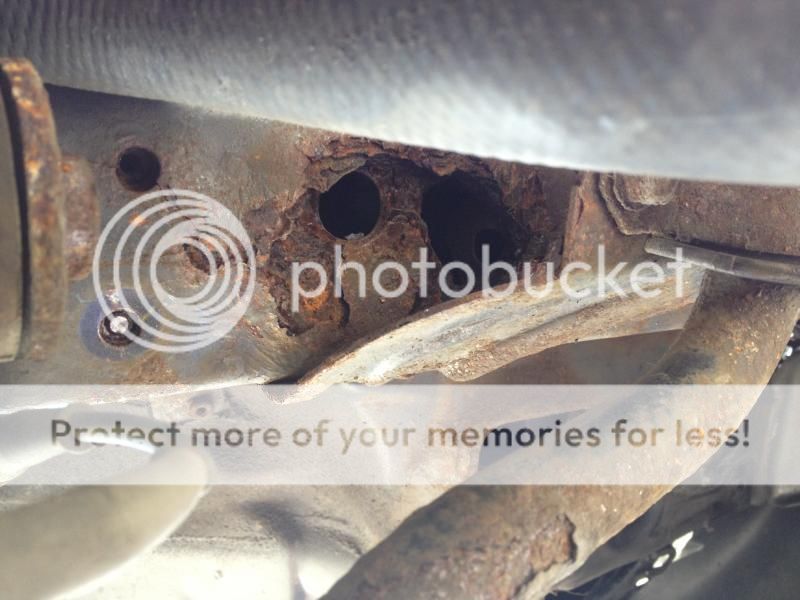

This extreme example had received no MOT advisories
This 2002 car was reported on this forum by an owner:
Mk1s do not suffer rusting in this area, to this extent. Owners in the US have the same issues; some who have looked at the problem more closely, report that on the later cars, these front chassis rails are made up of interleaving thin folded sheets of steel, seperated by a “tar like” substance, suggesting that the problem is a problem in design, affecting a structural area. The rusting proceeds from the inside out, so that by the time owners are aware, the area is already seriously compromised.

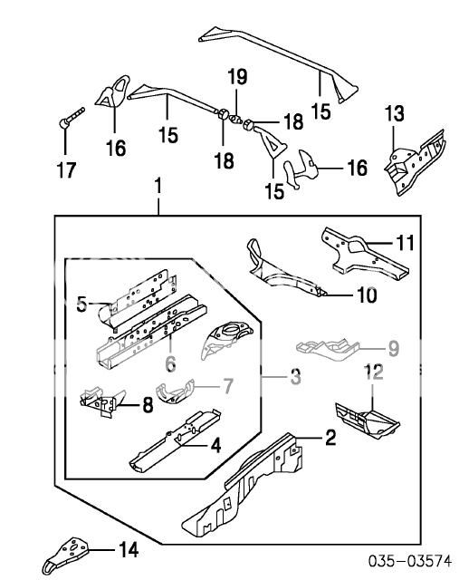

The repairs done in the US have used new chassis rails that Mazda supplies as part of the front damage collision kit. The rusting is at the forward part of the rail, the whole section can be replaced using the same procedures Mazda has developed for collision repair. These are the parts needed.

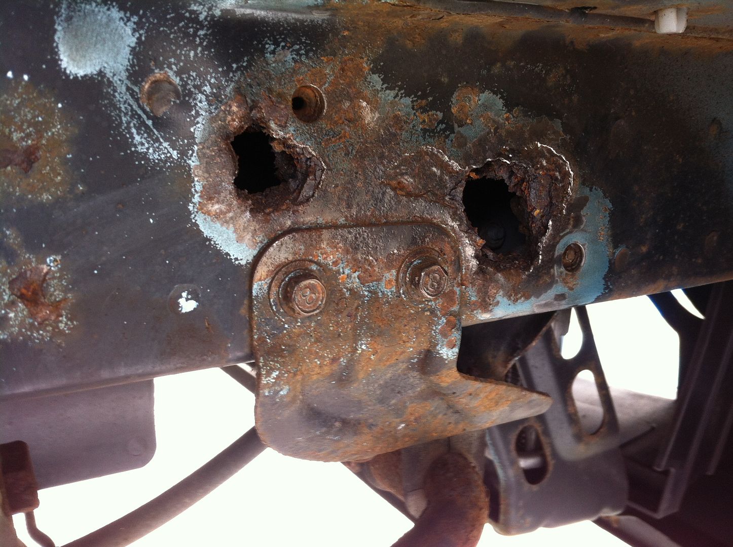

This was the kind of rusting seen on these 10 year old pickups:
Damage exceeding 10mm qualified the owner to a $10,000 replacement of the full chassis (frame). A 10 year old Tacoma has a book value of $8,000. In fact there were complaints that Toyota refused to buy back some of the affected cars (some owners go $12k compensation, others were forced to accept a $10k frame replacement).
