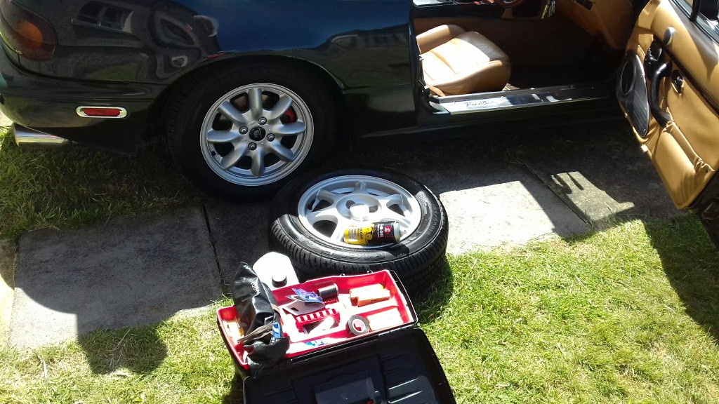

I had to do something drastic and had old OEM PanaSports repainted.
I have 4 mint 7 spokers in silver which I was going to sell but the issue is if…I bend PanaSport it’s curtains for the set as getting them / one now is a Holy Grail, so I need to retain them as an insurance just to keep the car mobile.
