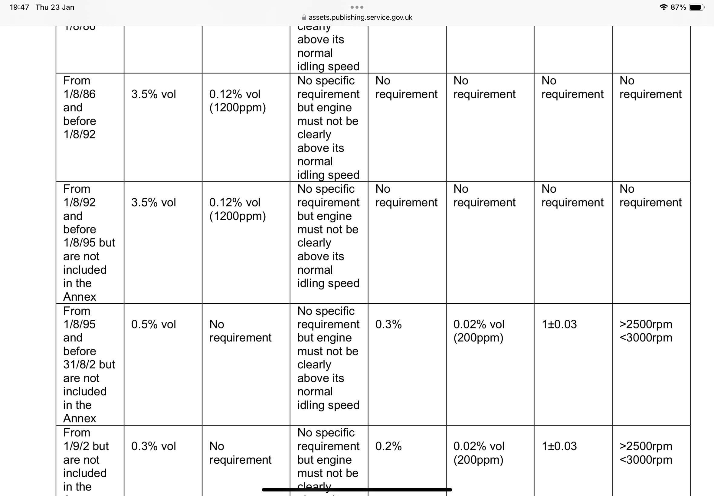

If this is for the purpose of determining the emissions test for the mot, then Eunos vins are not listed in the annex. So need to be tested at the non cat test levels.

Your car seems to have been manufactured September 1992 according to Search Result - CAR VX so needs to be tested at natural idle speed only. 3.5% CO and 0.12% HC (1200ppm)

Thanks for another reply that helps it seems like the MOT test centres seem to differ in what test is the correct one , I was not aware of the carvx car report web site thanks also for pointing it out it is spot on with dates and ties in with the car import paper work, many thanks for your help , John
