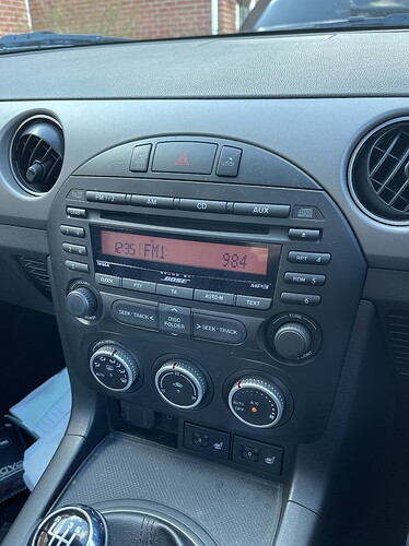

  3. I’m looking for technical help or recommendations on: Bose head unit, volume and tune knobs functions are swapped after a battery change. Does anyone know how to fix this, I assume it has changed based on a button I pressed on power on or something. Picture below so you can see exactly which version of the Bose unit it is, car is RHD, not sure if the knobs are swapped on LHD models… but any help appreciated

Mine is the same model Bose and have never had this problem, even on a battery change.

There is an onboard diagnostic that covers various aspects of the audio system.
It is however somewhat convoluted to initiate. What you need is the 2009 -14 workshop
manual or the next year version of this :~
STARTING PROCEDURE FOR ON-BOARD DIAGNOSTIC TEST MODE [AUDIO]
Thanks, I’ll see if I can find it, but looks like diagnostics rather than being able to change the setting, if I find something I’ll report back

This video shows the volume and tune buttons to be the same in a LHD car as yours.
If there is a factory reset function you could try that, otherwise disconnecting the battery again might return the correct operation.
Thanks, that makes it even more strange then!
I have tried both those, might leave it disconnected longer and see if that works
