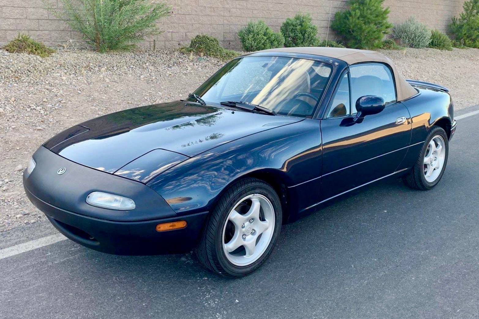

Besides the UK, the same wheel was a fitment in other European market MX5s, as well as the runout US Miata STO (“Still the One”) and 1996 M-Edition Miata

The alternative is something aftermarket that sort of looks the same. Or better, the Enkei fitted to several NB models; the offset is 40mm, and these are a Mazda part
